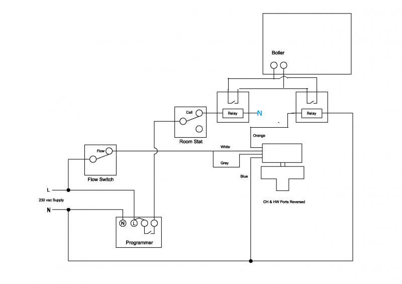

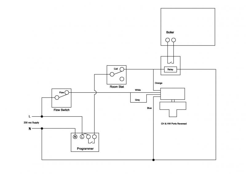

Boiler is 28kw
Stem - almost there! Heating circuit ok. When hot water demanded, all switches over ok.
However, it is then held in that state when hot tap is closed. It holds +ve condition on Orange, white and grey
Boiler is 28kw
Because The room stat is back feeding the valve via the orange
(try turning the stat down when the valve is stuck and it should return)
as asked earlier what is the make/model of the boiler as there may be better wiring options for you
otherwise you may have to get another relay
Matt
Matt you are spot on. Turn room stat down and it resets.
Boiler is Trianco Optimax 28 SB

If your boiler uses volt free switching you will need to either wire it something like this using a second relay
View media item 56293
(if your programmer has voltfree contacts then with some wiring changes you can get away with using one relay)
If your boiler uses a 230v switched live then you can also get away with using only the one relay
That was why I used the changeover switch on the first diagram. The second drawing was a bit rushed and I missed it. :roll:
However, thinking about it again. In the first diagram, I thought that when the flow switch was operated by water flowing, it would disconnect the motorised valve, release the internal contact and prevent a live being fed back through it. However, it may be too quick when it changes over to allow the valve to release the microswitch. So it looks like you will need another relay.
The first diagram is fine (the one that shows the flow switch as a changeover) and works as you describe
Think about the zone valve actuator as another relay t will be clearer
The flaw in the second one I think we all missed at first to be honest but I was a bit rushed too :wink:

Have 2nd relay now. Going to need to put back the ports to original positions to implement Matt's diagram. I have the valve mounted vertically, does it matter which way up it goes? Installation manual shows port A (heating) at top. I'm thinking it shouldn't matter but thought I read somewhere it had to be this way up, just can't find it now
No you dont need to turn the valve around, the drawing I posted just adds a relay to what you have already done
Before
After
Matt
You are right once again...I'm going mad.
Will implement this now but think I would like to swap them back again at some point

Ok use this one to use the valve the other way (open to hotwater when unpowered) you will need to utilise another contact in the Flow switch operated relay to disable the CH when HW is called for, the contact arrangement will need to be NORMALLY CLOSED
View media item 56361
the Valve can be mounted in any orientation apart from upside down (it would work upside down but would be a plain stupid thing to do)
Matt

Well have left it in "ports reversed" at moment and implemented wiring as per diagram and as expected, all looking good.
Think I will put ports back though as there was a noticeable delay in moving the valve when HW demanded.
