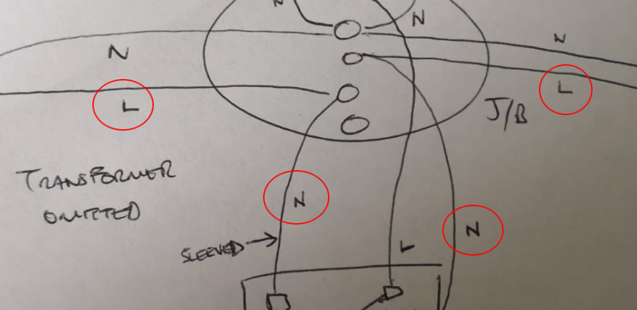

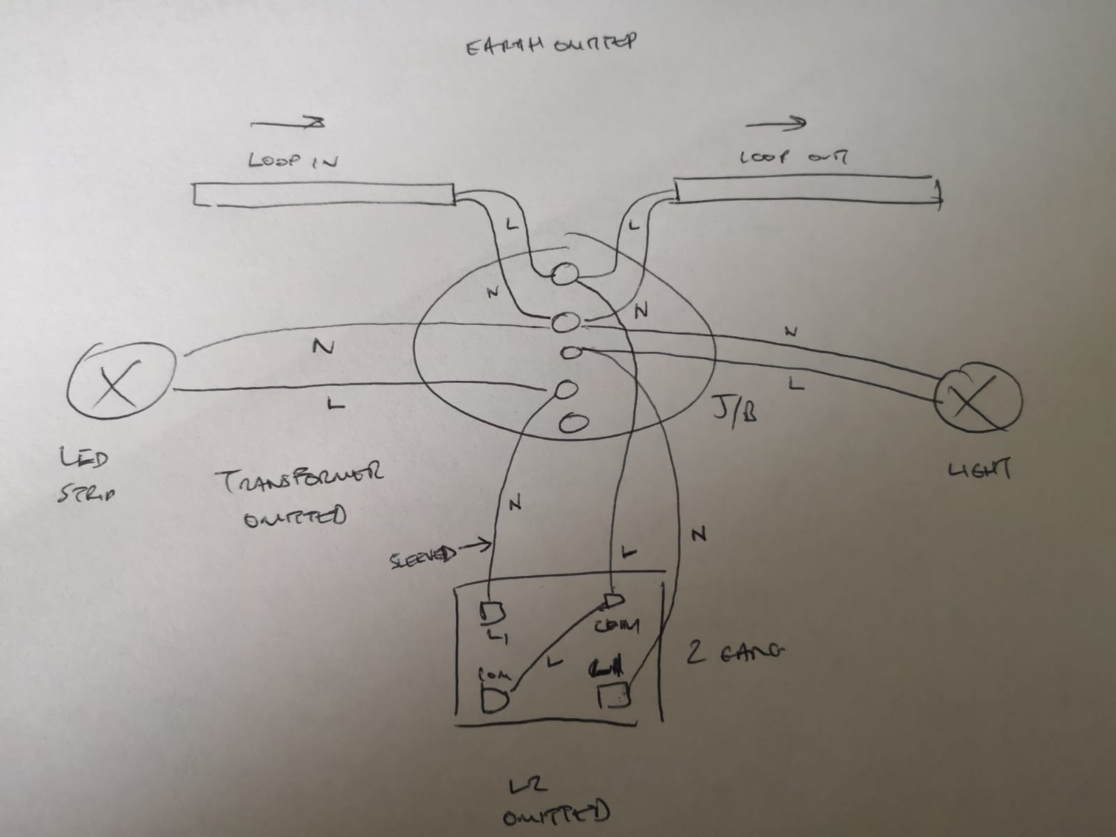

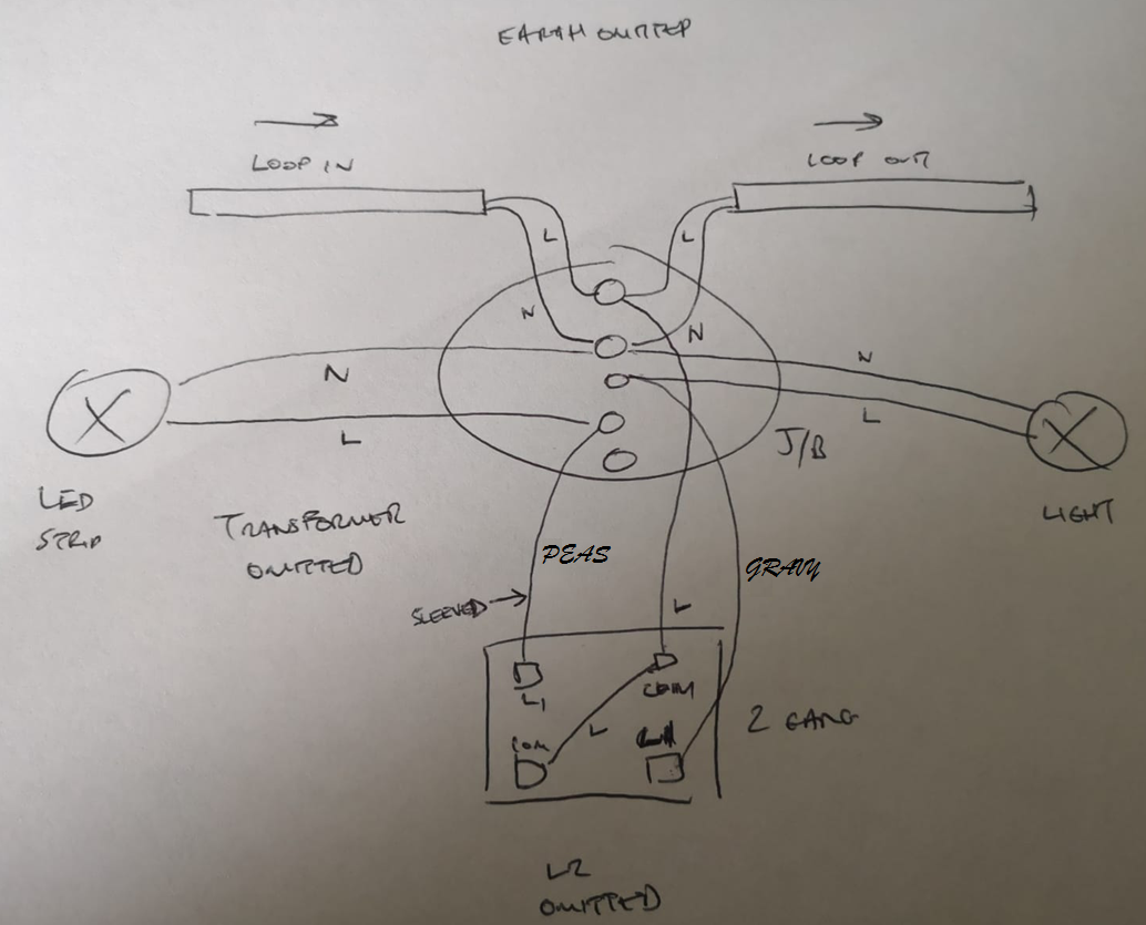

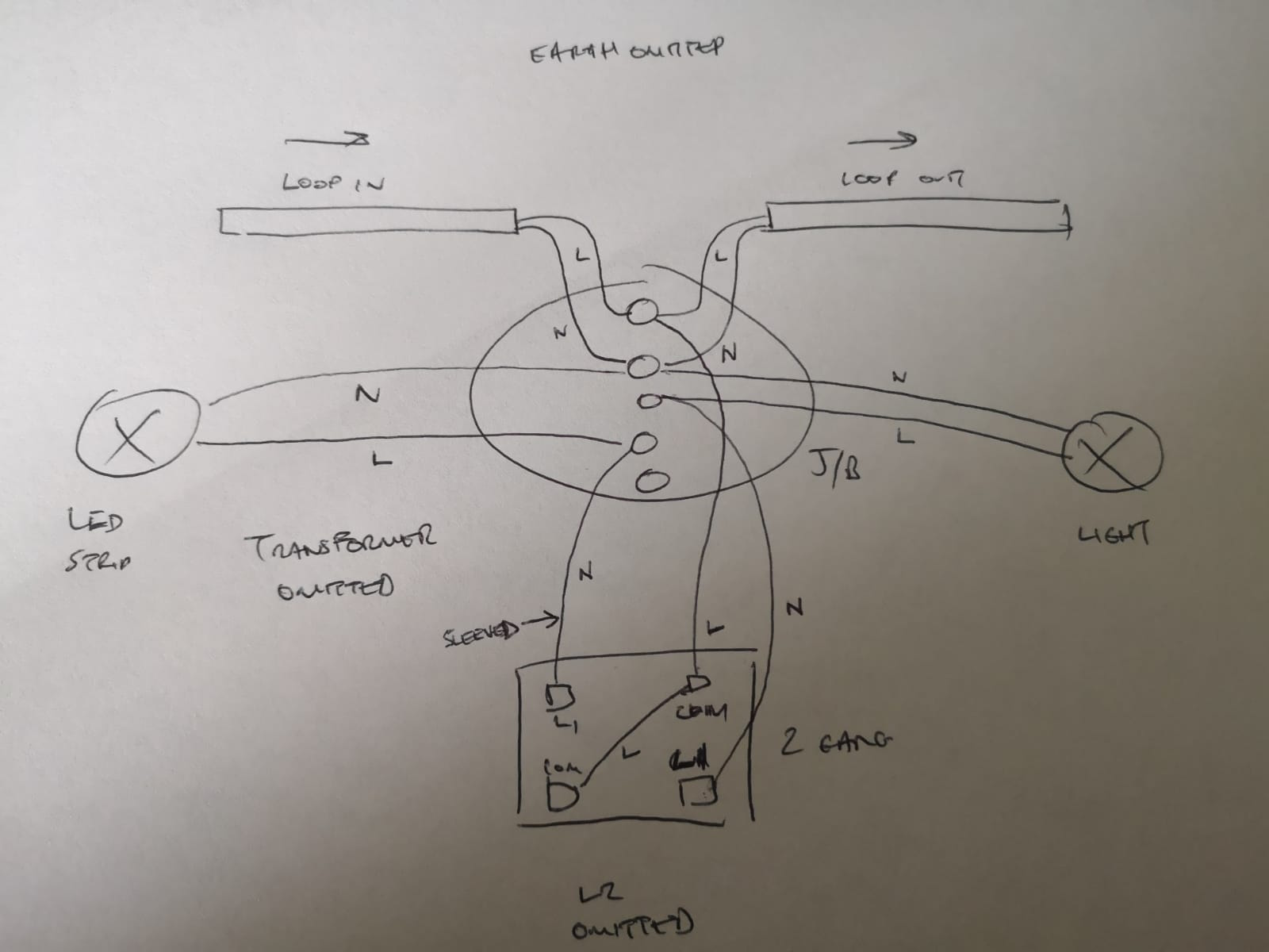

Heres a very quick and dirty drawing!

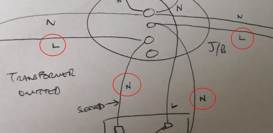

The thing is, it is clear from your diagram that those wires can't be neutral, and N does not stand for blue, or black.
You could have labelled the wires in your diagram anything you like -
and it would still have worked when connected as drawn.
But events verging on catastrophic can occur if you assume that blue/black wires are all neutrals, so calling them that is a Bad Idea.
