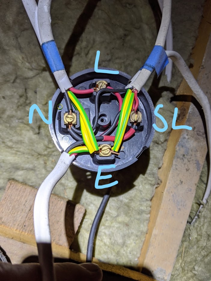

Am I right in thinking what I need to do is run a 3-core (or 2?) wire from that junction box on the left to the Nest Protect? That junction box runs to two ceiling lights and it's between that where I would like the Nest Protect so it seems the most obvious point.
If that junction box contains permanent L, then a 3 core cable L,N,E from that to the device.
If it only has switched L inside, then of no use.
The junction box also needs to be securely fixed to something such as that wooden beam to the right of it, and the cables secured where they enter, rather than being left loose as it is now.
As it already has 5 cables connected, adding a 6th may not be easy or possible, replacing it with a larger box may be necessary.

Here's what's inside that junction box. The two with the blue tape feed the two upstairs lights. I assume my notes are correct and I can safetly connect the smoke alarm to L and N? Will get a new junction box as well.
The labelling is spot on. Wire up to your L, N & E.
You can do a Screwfix click & collect for what you need. Make sure you get enough Wagos for the box and with the right number of ways. Get yourself a pack of 1.5mm cable clips too they're not expensive.
or use the existing junction box, which is easier
Yeah I think I will do that just so I can get it done today but when I can get to Screwfix I could definitely do with getting something a bit bigger and sorting out all the cabling so it's neat.
