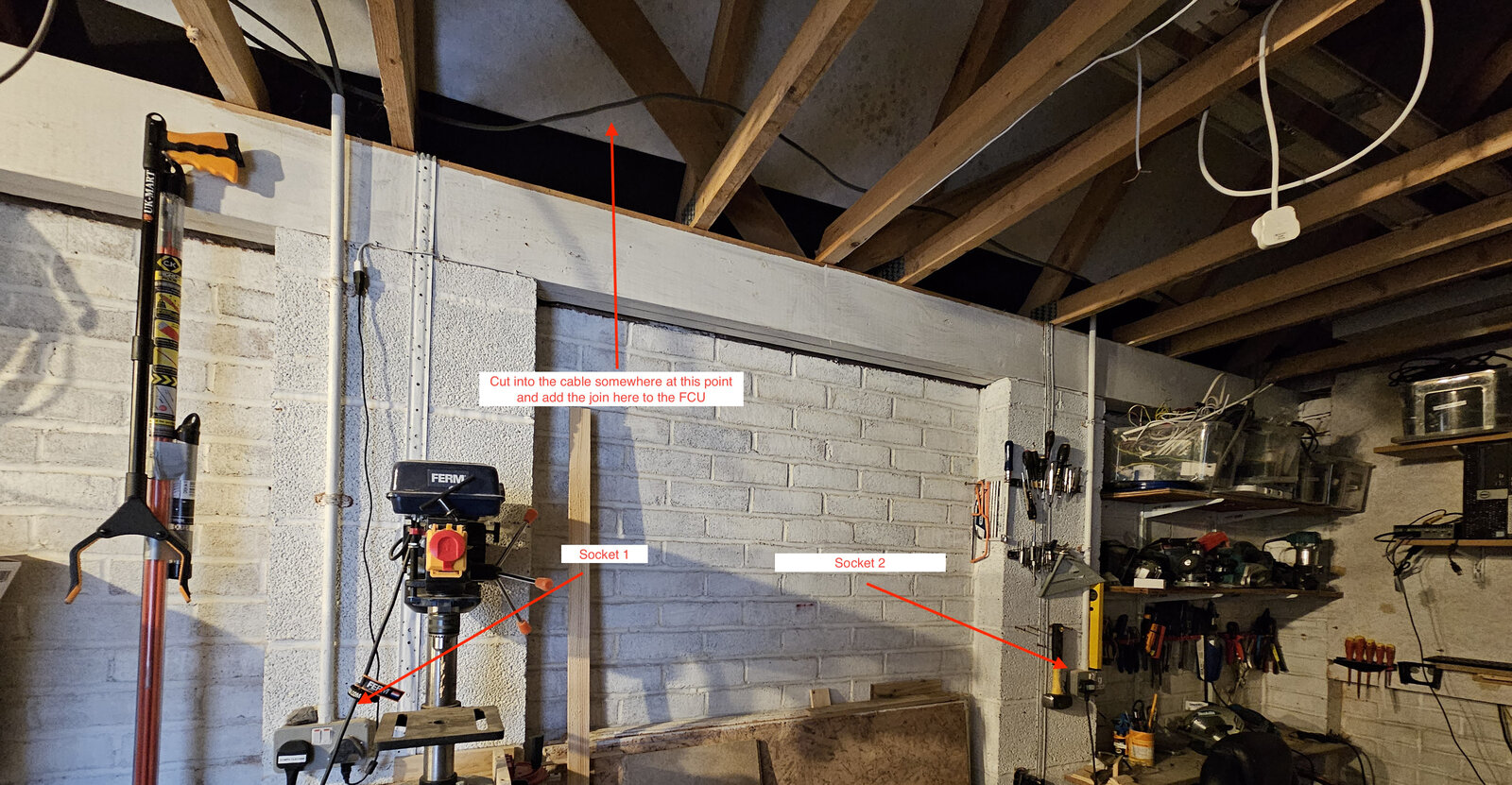

We've finally moved into our new house last week, and I need a bit of advice please on the installation of a NEST Protect smoke/CO2 alarm in my garage.
I have 2 incoming power circuits into my rather long garage:
1. One for lights at the front of the garage, taken from the 1st floor circuit using 2-plate method (Power at the switch);
2. The other circuit directly coming from the CU that powers the garage sockets and is then split off mid-way into an FCU for lights at the back the garage. The FCU acts like a light switch.
I need to install the NEST somewhere in the middle.
I can cut into the 2.5mm cable between sockets and take a junction from there which will use a lot less cable, or I can take a feed from the switch but will use more cable.
Would one be better than the other?
If I took a permanent live and neutral from the 2.5mm power cable and used a 1.5mm cable for the NEST, would I need to use an FCU?
Thank you.

Presume you mean CO but why? Is the boiler in the garage?
No.
1mm² will be hugely oversized; no need for another 50%.
A switch will be handy so may as well.

So my plan of action is this:
Between two of the sockets, I'll safely cut into the 2.5mm² cable. I'll attach both legs of the cable into Wago 3-terminal blocks and add a 3rd cable for the new FCU. I'll take the load for the NEST using 1mm² cable from the FCU, and hopefully that'll be that...
Now, the NEST is double-insulated, so there's no available terminal on the NEST for a CPC, so I'm a bit stumped as to what to do. There'll obviously be a connection for the CPC within the FCU, so am I best to just attached a Wago to the other end to safely terminate it? From the short length between the FCU and the NEST, I guess I could attempt to pull out the bare CPC conductor, would this be advisable?
Once all connections are teminated correctly, I'll add the Wago joins into a Wago box and zip-tie it all up to be maintenance free.
Please let me know if I'm incorrect, or have overlooked anything.
Many thanks.
I've taken a pic (please excuse the mess) and added some crude arrows and text boxes to explain where the two sockets are and where I intend to make the cut for the new junction.
Thinking about it, instead of cutting where I originally intended to cut, can I take a feed from Socket 1 directly into a new FCU? If I'm not mistaken, this would be classed a spur off of Socket 1 - correct?
Yes, that is what I had in mind.
As it turns out the socket is not nearer than the junction box would be but that doesn't matter; it is better not to have JBs if they can be avoided.
Awesome, thanks for your help; I'll get everything I need and make a start on it this weekend.
