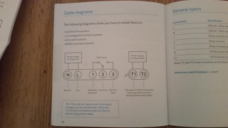

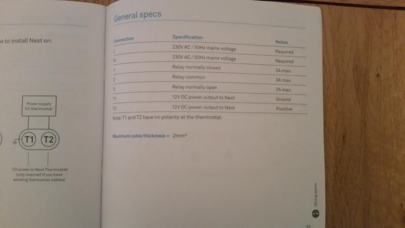

I was wondering if someone could possibly help out with the wiring of my new nest Thermostat
I currently have a standard set up with a Promax Combi Boiler with its own timing clock etc built into the front, which connects to a budget thermostat.
http://www.potterton.co.uk/docs/Potterton_Promax_Combi_HE_A_Installation_guide.pdf
This is my boiler guide / includes wiring diagrams.
The new NEST thermostat has a 'Heat Link' which needs to be connected to the boiler and a separate thermostat.
The thermostat looks straight forward, just would like some advice on how I wire the Heat Link if anyone can help.
Power Supply needs to come from a fuse spur, which I'm assuming will be ok to share the supply the boiler uses?
Its Connections 1 , 2 and 3 i'm not sure how to deal with / connecting with the boiler.
Hope someone can help
Thank you
Ben
