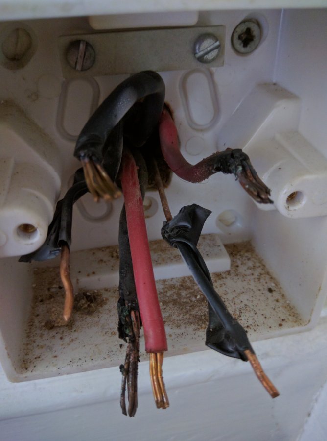

My power shower has stopped working. The main switch is stuck and was very hot and smelt. I've opened it up and the wire ends have melted. I don't know if I can trim the wires back and replace the switch or if I need a electrician to change the wiring. I've included a picture.

you should get a spark to check it out,it was a bodged job not done by pro. CPC is not even sheathed. is it an electric shower ,cold water feed only or is it actually a power shower that would have hot and cold feeds. big difference ,

I agree, get an electrician to check it out, and to check the wiring to the shower itself - if the quality of the switch wiring is anything to go by.
Its a typical plumber or DIYer installation (sorry plumbers!)
Also have your electrician check that you have an RCD on the shower circuit and that it is operating to specification.
if so it looks like the cable size is way too small ...edit ..may be too small.

How can you say that? You do not know the value of the MCB/fuse in the consumer unit. You do not know the power rating of the shower.
It's stranded cable so likely 6mm² or perhaps 4mm². So where's the problem if the CPD is 32amps?

hi Taylor ,as you see I did edit to state MAY be too small ,as in not able to carry the load .regards terry
Can you tell if there is any slack in the cables? By the time they have been cut back far enough you might find that it's not possible to connect a switch if they can be pulled through a bit.

And hopefully tell us whether the cable appears to be 4mm² or 6mm²: https://www.diynot.com/wiki/Electrics:flatpvccables
Looks like 6mm, also looks like its been made off by a badger, causing the issue!
Generally, if you use a semi decent isolator and make a decnet job of terminating it, then you'll never get problems. That switch has just been connected and forced back and it looks like theres unsheathed cores going to be showing above as well
