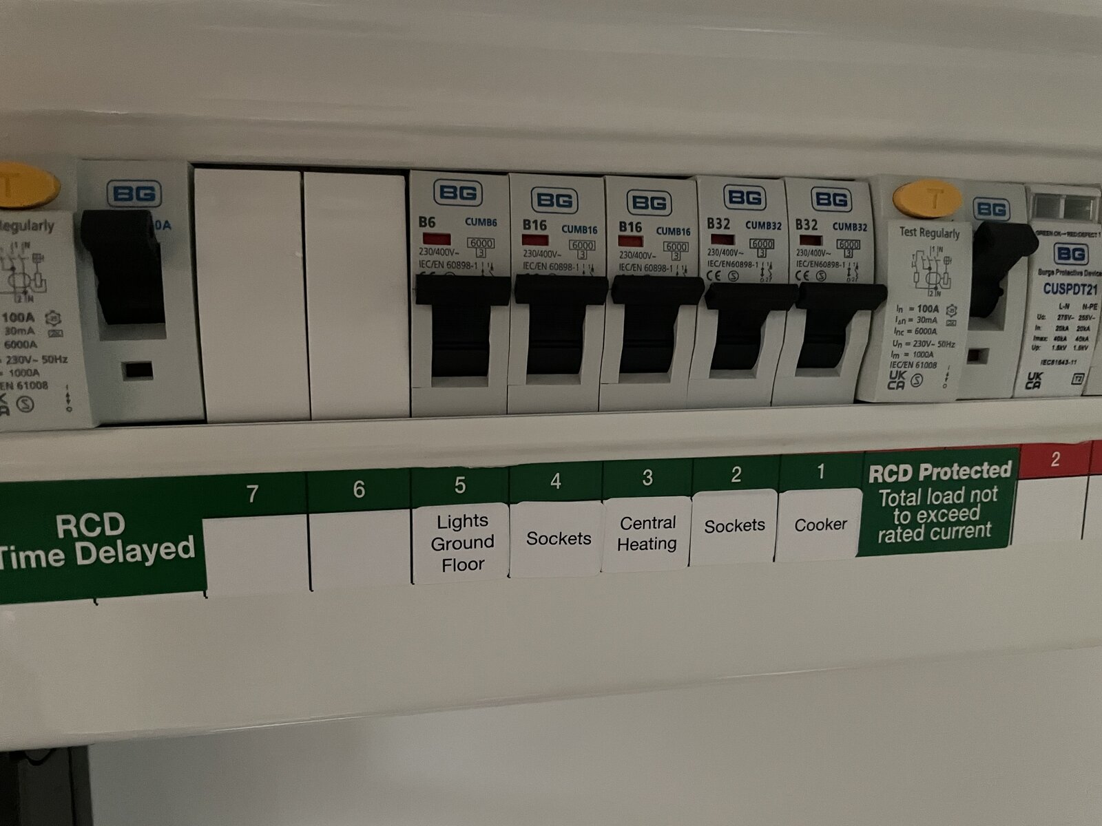

I have bought an MK outdoor socket
I am wiring it to a 13amp socket
Ideally I would chase the wall and run a cable to it
But that’s a lot of work. Is there any reason I couldn’t run a (suitable) flex to the socket and fix a 13amp plug thus avoiding the need to chase the wall please?

That's an option. One thing with adding sockets, regulations state that they must be RCD-protected
generally this means that:
either the new socket is an RCD socket in its own right or
the source socket circuit is already RCD-protected (usually in the consumer unit)

Of course it is on a “breaker”. All circuits will be on a BREAKER. That limits the current.
But, you need an RCD. That limits the maximum amount of earth leakage current, and saves your life if your hedge cutter chops through the supply flex.
Post a photo of your consumer unit if you aren’t sure.

Sorry poor terminology from me, I agree. It is an RCD but I’ve attached a photo anyway

And how would the cable get to the socket you intend to plug it into? would you drill a hole in the worktop and thread it through? (naff) better to do it neatly in the first place then it wont bug you for years to come..... have you checked behind the units below the intended source socket the cables may be surface mounted and then you could spur off with a junction box
The socket is below the worktop and inside a unit - spare appliance socket. My original plan was exactly that, spur off the socket and chase the cable down the wall. But, the cable will never be seen and so really the only difference is that there will be a surface cable with plug, rather than a smarter install no-one will ever see. Additionally it means the outside socket can be disconnected if I ever wanted to, I suppose.
Replace the socket with an FCU, or just a 20A switch, run a cable from the load side surface mounted (or even floating) till you get to the hole to the outside.
