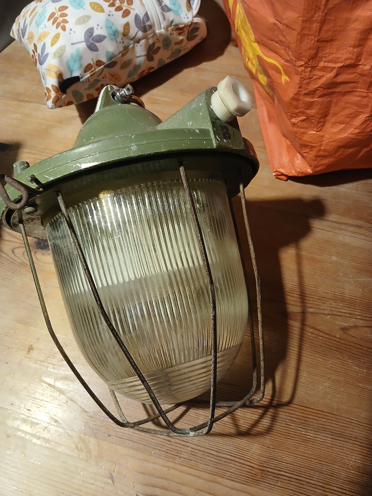

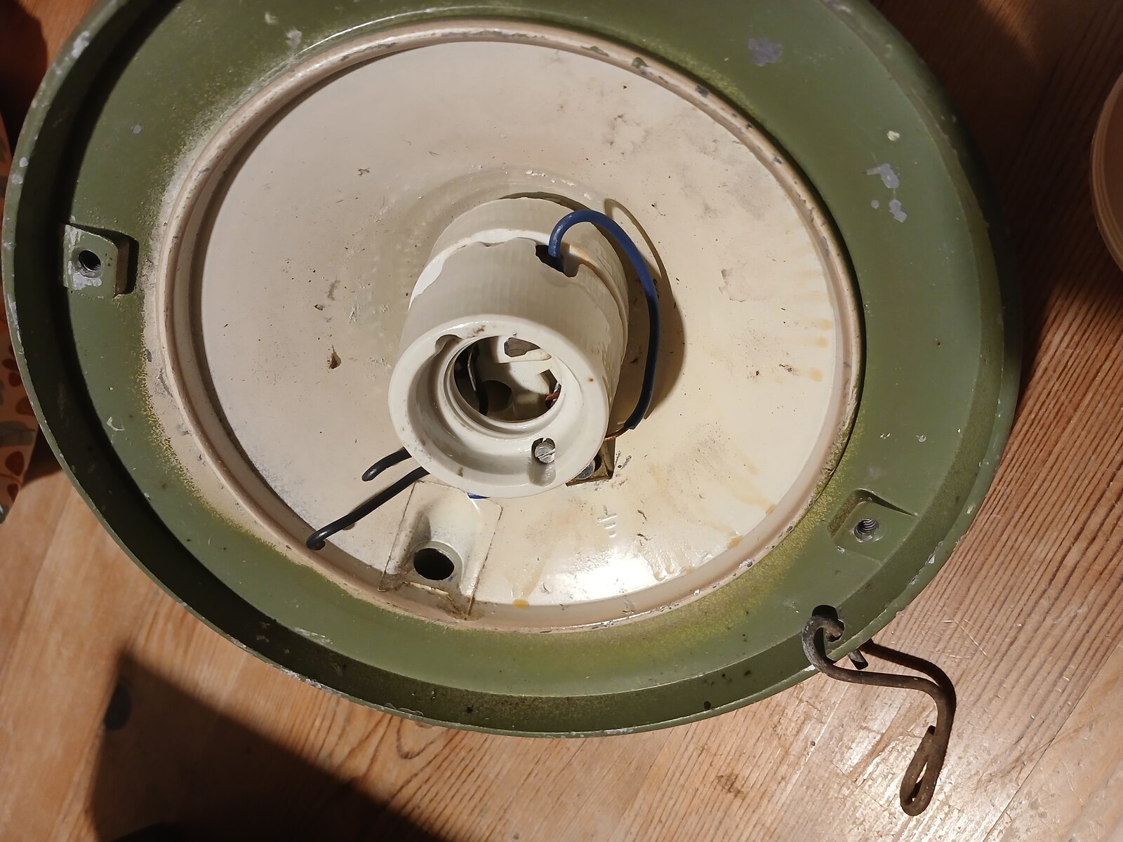

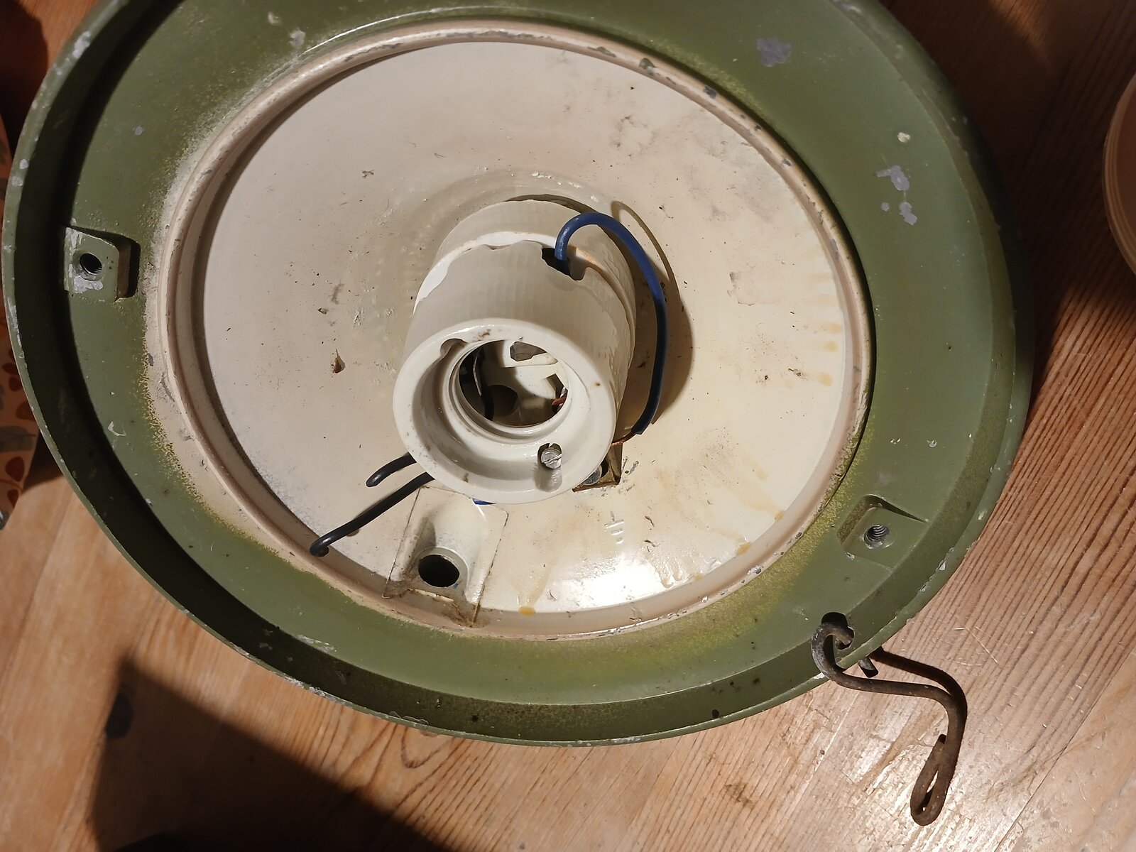

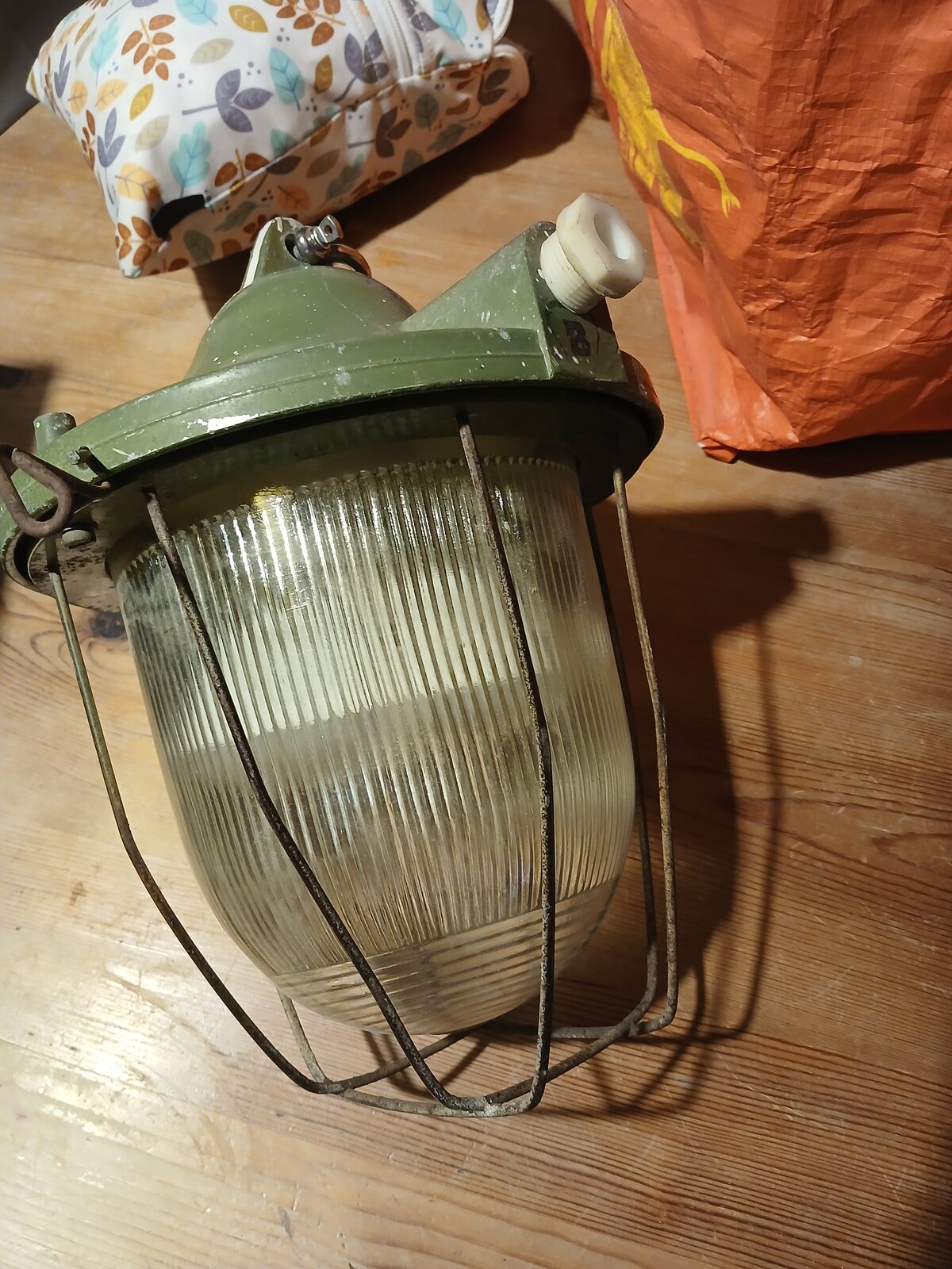

Oh yeah -- I can use shims or washers when closing it up to ensure there's a gap so air can circulate.
My experience, suggests even that would not be enough. LED's work coolest base down. I recently had two out of three LED's fail, afer just 12months use, in wall lights, base up, with shades open at the bottom. Heat rises, then had no way for the warm air to escape. Realising what caused their failure, I've since inverted the fittings.
I had a 6w LED fail, base up, in an outdoor lantern style fitting twice after two years each. The fitting was several times the air volume of your fitting. I then modified the fitting, drilling air holes in the top and base, since when it has survived well. The light is on, from dusk, until 11pm each day.
