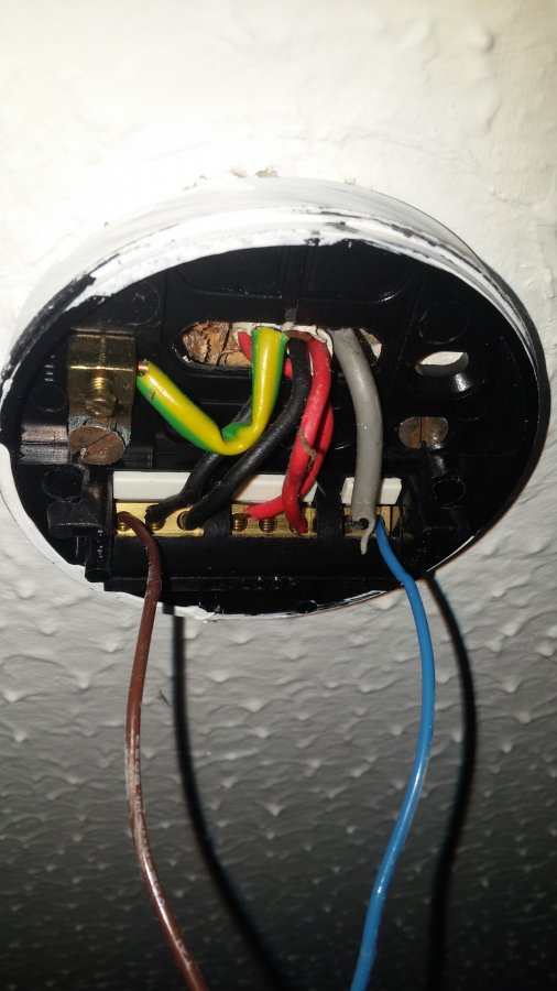

Hi all
In my hall i have 2 roses for 2 pendant lights. Im changing them to spotlights and want to add 1 more. Im pretty confident but just want confirmation im doing it right. Im using wago clips and junction boxes. The pic attached is the second light can someone advise on wiring to a new light.
Thanks for the quick reply.i am ok with the instructions you attached my question was how to connect an extra light after doing what you have illustrated?
And the diagram clearly shows you what you connect your new cabling to!
Also check which way the blue and brown flex is connected to the pendent as looks the wrong way round on the ceiling rose
Sorry so are you saying i need to only wire the L and N to the next light which is around a meter away? So ill have4 wires joined on negative 2 wires on the loop snd 3 wires to live? Plus the earths
There are no negatives there - you have line and neutral.
The diagrams in the Wiki show clearly how it all works.
Thanks for the replies. The problems with writing sometimes i don't explain properly. I was trying to say did i need to wire up a new 'supply' but from the diagram i can see i just need to extend from the L and N from the rose in my pic to the new light. Thanks
