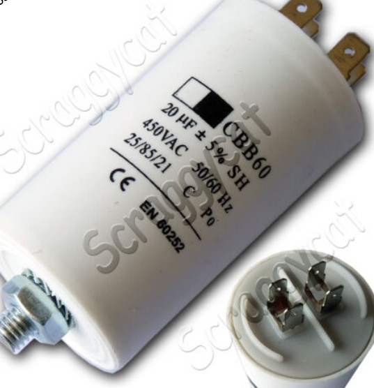

What ho one and all,
I have an old electric wood chipper that mostly does not run but sometimes does. It is a Champion 2000W and has been challenging to dismantle.
Having gotten it in bits, I see that it needs a new starting capacitor. I know nothing about caps but what is written on the side is 20uF +- 5% / 450v-DB HPFUP / 450v-DB HPFNT / 25/85
What I have found on eBay is as the photo. Would this do the job?
Thanks, toodle pip and stay safe
Rex

Don't buy from electronic components from ebay unless you know the source is quality. Try CPC Farnell, Rapid, RS or 10's of other legitimate dealers. There are legit components traders on ebay - check out the registered business address.
Nozzle
Thanks for your reply. Are you implying that even a starter capacitor could be faulty? The replacement certainly came from eBay and it appears to be doing its job in as much as it starts the motor.
The problem is that the motor will not run in both directions. Or more specifically, it runs in one direction X times. Take a break and try in the other directions, and bingo, it suddenly runs in reverse. And then it is 'locked' in to reverse, even when changing the switch direction.
Can this be caused by the cap?
Everything is made in PRC, but only some things are made in PRC to the quality specifications of a firm which outsources. If it's not in this category, it's in the other category.... that is to say, it looks the same and might function the same when brand new. Then it goes bang and sets your house on fire.
The CE and EN marks mean diddly squat in the latter category, it's just another detail to add to the silkscreen printing and nothing more.
Nozzle
Nozzle is correct that bad capacitors can go bang and best to get from reputable suppliers.
But a good or bad capacitor will NOT change (or make a difference) to the direction of an AC motor.
