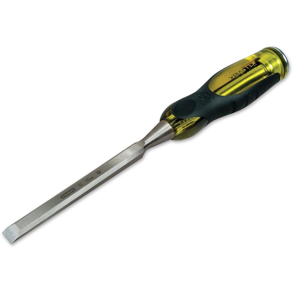

    FYI through-tang chisels with metal striking caps are specifically designed so that they can be struck with a hammer. They are the only type of general woodworking chisels I know of which are designed to withstand this type of abuse, although there are some solid steel chisels made for the timber framing trades (i.e. green oak) which are made to be struck with a club hammer if needs be
    AFAIK the Stanley Fat Max and Irwin MS750 designs are the only two chisels available on the UK which have this feature. It stands to reason, though, that any chisel with a wooden or all-plastic handle iusn't designed to be struck with a hammer - although many real world situations often result in just such abuse being necessary

    If you need to use a hammer on a wood chisel its blunt.

    Oh, really? On new softwoods, MDF or the average softwood-lipped flush door when making a paring cut you are, of course, quite right - when having to chop pockets into 150 year old pitch pine, or chop-out hardware recess in (new) solid oak, or even just defining the edges of a hinge or lock face plate recess (where you are of necessity severing cross grain fibres) you are just so wrong. Even chopping out a lock mortise in a chipboard core door cannot be done without either a hammer or a mallet to drive the chisel especially when working at the bottom of the cut - hitting the end of a chisel handle with the flat of the palm as some joiners do is asking for permanent and painful hand injury. Hence the use of driving tools - and the need (at least in site and fitting work) for a chisel which can be struck and driven with a hammer or mallet. I've even dug old registered chisels out of walls on refurbs which have been walled-up for 150 years or more - and they always seem to show signs of heavy use and of having been driven by a hammer (spelched timber fibres within the steel ferrule at the top of the handles)
