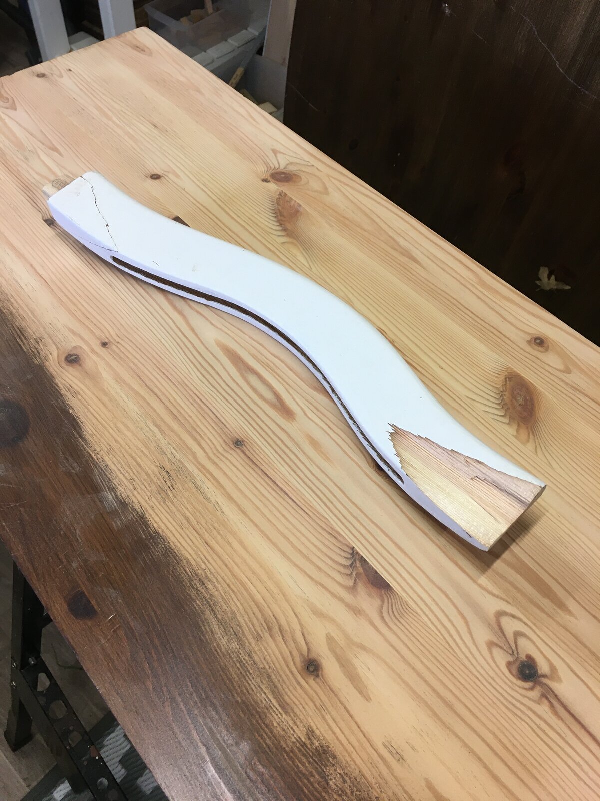

I don't have rotted timber, but I do have a chair back which has splintered and a piece, (roughly 2" x 3"), break off and gone missing.
Does anyone have recommendations for the replacement filler I could use? It's at the end of the timber and forms part of the socket for a domino piece.

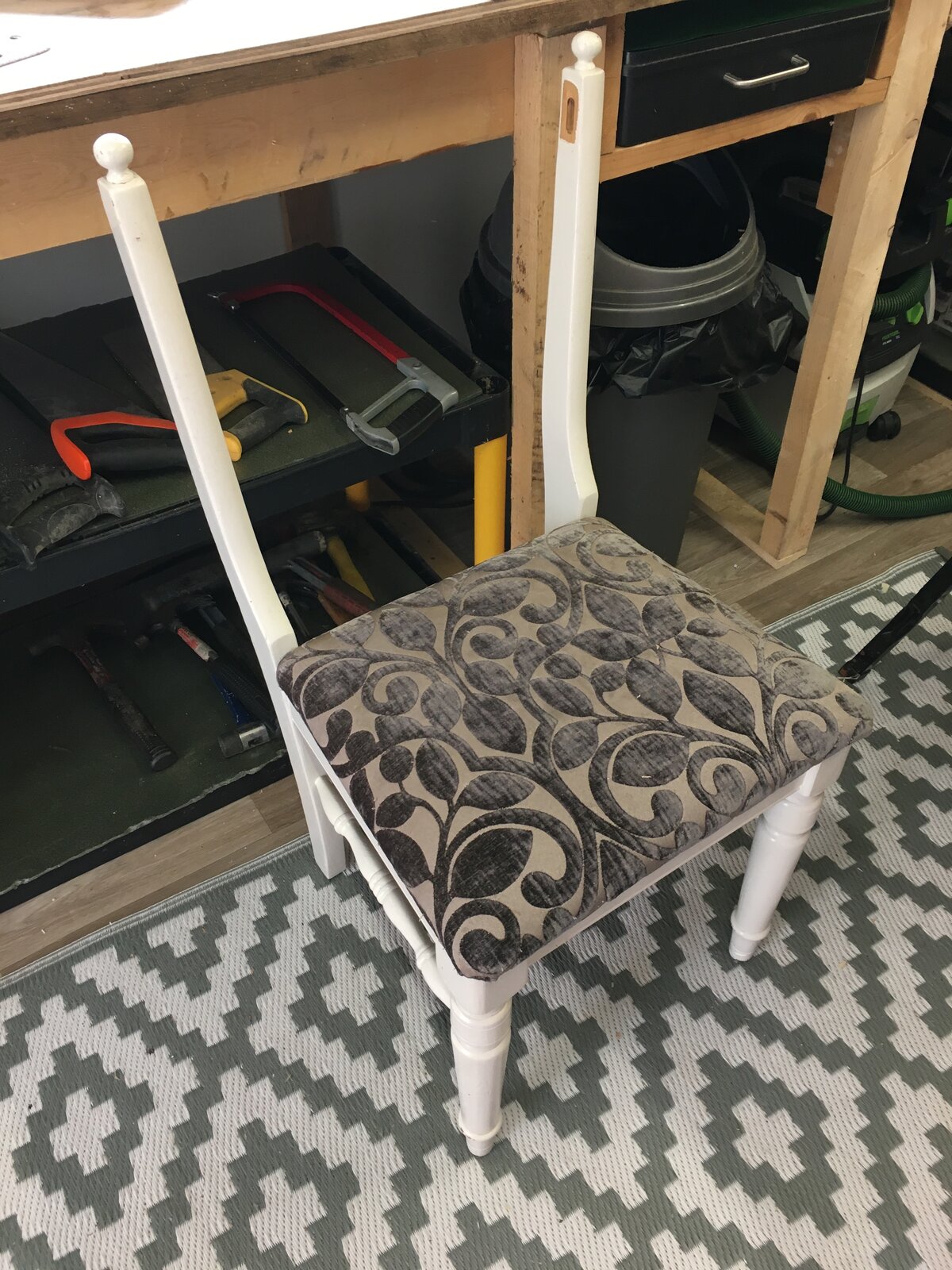

This is the chair and back rest. As well as the back rest curving up in the middle it is also bowed back slightly.
I don't think you can see the bow out from this picture, I'll try to get another shot tomorrow. If you look at the ends you can see they are slightly raised up from the table top, (being stripped back to bare wood).

The shape is simple enough to copy - plywood template, rough saw slightly oversize then template route (which you should be getting quite expert at by now (y) )
Getting the curve into the back is a bit more difficult - it is often done on a bandsaw then sanded out (steam bending or soaking it in water is not going to work on softwood)
An alternative might be to take the existing item plane the damaged ends flat, glue and cramp straight-grained oversize repair pieces on each end and once the glue has set "carve" them to the required shape (bandsaw, Surforms - thete is actually a vompass sole Surform, wood rasps, block plane, spokeshave, belt sander, etc). If these I reckon a flat sole spokeshave and a compass sole spokeshave might be the best tools fogr the roughing. The sockets at the ends can be chopped out by drilling then finishing with hand chisels

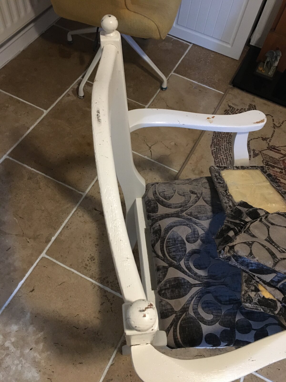

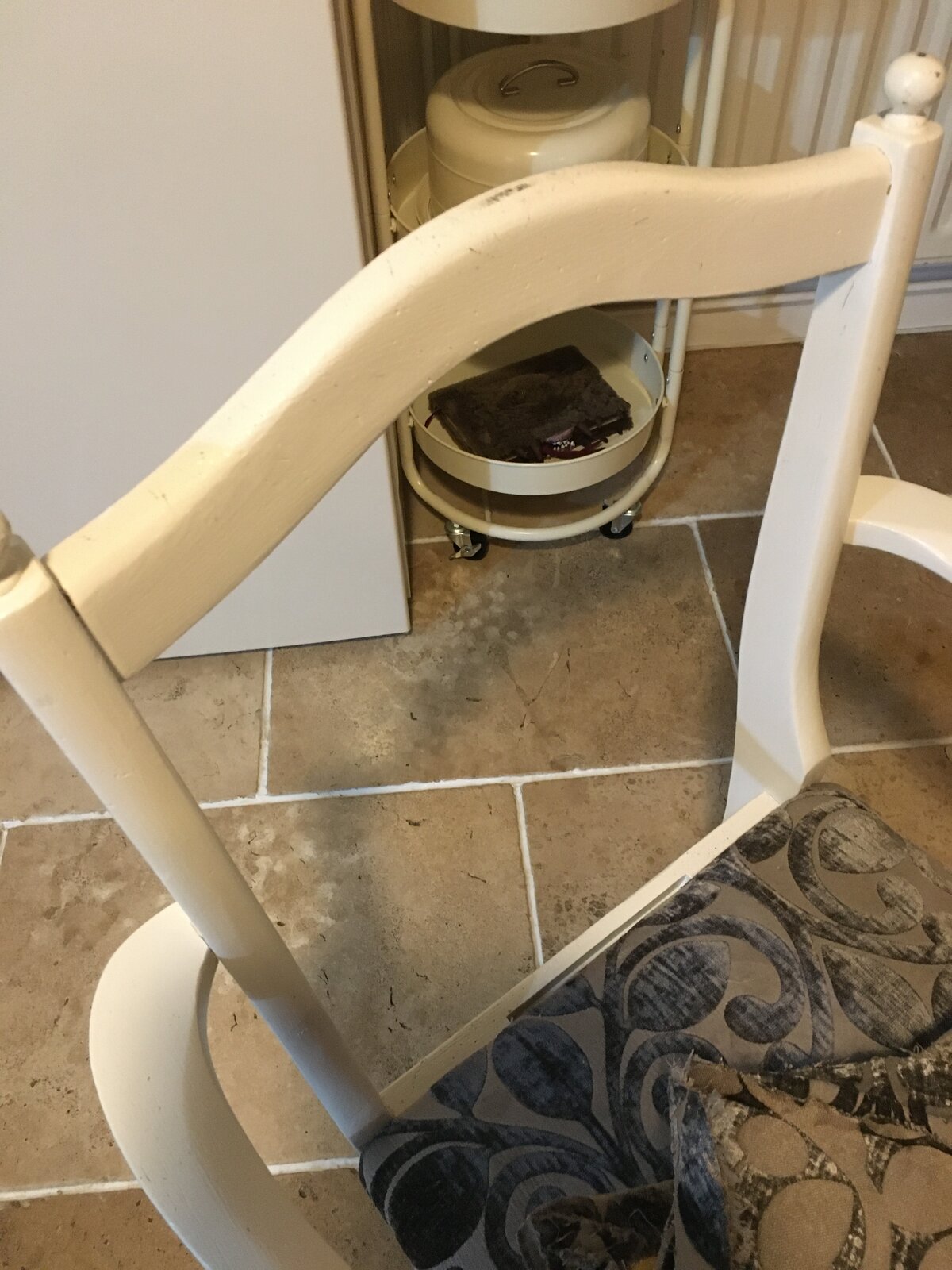

Here are two views of it in place on one of the carver chairs.
I've got a piece of R/S 3" x 3" and I've pencilled in the shape on two faces so I can see the top view on one and the face view on the other.
My initial plan is to bandsaw out the upper and lower curves, (ending up with a humpback bridge sort of shape), then bandsaw out the front/back curve. By doing it this way I should be able to sit the original on the hump and get a fairly accurate shape of the back curve. Then a case of roughing to near size with surforms, linishing belt sander etc and hand sanding. The end sockets, as you say, can be formed with drilling and chiselling out followed by some 'loose' tenons glued in place.
Yes, that's the best way - if you have a bandsaw. A couple of dobs of hot melt glue should hold it together when you are make the second pair of cuts. TBH you would be better off marking out the end flats, which will be at an angle to the front if the timber, and sawing them first, then chopping out the mortises (drilling and chiselling)
