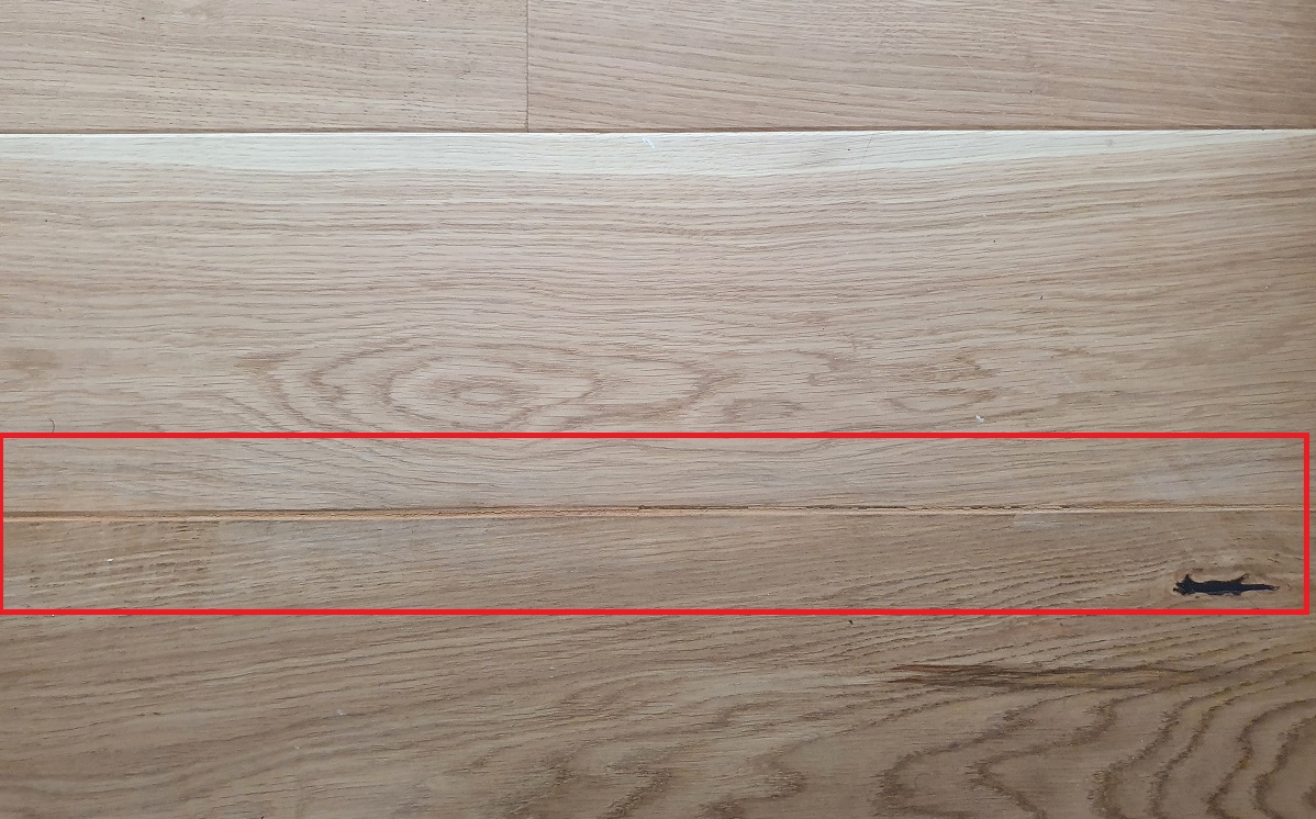

I put on engineered click floor, but the installer seems to me that he hasn't done a great job.

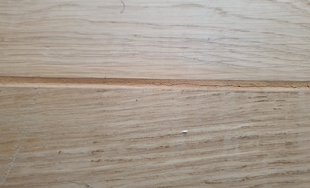

He said that because he had to start from one side of the flat and go all the way, this resulted in what you can see in the pictures below: he had to fit the rest of the click floor "from the back side", that's why I ended up with these 2 pieces under my doorsteps in two rooms.

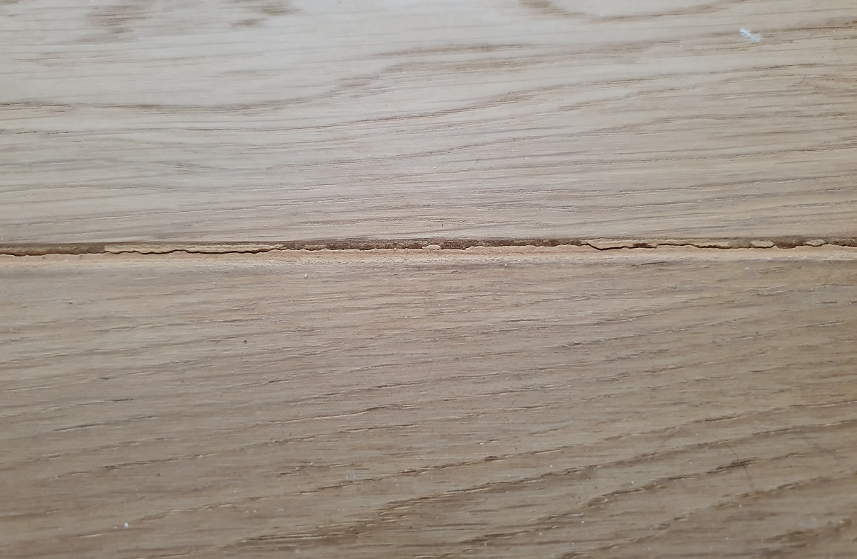

Before he left he put some wood putty and made it look even, but because of the springiness of the floor (floating floor because of acoustic underlay), this has started to break.
Any ideas on
a) whether this could have been avoided, i.e. it's just a bad job
b) how to rectify it

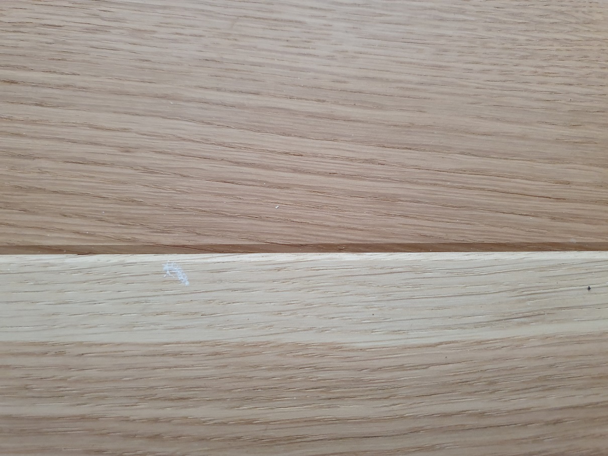

N.B. I've also attached a picture of a good join of the click floor for comparison.

Depends what he's done at those joins- if he couldn't get enough angle on the the floor to click it in then the joint may not be properly engaged & will always be weak. Unless you have some pics of while he was doing it, only way to see what's happening is to lift the floor.

It's just a gap that's not even. The wider end of the gap is about 0.5cm. And it is indeed a weak spot as the floor is ever so slightly elevated, and you can see it bending when someone walks on top of it.

So are you saying that the 'engineered click floor' has been laid direct onto the underlay? That will not help the durability of the joints - particularly where the adjoining sections are narrow.
Me thinks no matter what you do to alleviate the situation in that situation the best resolution is to have the floor up, lay something like 10mm ply on the acoustic underlay and then re-lay the engineered wood floor making sure that no edges of the ply are in line with the joins in the engineered wood floor.
No sorry, between the acoustic underlay and floor there's 6mm thickness plywood to avoid that springiness. This was as per the manufacturer's guidelines.
Still, at both doorsteps, the floor looks somehow a tad elevated, as if it expanded a little bit that causes that elevation, that then is springier than the rest of the floor.
