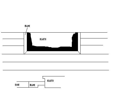

last questiong - would I be making problems for my self if I lay boards in a "frame" type layout around the hearth, ie single plank width with mitred corners.
the rest of the floor would be laid normally.
not sure how this would be effected by the expansion of the two planks at the short sides of the hearth that would be laid in the opposite direction to that of the remaining floor. If it makes a difference, I would probably cut these planks so that that are half the width.
Hopefully I explained this enough - I have seen it done before on an original timber floor around a hearth
As long as this frame is rebated underneath, so it can "snap off" if and when needed I don't think there is a problem

the "frame" would sit at the same level and be flush with the finished floor - i would still intend to use the oak strip you have suggested to allow for expansion around the hearth.
where would I rebate?
What I meant was, the side of the frame that buts against your fire place should be rebated underneath, so in the event the floor expands it breaks off without damaging your floor

is that so the "frame" element would break if the floor expanded? I have done a quick drawing to illustrate what I am thinking of doind - does my drawing of the frame being rebated show what you suggest?
if this is correct, would i still need the oak strip to hide an expansion gap round the hearth?
I would always opt for a true expansion gap around the hearth, but that's me talking as a professional.
Your rebated frame could work, as long as the "lip" is thin enough and there are no disasters in regards of excessive moist or humidity
from a professional point of view, would you even consider the "frame" type layout around the hearth or am i just leaving myself open to any number of issues?
