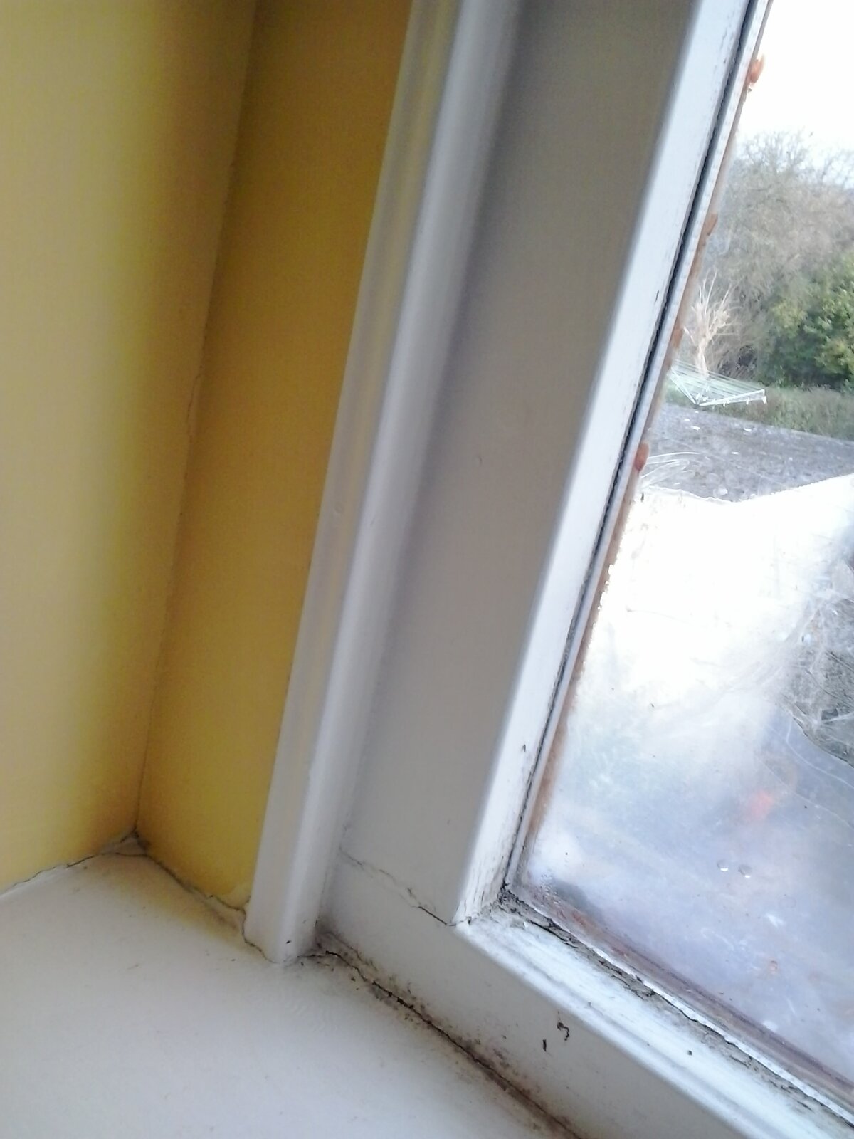

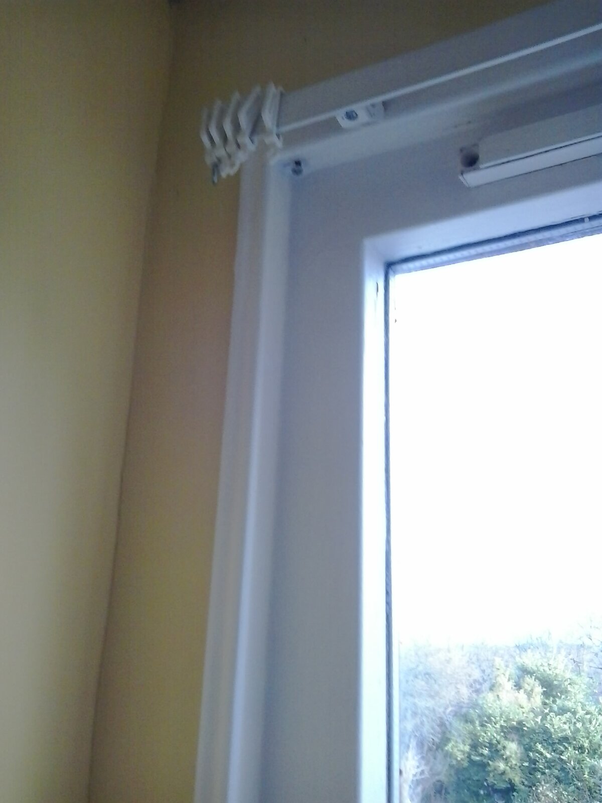

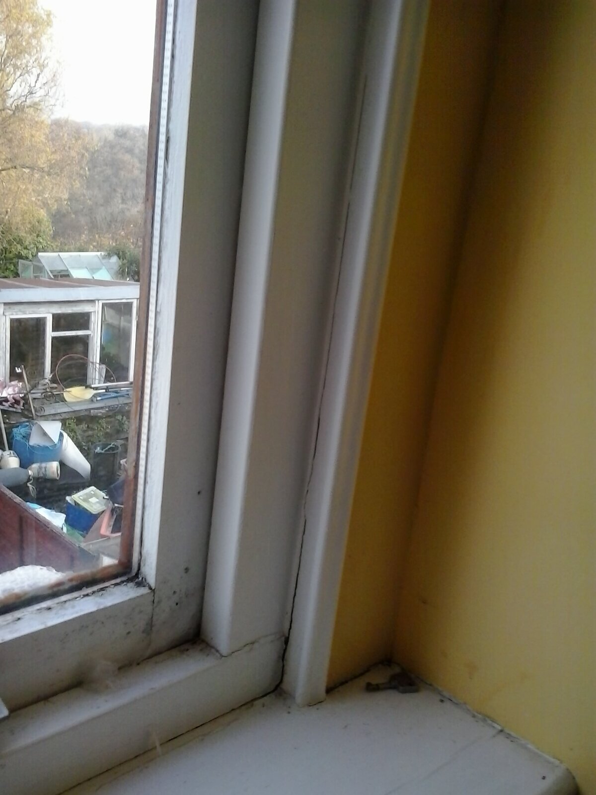

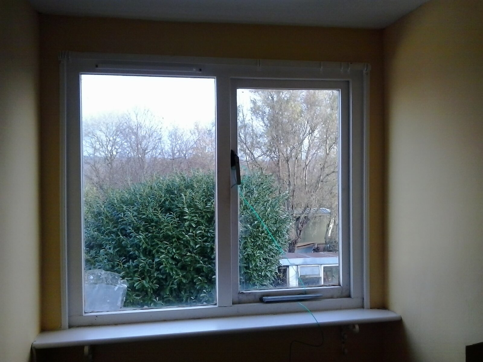

Good morning,
I have some rot in the wooden window frame of a dormer back bedroom. Unfortunately the rot has also spread into the dormer frame to some extent. I am having UPVC windows installed in a few weeks but want to be sure that all the rot is replaced with new wood. To that end I was hoping to remove the frame entirely into the bedroom. I have already removed the opening 1/2 window frame on RHS yesterday so that should cut the weight down somewhat. But can someone advise on best procedure to remove the actual frame without making a mess of it. Seems to be wooden thin white trim up against the plasterboard - is this likely to be nailed in? I am guessing after that I would need to remove the fixed in glass pane on the left hand side to expose the main fixing screws on the LHS, the fixing screws on the RHS will be exposed when the opening 1/2 window on LHS is again removed.
Some photos are attached to help explain.
Grateful for any advice offered.
-Thomas

I would just leave it to the window fitters.
They will remove the frame, the trim and if want the window board as well- that’s all the wood gone.
If you really want to do it your self, I can tell you how fitters would do it: they would remove the glass if its easy to get out by removing the glazing bead, if it’s not they would smash the glass, knock it all out of the frame, then use a recip saw and or multi tool to cut through the timber jambs, head and bottom then lever the parts inwards.
Window fitters would have that frame out in 15 minutes

What exactly do you mean by "window board"? As I understood it the wooden window frame buts up against the actual dormer wooden frame with some spacers separating each and gap filled by expanding foam.
Please do clarify further.

The window board is the timber ledge on the inside of the window
The sloping bit of timber outside is the window cill.
Ah ok, I hadn’t realised it was a dormer.
So the dormer structural opening would’ve been built and then the timber window made to be about 10mm smaller, so as you say it would’ve been put in with spacers - probably not foam as the window prob predates that, but the new one will be fitted that way.
