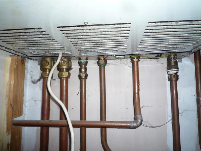

This is what I see when I look at the underside of the boiler:
On the wall behind the pipes is written in pencil (starting from left): Return Flow Cold Hot. There is nothing written behind the two rightmost pipes.
The three left-hand pipes, and the far right pipe, each have a screwdriver-type valve, and all were already set to On when I got there.

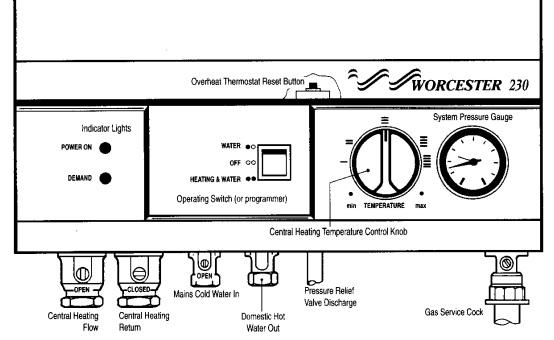

The Worcester user guide shows the following:

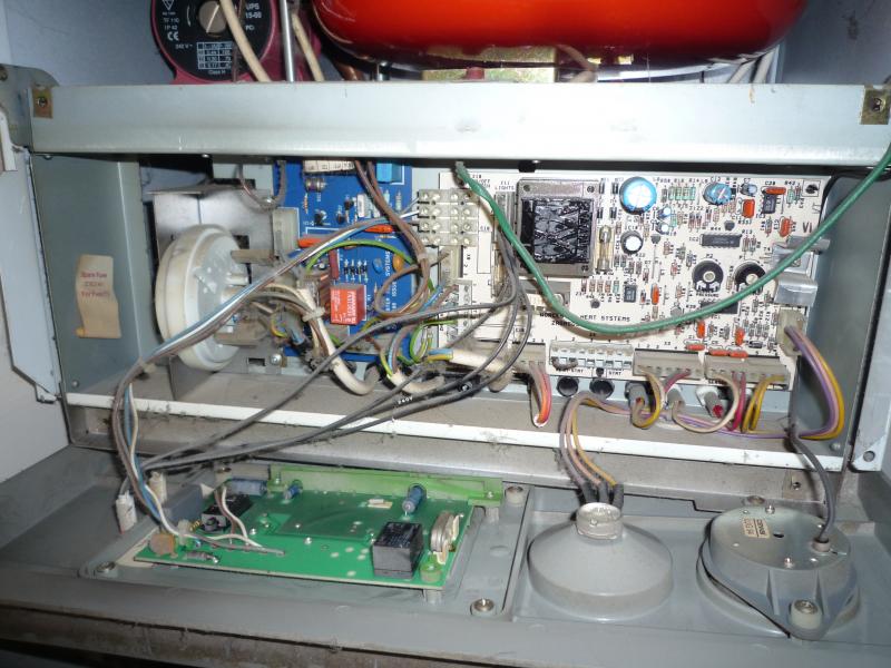

If it helps, this is the view with the front control panel removed:

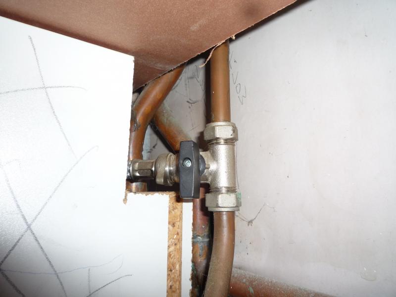

Guess what? I answered my own question!
Hopefully this post can help someone else instead of me!
I looked in the cupboard below the boiler and I found this in there, which connects to the "Cold" pipe.
I turned this black tap on, and it started filling. The pressure is now at 1.3 bar, so hopefully no more repeated radiator bleeding required.
Sorry to bother everyone.
