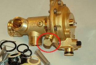

Towards the end of the building project, we finally got our kitchen back and I noticed there was a definite drop in the hot water flow rate (or maybe pressure?). Basically, before I would get bubbles when filling a bowl of hot water to do the dishes, and now I don't.
I borrowed a weir cup and measured the HW flow at 7lpm. I didn't measure the cold (which was stupid), but basically it comes out like a rocket!

check the filter which is on the cold water feed into the diverter valve. it may be full of carp.
also on the div valve is a small nut for reducing flow, make sure it is fully open

I cleaned the filter on the div valve when I replaced the diaphragm, but I didn't touch the nut. In fact, I don't even remember seeing it :)
I'll give it a go and report back - thanks for the tip.
I undid it several turns, and there was a click. My assumption is that there is a stop to stop you removing it completely, and I had reached "fully open" already.
I measerued the flow rate before and after (crudely with a 1l jug), and there was no difference - about 10s, or I suppose about 6l per minute. The jug is slightly more than 1l to the brim, so I will guess at no change from my 7l.
