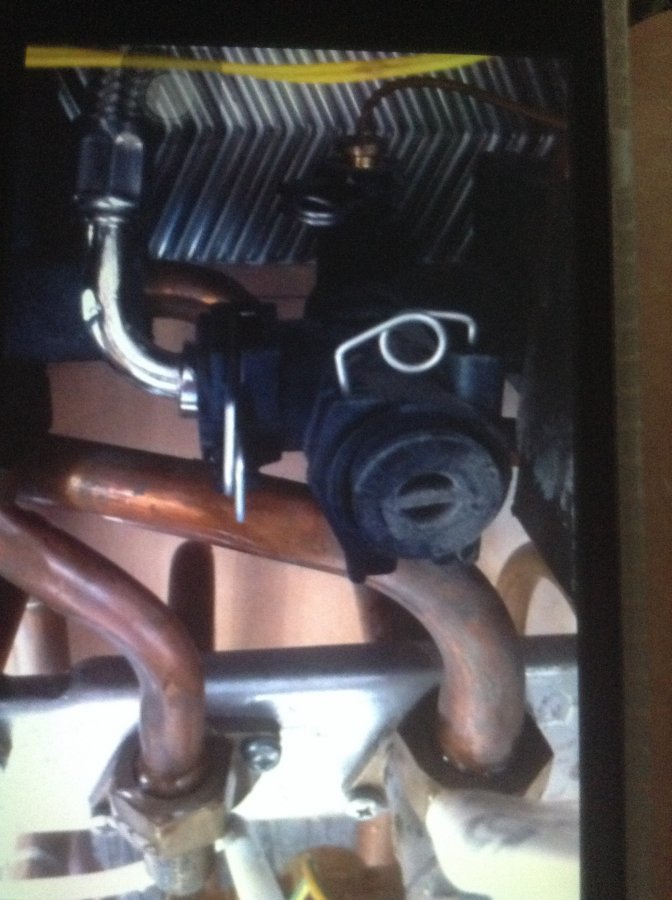

My combi boiler was moved when building an extension and was working fine before. My plumber refitted the boiler but it wouldn't fire up and suggested it was the fan or pcb. However, after he left I reset the boiler a few times and got it running..must have been a bit of dust or something that needed clearing. Everything was running fine until water started pouring out of it!! I tried to re-pressurise but there's water coming out of a plastic part to the left of the pump which attaches to a stainless steel hose by a clip. Water is coming out where the hose enters the plastic part.
Can anyone suggest what part this is please as I will buy it ready for when my plumber is next free. Is it the flow unit? I've attached a pic of the offending part!

I'm now thinking it's the expansion vessel connection and is leaking where the flexi hose enters the plastic connection?

Could be just a matter of pulling the clip, inspecting the o ring, either replace it or put a bit of silicone lube or lsx on it and try again.

Can I please check that you mean the o ring on the end of the bent flexi hose that enters the plastic component (as seen in my image)? If so, I've had a look and it is intact however water seems to flow under the hose insert. I tested it again today by unclipping, pushing hose in fully whilst continuing to hold it, then re-pressuring which seemed to work until I let go of the hose and water flowed out between the hose and bottom of plastic component.
Also tried some ptfe tape but no joy. I will try lsx as I used that recently for my new rads.
Excuse my ignorance but should there be an o ring or washer inside the plastic part as well as at the end of the hose? Had a look but couldn't feel anything.
Thanks again for your help - any further advice welcome :)
Thanks nortonj, it was indeed a perished o ring.

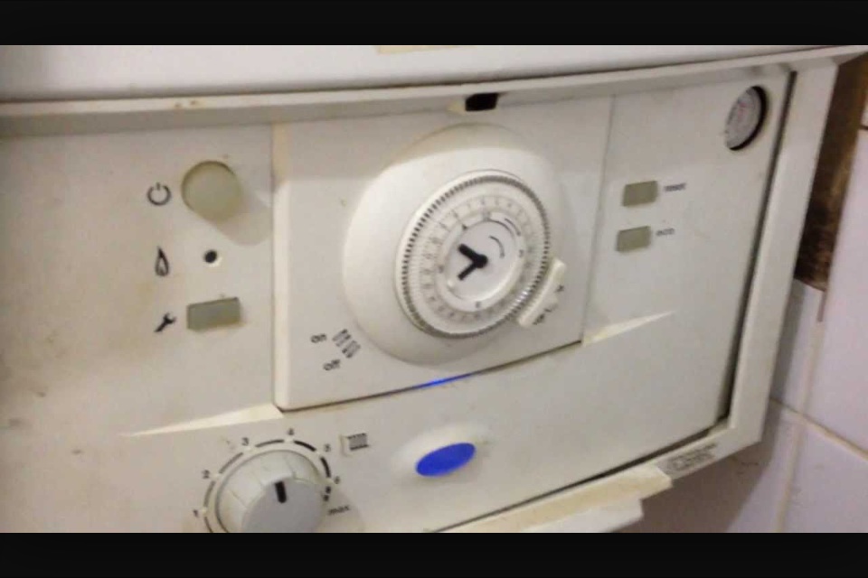

However, once re-pressurised to just over 1 bar, the boiler fires up ok and rads are all working ok but it only works off the timer dial, I.e. I cannot override using the on/off slider button at all. To stop the boiler, I have to change the timer clock to when it's off. Seems very strange.

Sorry I mean the on/off/timer switch on the clock on the actual boiler itself. The room stat hasn't been fitted yet so just working off the boiler for now.
Tried again tonight, switch next to clock doesn't do anything but when timer is set manually (by pushing the small buttons on the clock in) then the boiler fires up and rads get warm.
Seems the on/off/timer switch isn't working but timer on clock does?

The MT10 timer in the worcesters are notorious for doin as you described. Wheyou say water comes out of the overflow do you mean the copper pipe or the plastic one?

So is it just a matter of replacing the MT10 timer then? Is this a straightforward job?

Any idea with the switch? Does it sound like this just needs replacing as a common fault?
