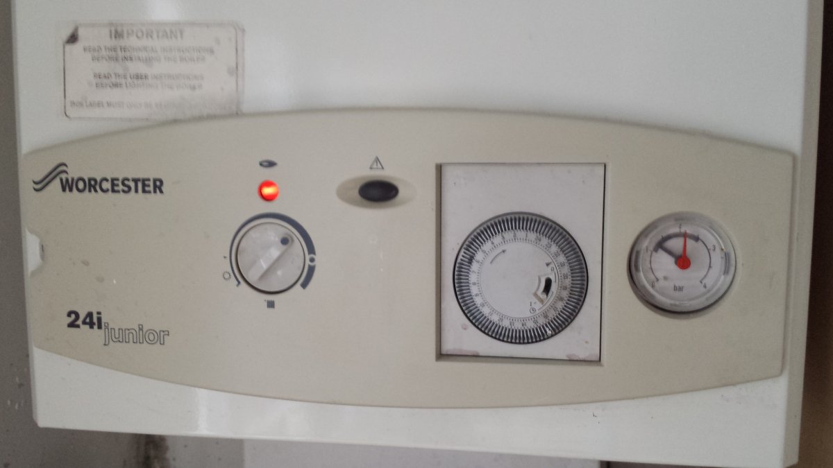

Worcester 24i Junior pressure adjust

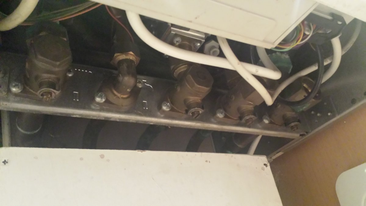

Just taken a pic of underneath the boiler, hope this helps... just need to increase the pressure...
Pressure seems fine at 1 imo, but for future reference you'll have an external loop somewhere, possibly in that boxing where all the pipes are.

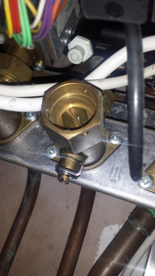

No, that's an isolation to isolate the water.
If you look behind that boxing you'll probably have a pipe attached to the one your looking at with a loop attached.
A picture of the general area around the boiler front on would be more help, showing the pipework and the units below, the filling loop is quite clearly not an internal loop.........
Found it! theres a tap underneath in the back of the cupboard by the floor... many thanks.... sorry I just thought something would be inside the boiler...
