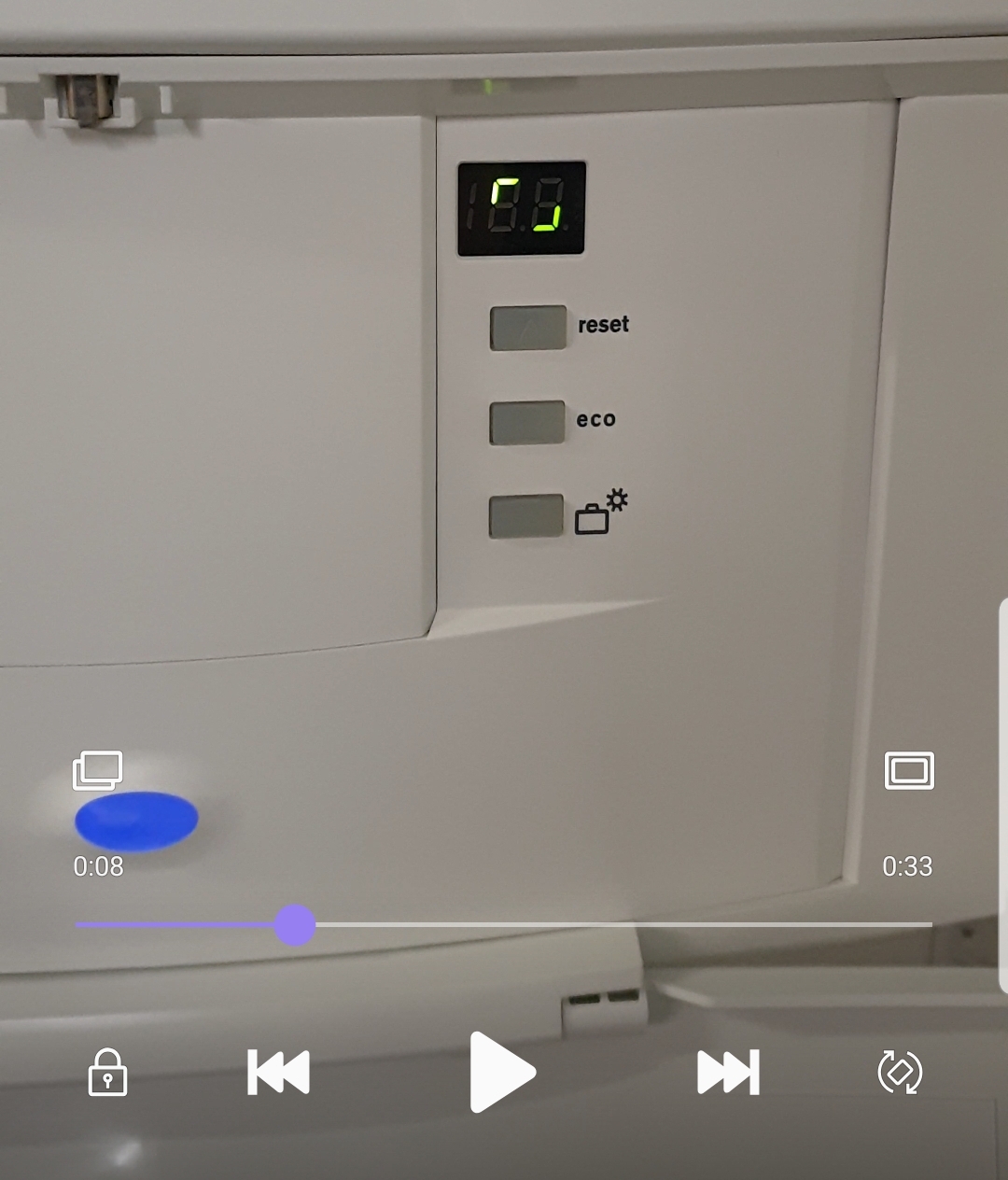

We have a 6 yo Worcester Bosch Greenstar 30CDi.
Today, when the demand for heating ceased, the temperature on the boiler showed 80°C. When the green 'flame lit' light went out, the temperature started to rise quite rapidly, peaking at 108°C. The figures 108 flashed alternating with a part bracket in the corner (see attached file).
I am going to phone Worcester Bosch in the morning, but would appreciate any guidance.
Do we have a problem?
Is it going to have a long term effect on our boiler?

Got the exact same problem with mine today, worked fine all morning with the temp in the mid 60s and then suddenly spiked out of control to 100+.
No error codes showing, I tried turning the thermostat down, letting it cool and then turning demand back on, which is when I got the video. Now I've switched it off and will try it again in a couple of hours when it's cooled to under 60.

The Worcester technician came out yesterday. He has recommended that we change the pump setting from the variable power/speed setting to a constant speed. We have done this and it seems to have overcome the problem.
I have also spoken to WB technical support who say that the flashing temp display is due to a too rapid rise in temperature.

Can I still do that if the boiler is non-functional? I came back from a week away and the temp had fallen to 21, switched the heating on and it was at 80+ within 30 seconds, as though it's heating the same bit of water and not circulating anything.
