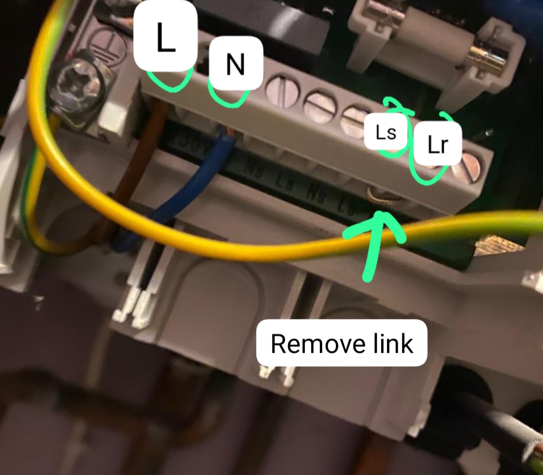

Hey folks looking for a bit of confirmation.
I'm about to install a nest heatlink in my mother's house her boiler is up stairs so I'm trying to make life a bit easier by installing a nest thermostat.
I'm intending on using 4 core flex cable can someone confirm If what I'm thinking is correct
1. Remove link between LS & LR on boiler
2. LS to no 2 on heatlink
3. LR to no 3 on heatlink
4. Can I use the L & N for power

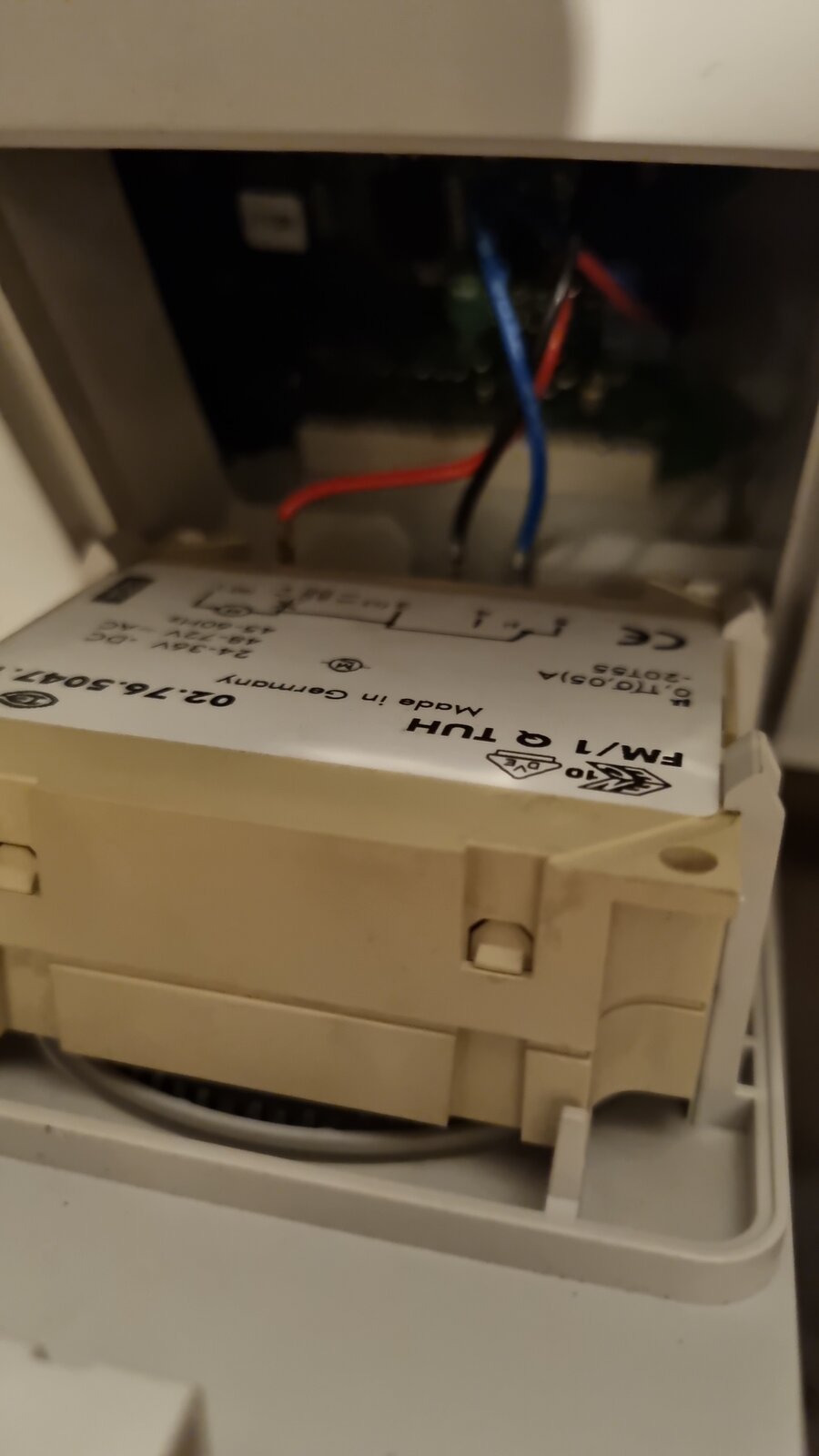

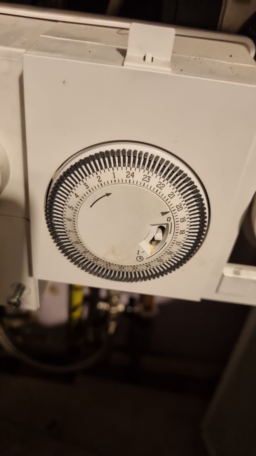

And last of all what do I do with the mechanical time can I leave that attached or just unplug it
Please see attached image & thanks in advance

Steps 1-4 yes. Mechanical time clock just set to constant on and Nest will take over. Not sure which model you have, but might need to check for safety afterwards

Superb thanks it's Worchester Bosch 28i junior (an early model) couldn't find another with the same board online so though I would post here.
