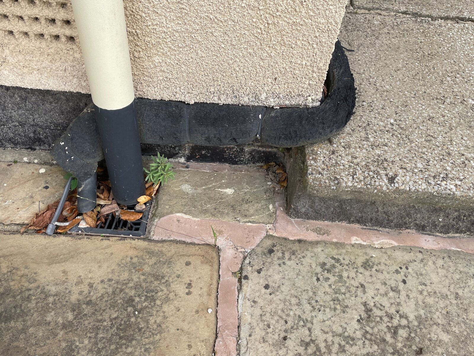

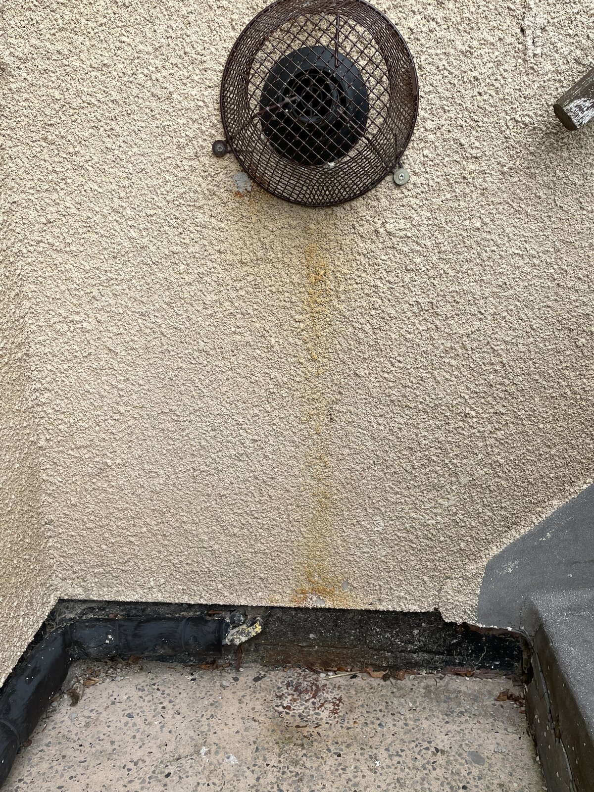

A quick check outside there is only a large diameter drain (for the condensate?) and a small pipe that is capped off with some sort of domed valve (??). No water under this copper pipe. :(

Bottom right hand corner "upload a file" then simply add your pics, the small copper pipe is not capped off that is a WB PRV, tie a freezer bag or balloon or something over the end and see if any water gathers in the bag, also set your boiler pressure when cold to 1.5 Bar, then put the heating on and go back after it has been on for about half an hour and check the pressure guage and see what it is now reading, if it has increased up to around 3 Bar you have an expansion problem

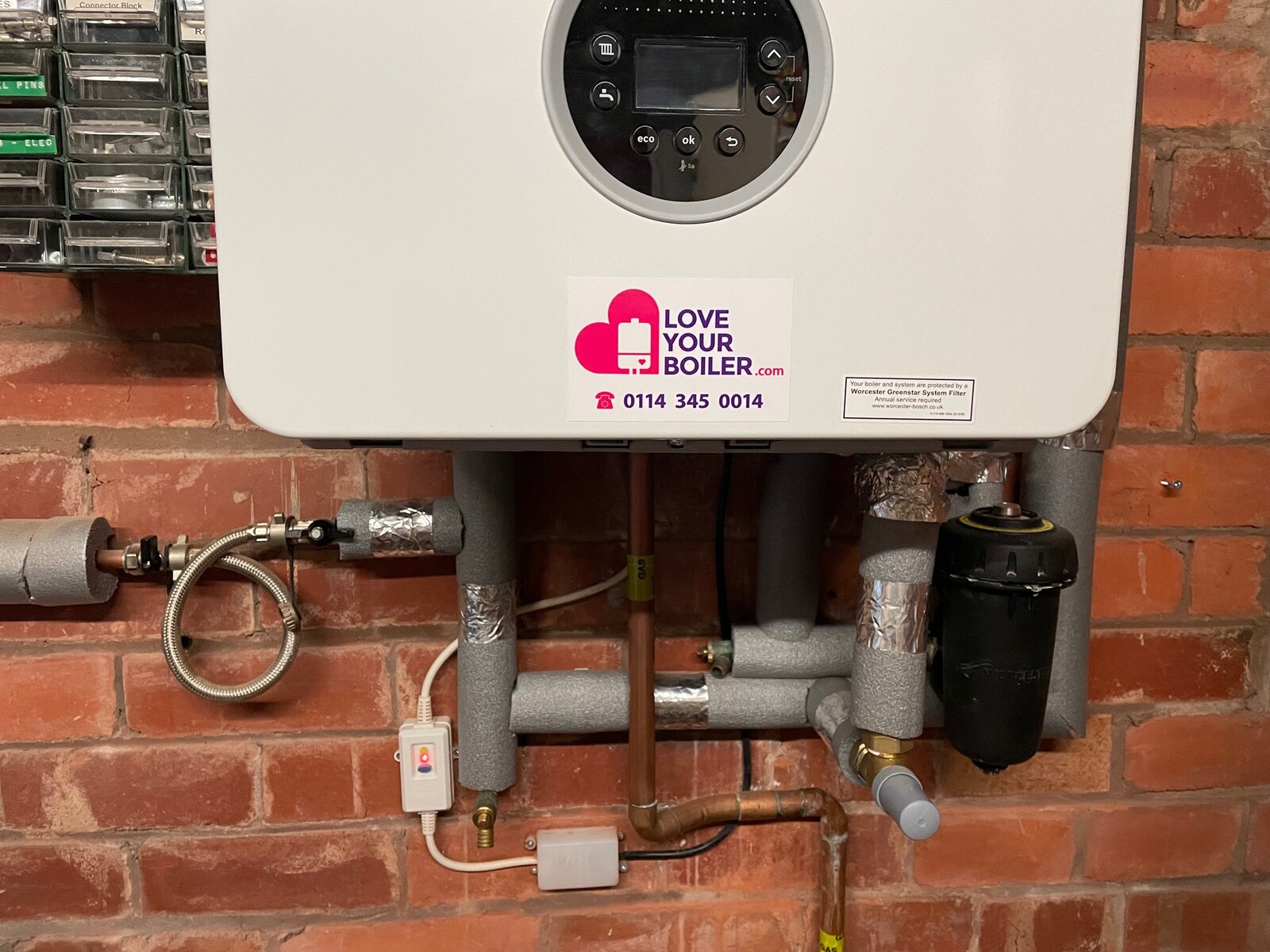

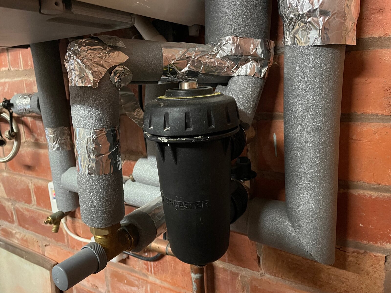

Anyhow - to the pictures (thanks to Ian pointing out where the 'Upload a File' button is.
^ ^ The boiler in the basement ^ ^

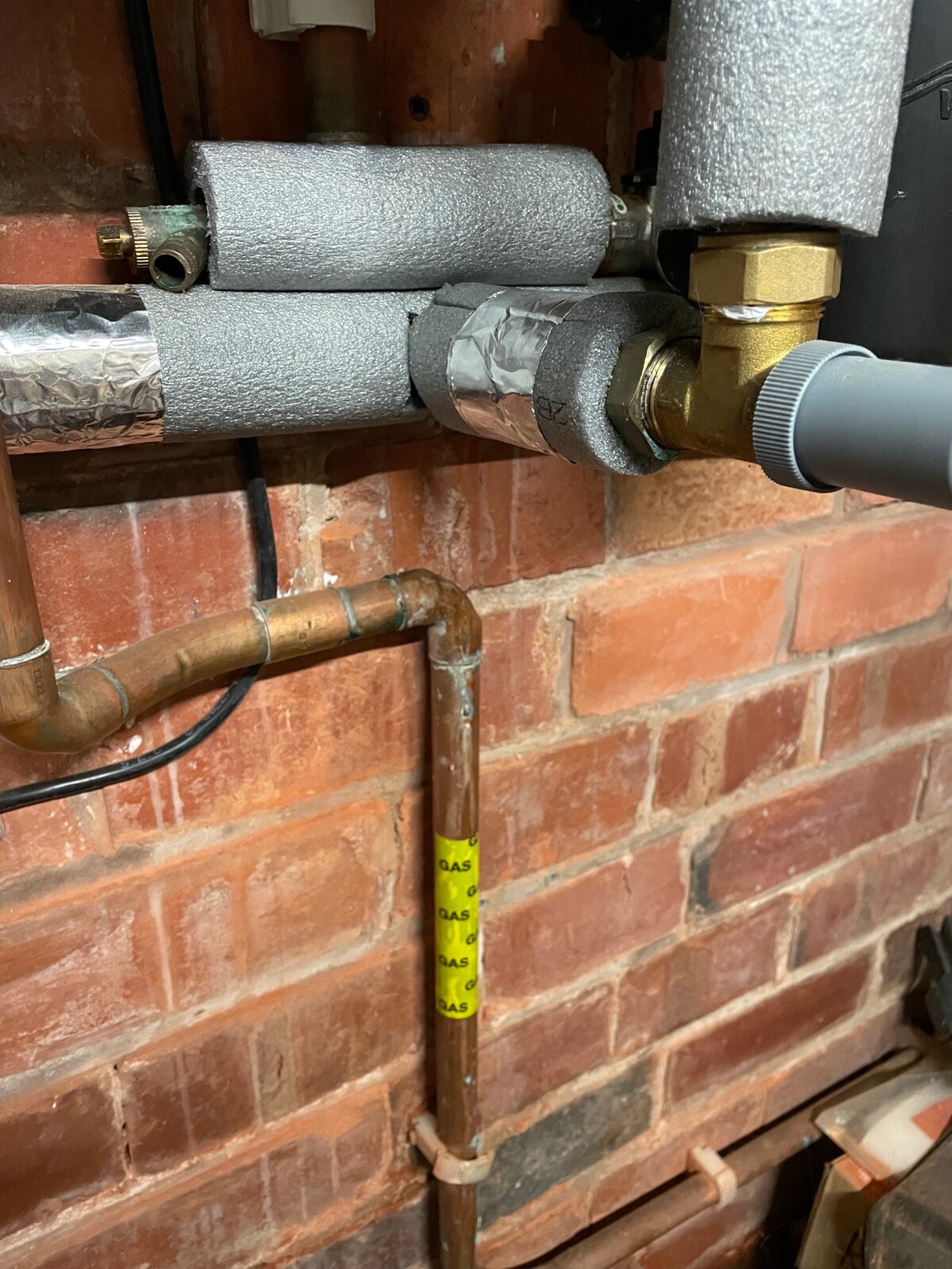

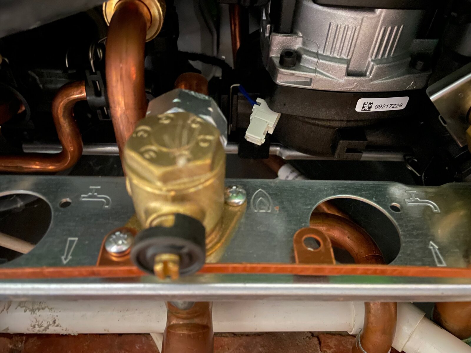

^ ^ Pipework under the boiler (view 1) ^ ^
^ ^ Pipework under the boiler (view 2) ^ ^
^ ^ Boiler 'innards' (which are dry)^ ^

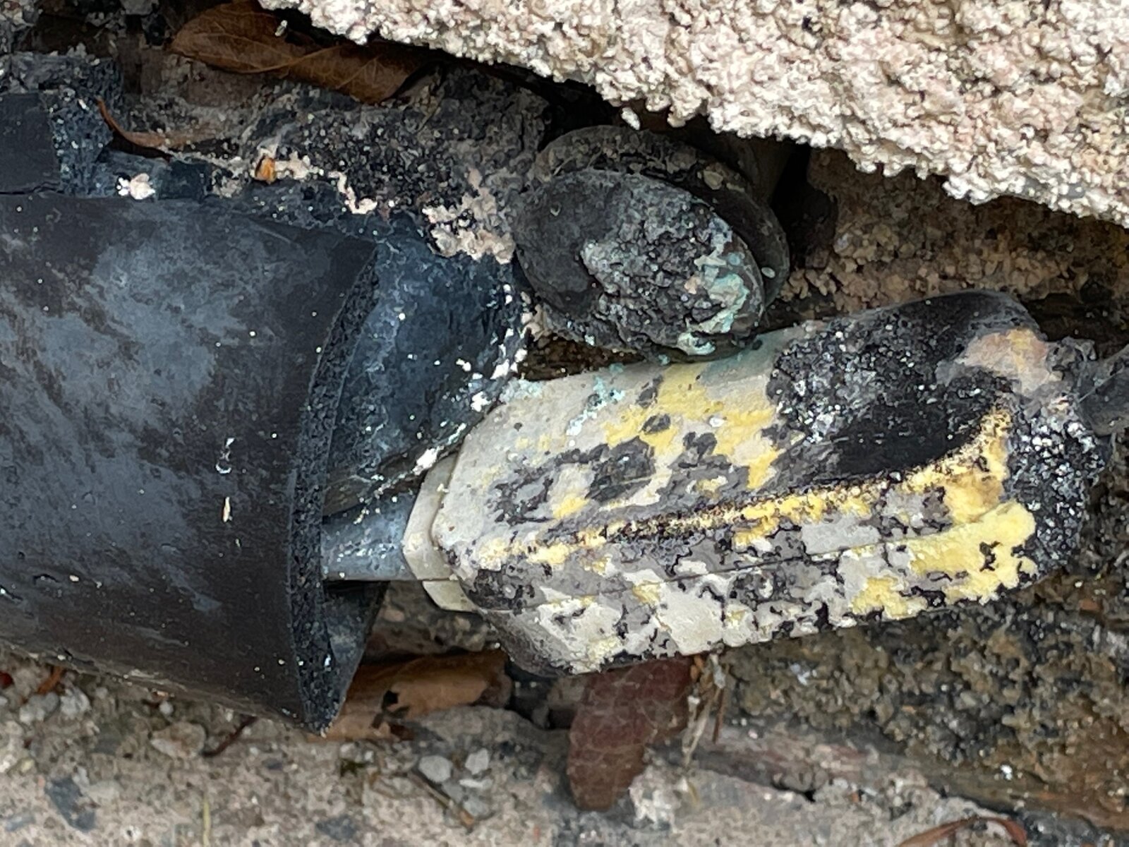

^ ^ External Vent and Condensate Pipe ^ ^
^ ^ Close-up of Vent (Pressure-Relief Valve?), Condensate Pipe and Trace Heater ^ ^
^ ^ The end of the Condensate Pipe ^ ^
These pictures should be viewed referring to post #3 this thread. They were taken this morning.
@ianmcd Two questions.
1) I presume WB PRV means Worcester Bosch Pressure Relief Valve?
It wasn't fitted when the new boiler went in - this dates back to the British Gas installation of the Ideam Minimiser way back in 1997.
2) Is it not dangerous to over-pressure the system? The boiler yells at me to stop above 1 bar. If the cold pressure was increased to 1.5 bar as suggested and the heating fired up - what could be the possible negative consequences of doing that?

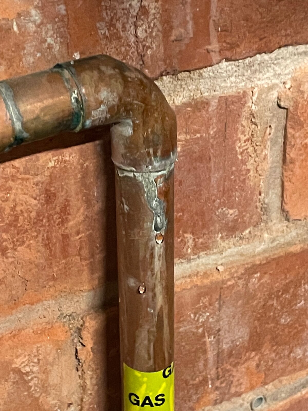

I took a couple more pictures - showing the drips under the boiler. The floor underneath the boiler has a damp patch but no 'water' as such. The inside of the boiler - as far as I can see and feel - appears to be dry.

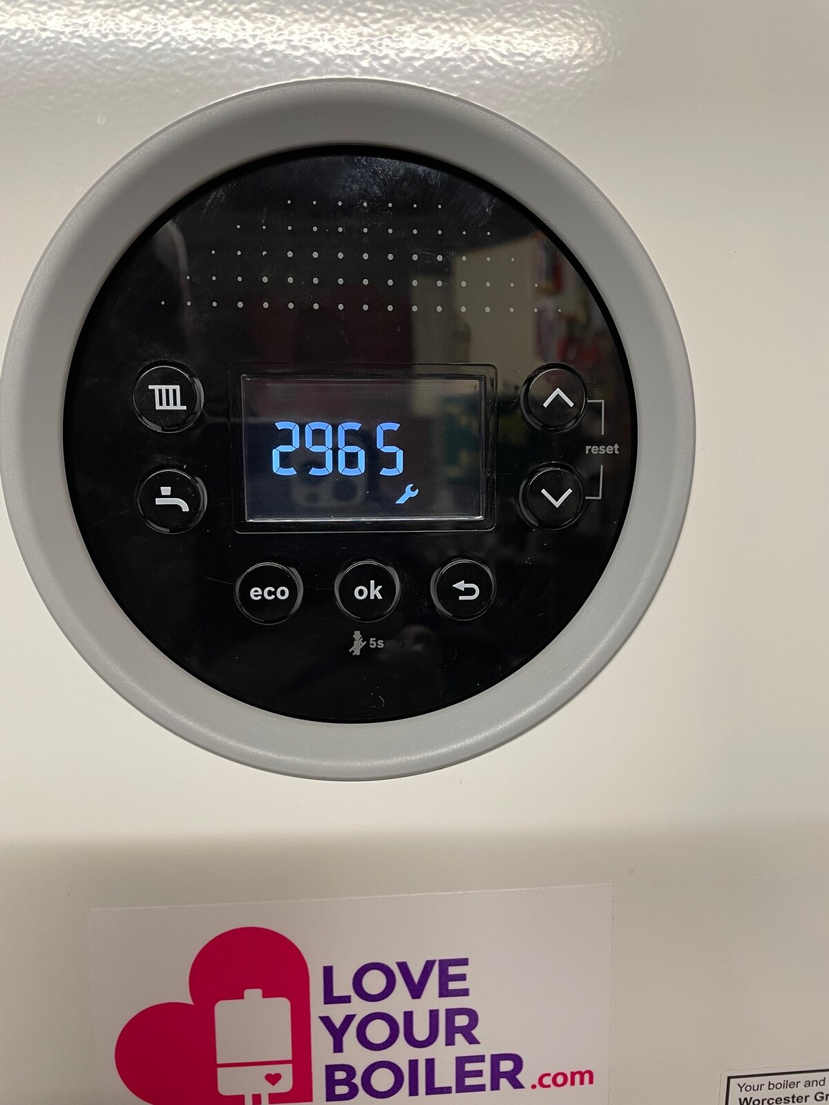

Boiler is reporting a new error code as well as LoPr 0.5 bar, namely '2965' which apparently means 'Flow Temperature Too High'.

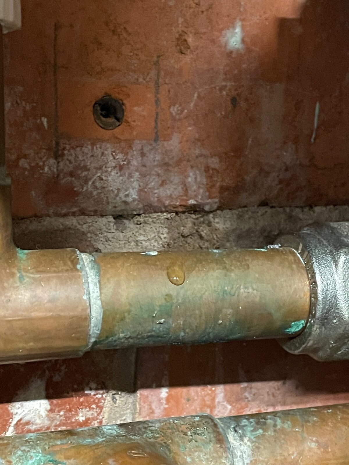

^ ^ Pipe underneath boiler showing water on the surface ^ ^
^ ^ Close-up of said pipe ^ ^
Installation Manual says that 2965 'Flow Temperature Too High' means '1. Check the flow through the appliance and the system is filled. 2. Check for airlocks in the system and purge if required. 3. Check the isolation valves'.
This leads on to 3 questions!!
1) How can I check the flow through the appliance and that the system is filled?
2) How do I check for airlocks and purge if needed?
3) What do I need to check about the isolation valves??

The boiler has lost pressure, hence why you’re probably getting the additional error message. Remove the insulation above the pipe that has the water on it, this might reveal something, although there’s a drain off with some green on it that looks suspect.

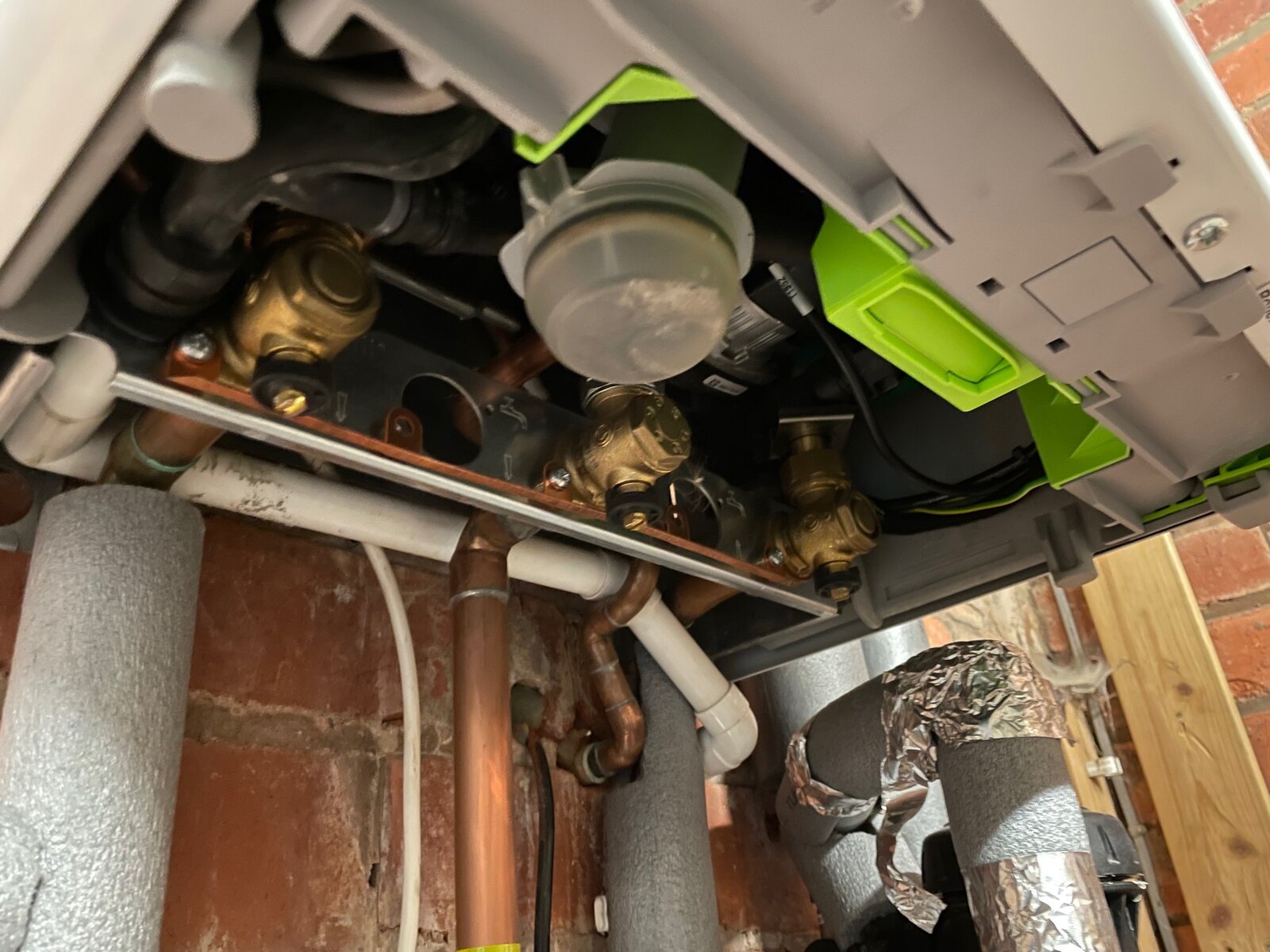

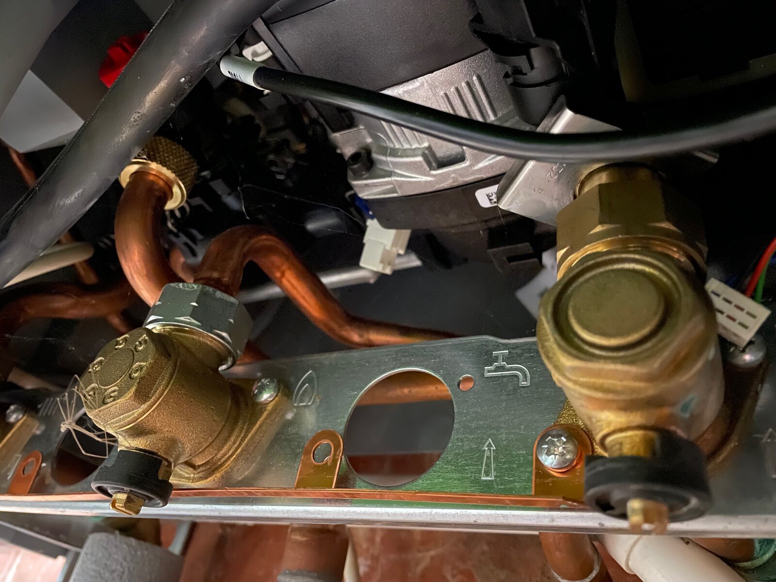

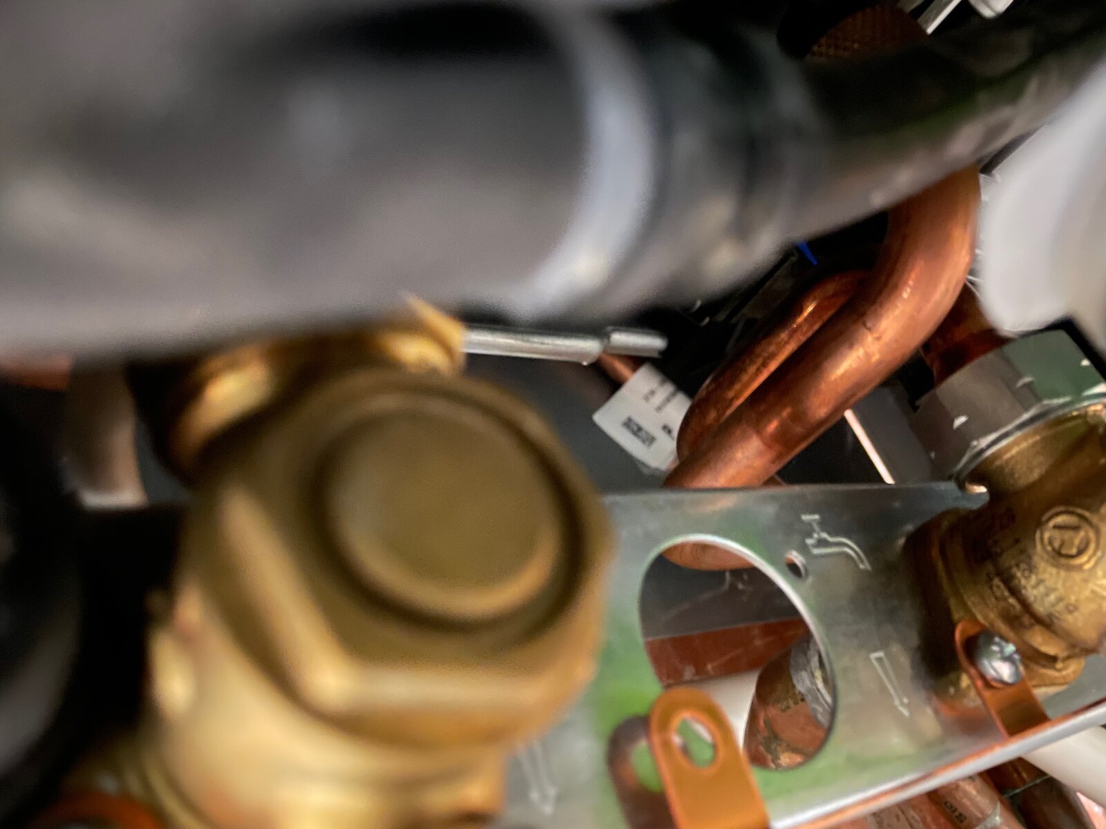

Some additional pix and info ..
^ ^ The floor underneath the boiler (the darker red area is damp but not wet) ^ ^
Easier to see in 'real life'.
^ ^ The 2965 Error ^ ^

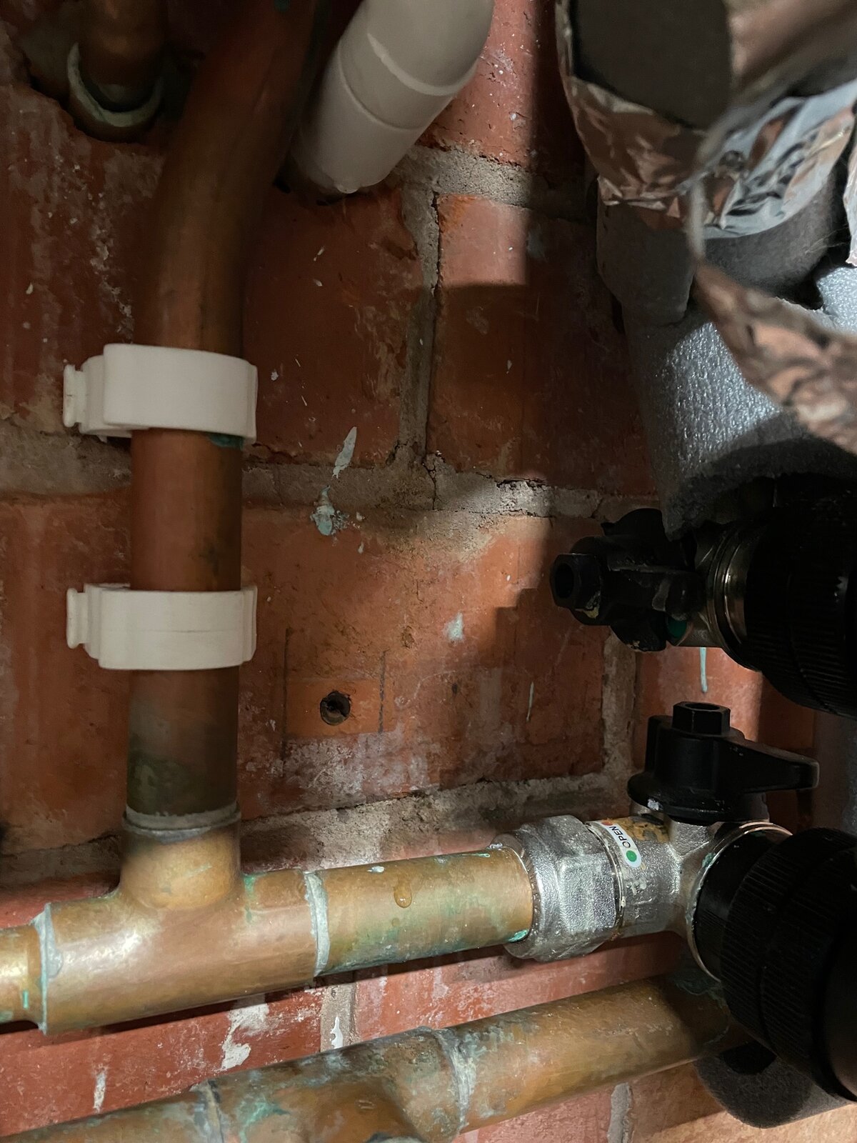

^ ^ Pipework under the boiler after insulation rmoved ^ ^

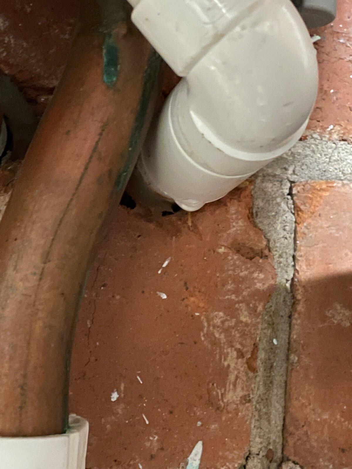

Note the drop of water at the bottom of the white condensate pipe and on the copper pipe below.
No evidence of any water anywhere else.
^ ^ Close-up of condensate pipe and water drop ^ ^
^ ^ Close-up of drop of water on the lower copper pipe ^ ^
The green colour seems to indicate that this has been 'wet' for a while ?
^ ^ Innards (1) - eveything looks dry ^ ^
^ ^ Innards (2) - everyhing looks dry ^ ^
^ ^ Innards (3) - everything looks dry ^ ^

Ok, so the leak was the condensate pipe, which needs attention. Again, given the age of the boiler, I doubt it’s a failed main heat exchanger. Likely something on the 2nd floor.
