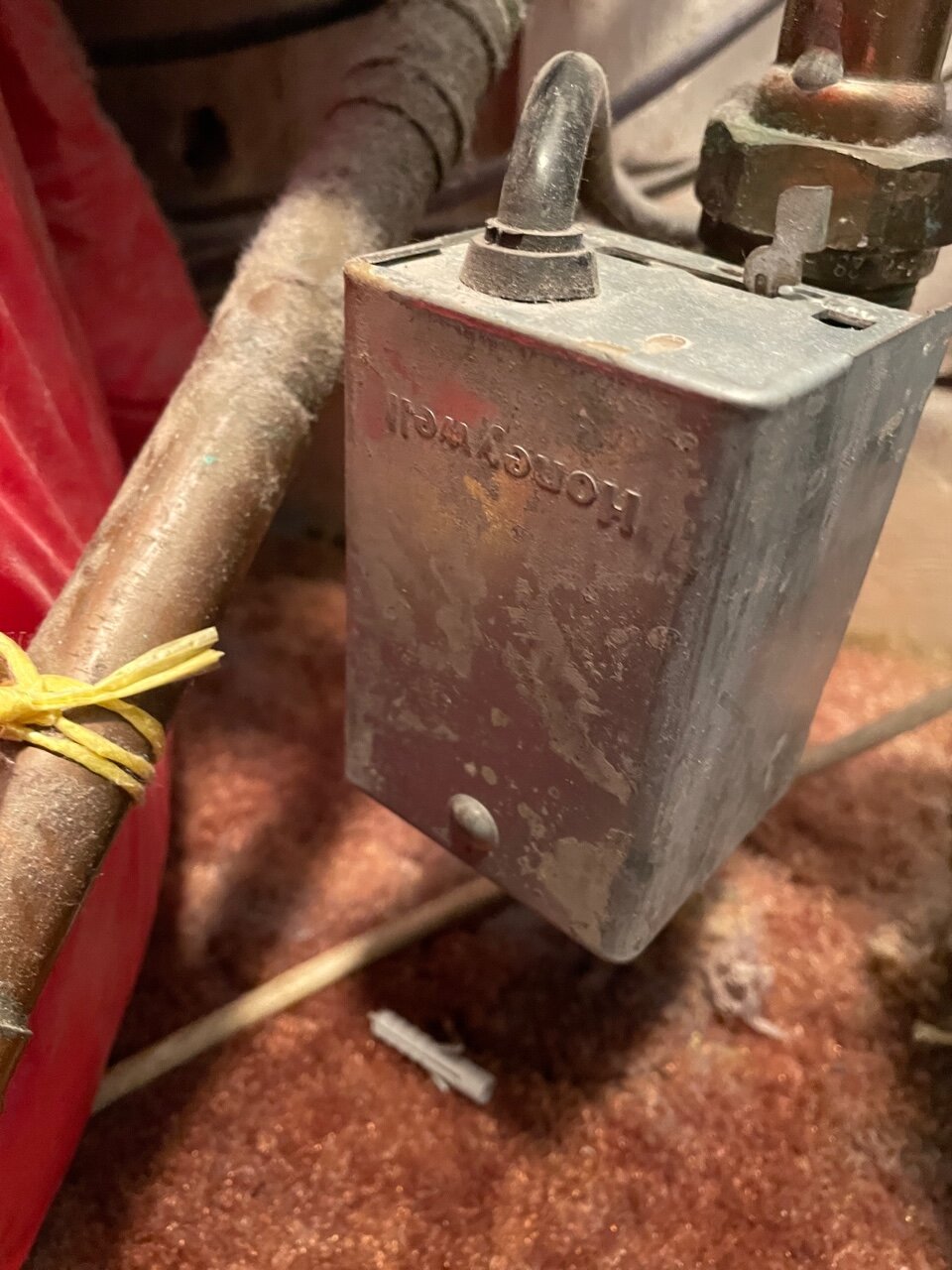

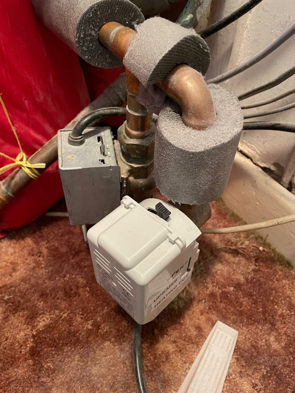

Zone valve issue is a possibility, stuck microswitch.
Voltage testing at wiring centre would confirm.
I’ve had the same problem several times over the years and I've heard it's extremely common. With me, it’s always turned out to be an issue with one of the zone valves.
Apols if you know this already! But the first time it happened to me, I was surprised to be told by the engineer that, (by a slightly convoluted process), it is the zone valves which actually send the demand signal for heat to the boiler. So, if one of the valves is sticking on, the boiler will run even if all the programmers and thermostats are turned off.
I think you should have three zone valves. One for each zone and one for the hot water cylinder. Being hopeless at electrics, I wasn’t able to do the electrical tests on the valves. But each time I had the problem, it was easy for me to diagnose which valve was causing the problem, simply by feeling which pipes were getting hot.

you either have a sticking end switch on one of your zone valves but you will need a multimeter to confirm, or your cables connecting everything are too close, worcester are the worst for EMF false switching but they sell a resistor that gets fitted to the boiler that stops this

yep agree it is most likely to be an end switch sticking, very common

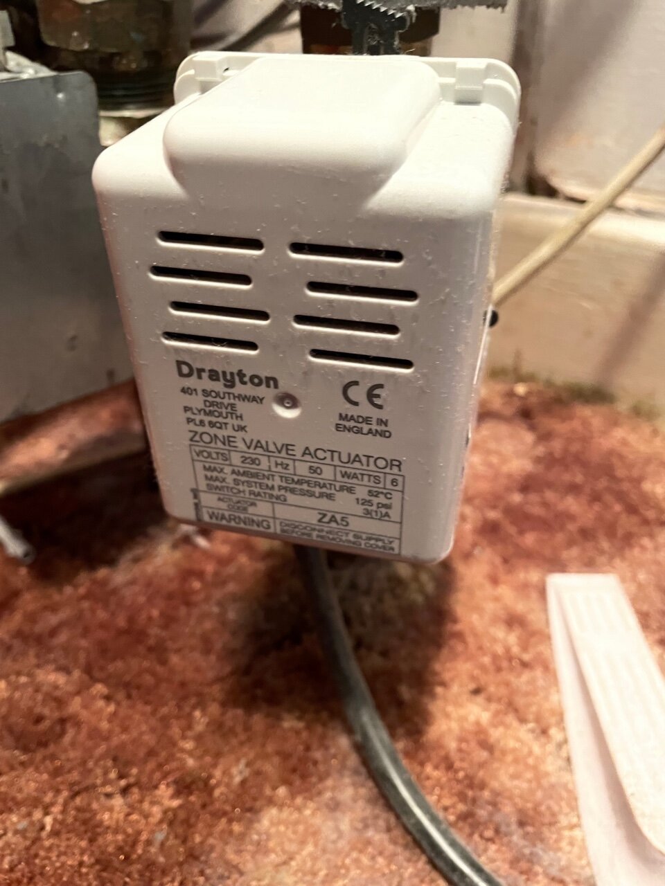

Pictures of the zone valves
DHW Zone Valve (the one that I think may be the problem)
Upstairs (Zone 2) - which seems to be working as expected (i.e. turning the heating to that zone on and off) under the control of the programmer/timer and thermostat for that zone.
Thanks in advance,
Dave

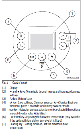

We have a system boiler with a hot water tank. DHW setting on the boiler is 60C.
It sounds like you can set the DHW temperature on the boiler separately to the CH temperature?
According to the manual excerpt below [6] this can only happen if you have had the optional integral diverter valve fitted. Do you know if this is the case?

It doesn't look like you have got the diverter valve kit fitted from looking at your previous photo below. AFAIK those two blank holes in between the shiny brass fittings would be fitted with extra valves like in the image below yours. Just to check we're talking about the same thing, are you saying you can press the tap symbol on the boiler control panel and set the hot water temperature in your hot water cylinder? Do you also have a thermostat on the cylinder itself?
Hi Jonathan,
Yes to both questions.
Pressing the Radiator key (number 7 in your earlier post) we can set the CH temperature - currently set to 65C and pressing the Tap key (number 8 ), we can set the DHW temperature - currently set to 60C. Yes we have a cylinder stat clamped to the side of the cylinder beneath the insulation.

Implicit in your reply is that the boiler doesn't have a diverter kit and that it should have - i.e. it hasn't been installed correctly? Am I understanding that correctly or does the presence of a cylinder stat negat the need for a diverter kit?
It was just information gathering, trying to work out how your system was set up, in case that shed light on your problem. But it's only confused things I would imagine! I wasn't suggesting it hasn't been installed correctly. You don't need the diverter kit for the boiler to work properly. The diverter kit just allows the boiler to be set up to work in a different way. Is your engineer still coming this evening? Is it the same engineer who did the install?
