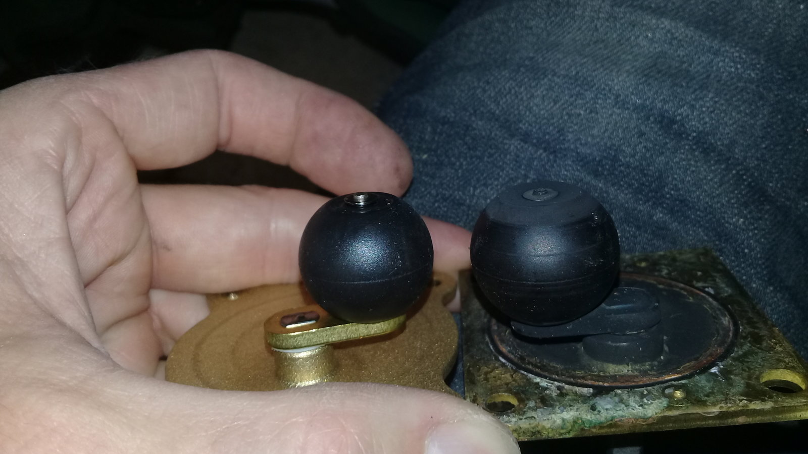

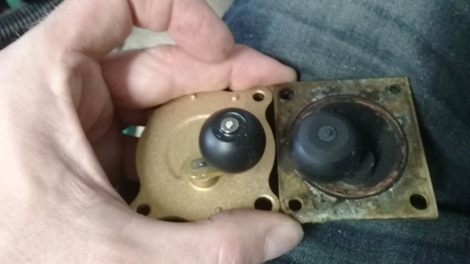

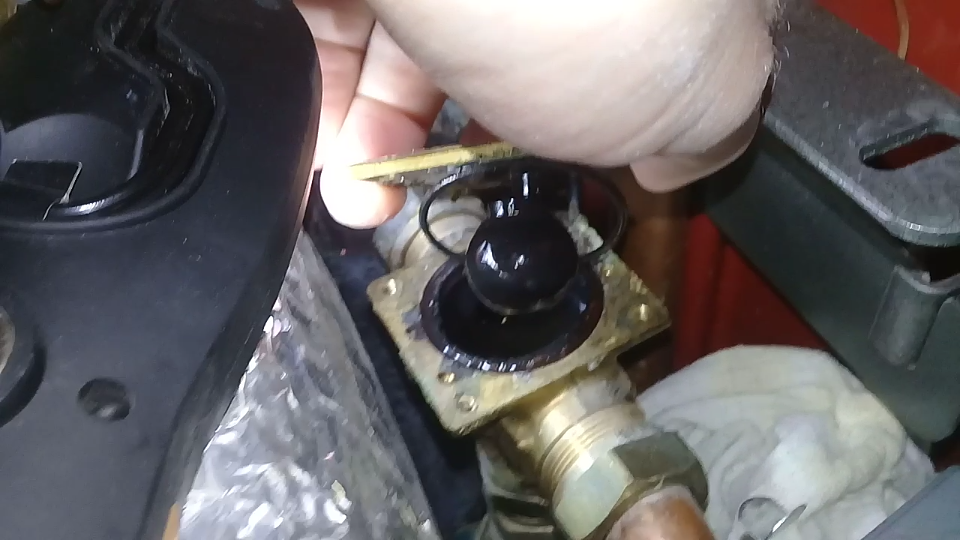

New diverter arrived today so went to work on the boiler. Couldnt get complete valve out of boiler so replaced the head and the top plate that contains the rubber ball. Not sure the one i took out was origional or not as was a square plate rather than the new curvy one. Rubber ball looked slightly swollen and wear on bottom part. The shaft on the new one moved more easily than the old one. Put it all back together and tests so far have hot radiators rather than lukewarm.
