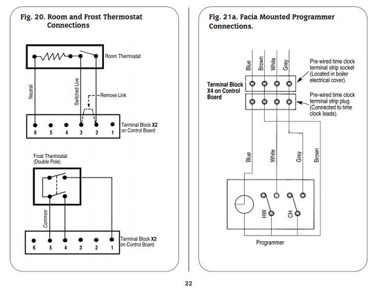

Can I get a room stat fitted?
If I can fit a room stat, will that stop the boiler sending hot water around the system when it isn't required?
Also, how would I go about fitting a room stat?

You've got it. The boiler thermostat will control the temperature of the water is that is leaving the boiler and being circulated around the system, and the TRV's will slowly shut down the flow of water to each radiator as the room temperature in which it is located warms up.
I haven't had any personal experience of your boiler, or its controller, but a quick look in the manual, (If you don't have it, you can download a copy here) shows how a room thermostat can be connected to it in the top diagram of fig 20. Terminal 2 is the 'live', terminal 3 the 'switched live', and terminal 6 the 'neutral' (if neutral is required, not all thermostats need it. Some are mechanical in operation and others are battery powered)

As there is nothing apart from the boiler to know when hot water is needed for the central heating, in the current set up the boilers internal water tank is only kept heated when the demand for central heating is switched on?
When demand for central heating is switched off, it only heats this tank when a hot water tap is opened and the flow switch activates the boiler?
By fitting a room stat, and removing the link in the diagram, this will stop the boiler keeping the internal tank heated when central demand is switched on until the room stat calls for it, and therefore only heating the water when it is needed?
I am only asking to make sure by fitting a room stat, I am not running the risk of the internal water tank being over heated.

A room stat prevents the boiler cycling unless there is a demand for heat.

No! just the opposite, the thermostat should keep the whole heating system running until everywhere has warmed up. Whilst it's doing so, the boiler thermostat will look after the temperature of the water leaving the boiler and heading out to the radiators. Then, when the whole house is warm enough, and finally the room in which the thermostat is located reaches the temperature you have selected on it; it will switch the heating off completely (in the same way that the time switch or programmer does)....until the temperature in the area where the room thermostat is located drops and then it will start it up again.
