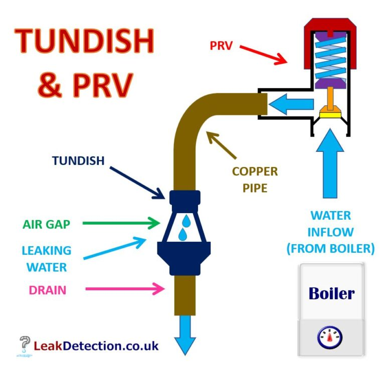

Is the copper overflow actually connected to the PRV - the pressure release valve or does it just do the condensate drain....there might be a tundish for the prv to drain into eg
