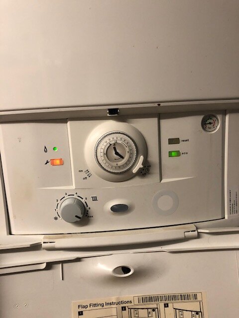

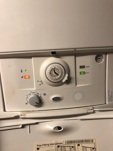

Hi Ian. I tried shorting out LR & LS with the timer disconnected - nothing changed... Do you have any idea what you might expect to see across the various sensors that are scatter around? The user manual shows just a picture of them without giving any details on the expected resistance of logic state.
you shouldnt have changed the PCB , it is a gas safe only job , but too late now, did you use the origional code plug or one that came with the PCB ?
Hi Ian - I know I'm playing in other's 'sand pit' but I just can't help myself. (The systems I work on don't break down very often and I'm a compulsive 'fixer' :)

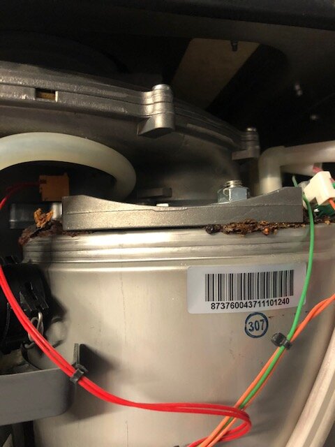

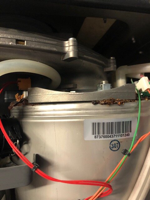

I used the original code plug to preserve the gas settings. Please find control panel attached. Once I work out what's wrong with it, I promise to get a gas safe chap in to check it out. (I think it needs new heat exchanger gaskets anyway - Second picture shows some 'Dr Who-like' matter oozing out).

Your advice is much appreciated - I will stop messing with it but from a technical point of view, the way I have it set up, that clock is not used in any way. The clock pins are all set to do nothing and the switch is set to permanently 'ON' so that the external timer/thermostat does all the switching. Do you think the clock is in some way dragging a rail down in the circuit - or something?
as i suspected you have an on board timer , it is connected to the 24v side and that is your problem , but not as serious as your heat exchanger gasket turn it off and get someone out right away
