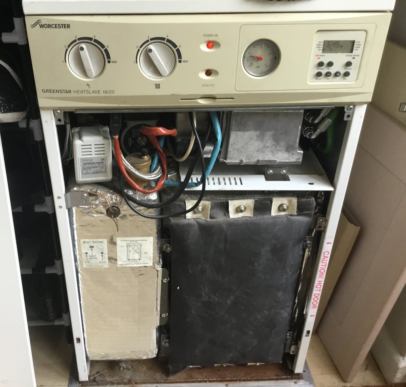

Hi, my first post here, but I sense not my last
I currently own this boiler, but up until now have been using an electric shower. It’s pretty pathetic tbh and I’d like to convert to a thermostatic shower. I’ve just run a bath to see how much hot water I’m getting. The answer is I get about 8cm before it goes colder, which is roughly 60 litres in our bath. The water temperature is good to use without adding any cold
(The water side is on all the time and the heating side is off)
This seems very little. Do you think there is a problem with the boiler or is this all I can expect?

The pressure gauge tells me that one is a combi.
Its capable of producing between 16 and 25kw depending on how the oil burner is jetted and set up.
The boiler has an internal Heatslave tank which holds water at a temperature decided by the thermostat dial on the front panel. Once the domestic hot water is called for, a flow switch clicks and fires the burner to keep the hot water coming. In central heating mode, the diverter valve moves to its other position and hot water is fed to the radiators.....the valve defaults to domestic on command but the internal pump is running in both cases.
Id venture a suggestion - if the hot water production is below par - that the diverter is passing some water to the radiators.....or the heat exchanger is becoming scaled. To be fair, running a bath is a stern task for any combi!

I’m not actually looking to run baths, was just doing that to test what volume of hot water I’d get before it ran cold. Approx 60 litres, or a heat bank’s worth. What I want to do is get rid of the electric shower and replace it with a thermostatic one
In the end I just pulled off the front and compared it with pictures from the downloaded manual. It’s definitely a combi :)
Anyway, time to get the heating engineer in
Thanks all
