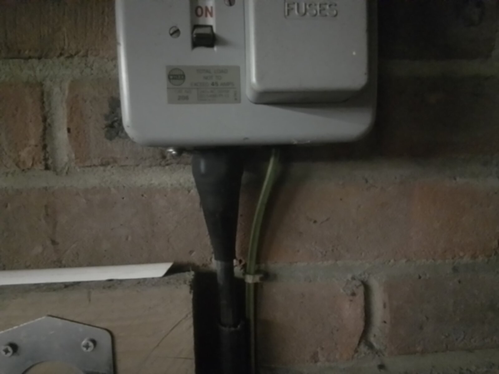

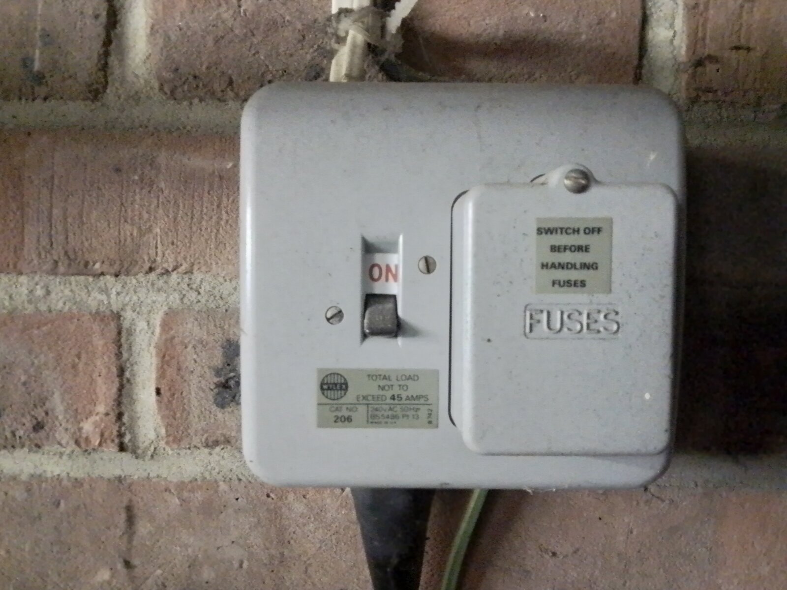

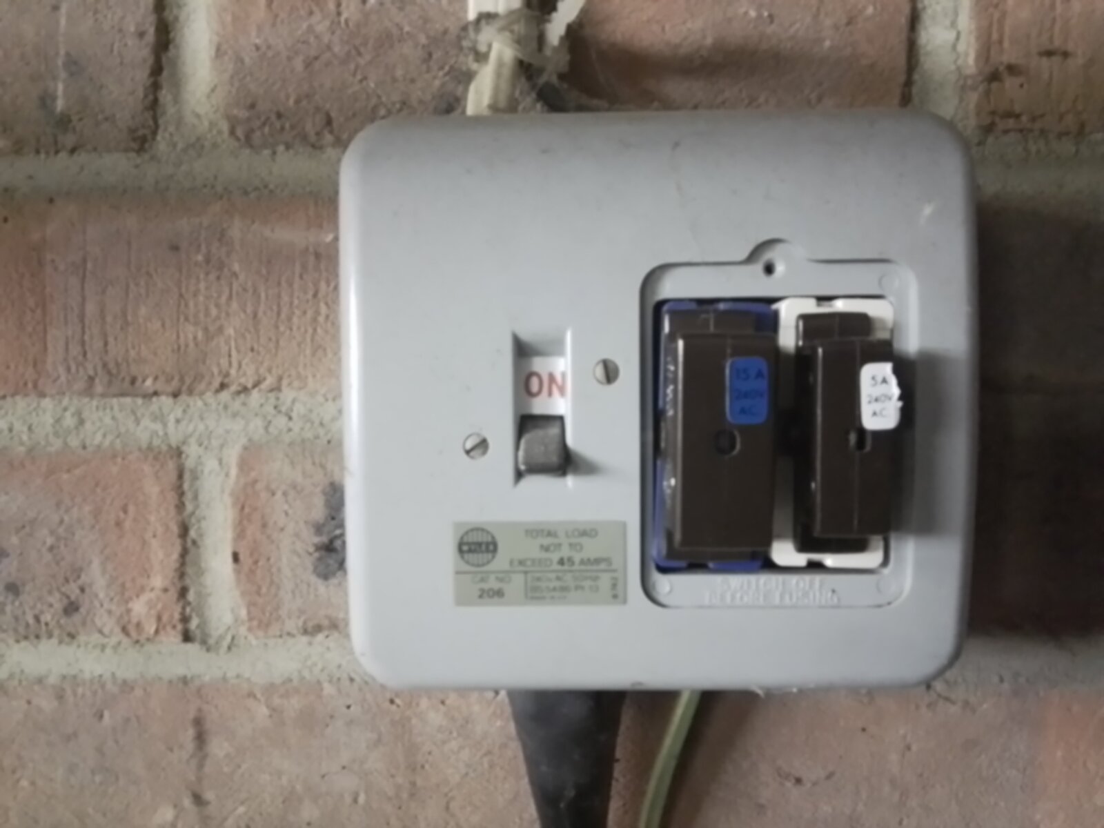

My house (built in 1989) has power supplied to the garage where there is a separate fuse box with a separate on off switch The garage fuse box says max load is 45 amps and there are 2 fuses in the box, one is 5 amp, the other is 15 amp.
From the 5 amp fuse I currently have:
3 fluorescent strip lights, 1 PIR light and 2 outside wall lights.
From the 15 amp fuse I currently have:
1 double wall socket
I am buying a wooden workshop which will be next to the garage and would like to understand what additional lighting and sockets I could add to the workshop and garage with this exiting set up.

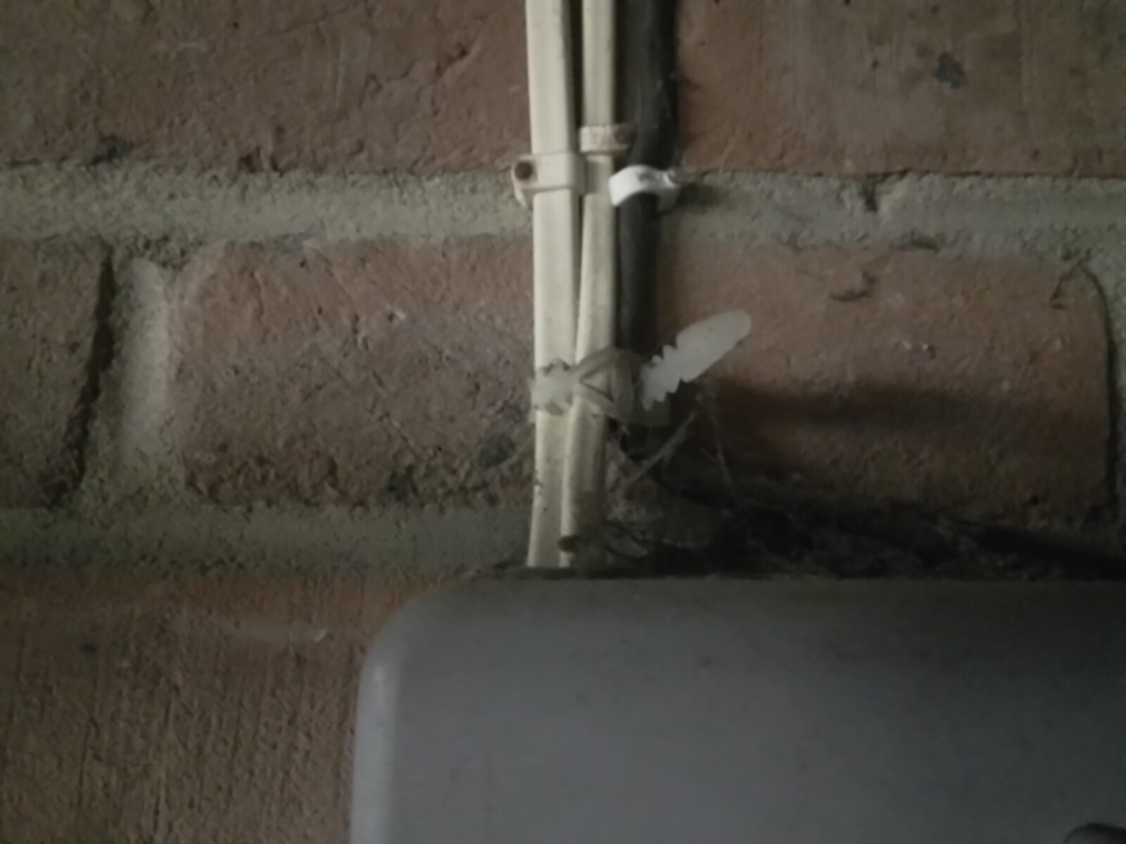

Step one is to look at the Wylex fuse box supply. If supplied with 1.5 mm² SWA clearly can't have same capacity as if 6 mm² SWA. Picture does not help. And also if supplied from a 10 amp MCB in main fuse box, clearly can't draw 20 amps what ever it says on the fuse box.
The fuse box will need renewing for a consumer unit, as today new sockets will need RCD protection, and although technically you can apply to the LABC and pay fees then DIY, that will cost more than getting a scheme member electrician to do the job.
The maximum load is a warning about the fuseboard, not what you can actually connect to it.
What is the other end of the supply cable connected to?

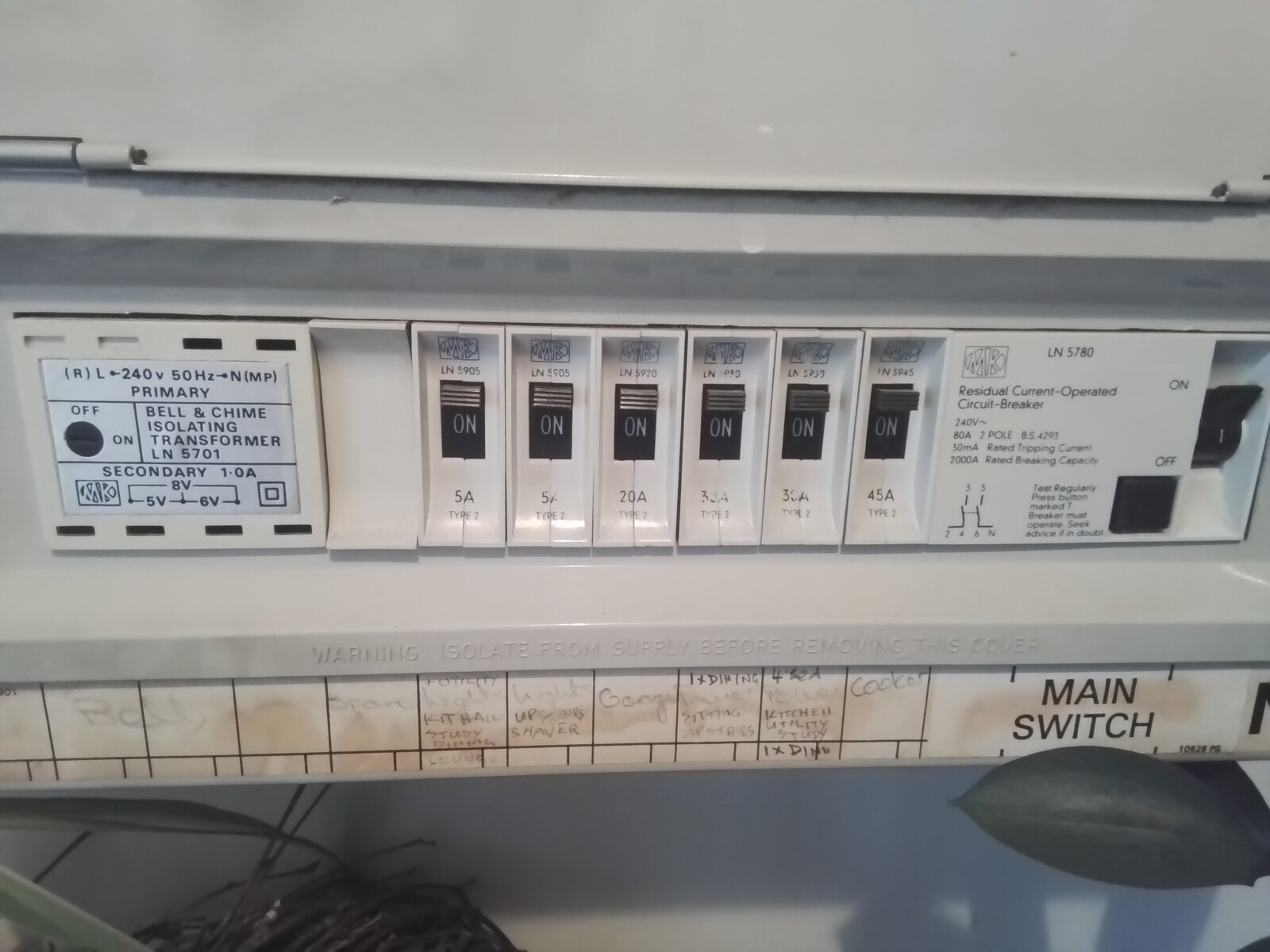

Thanks for the replies. Attached are some further photos which I hope clarifies things:
Fuse box in the house showing 20am fuse for garage
Bottom of fuse box in garage
Top of fuse box in garage
Can I add 2 more double sockets in the garage/workshop by looping in and out of an existing double socket (or using a junction box)
Can I add 2 more lights in the garage/workshop )same technique as double sockets).
I believe if the existing fuse box in the garage is not up to scratch, then I would need to get an electrician to upgrade.
Really appreciate any advice before getting quotes. Thanks.

You are not going to like this but I would recommend you get both units upgraded as they are really old
The house CU has a single up front rcd meaning any fault will rake out the house and the garage.
Best get eyes onsite to discuss and get quotes
