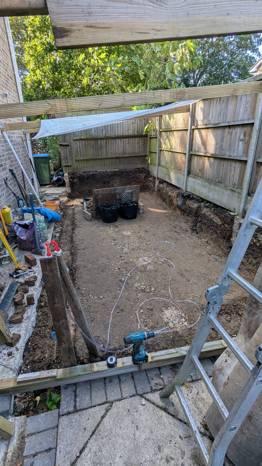

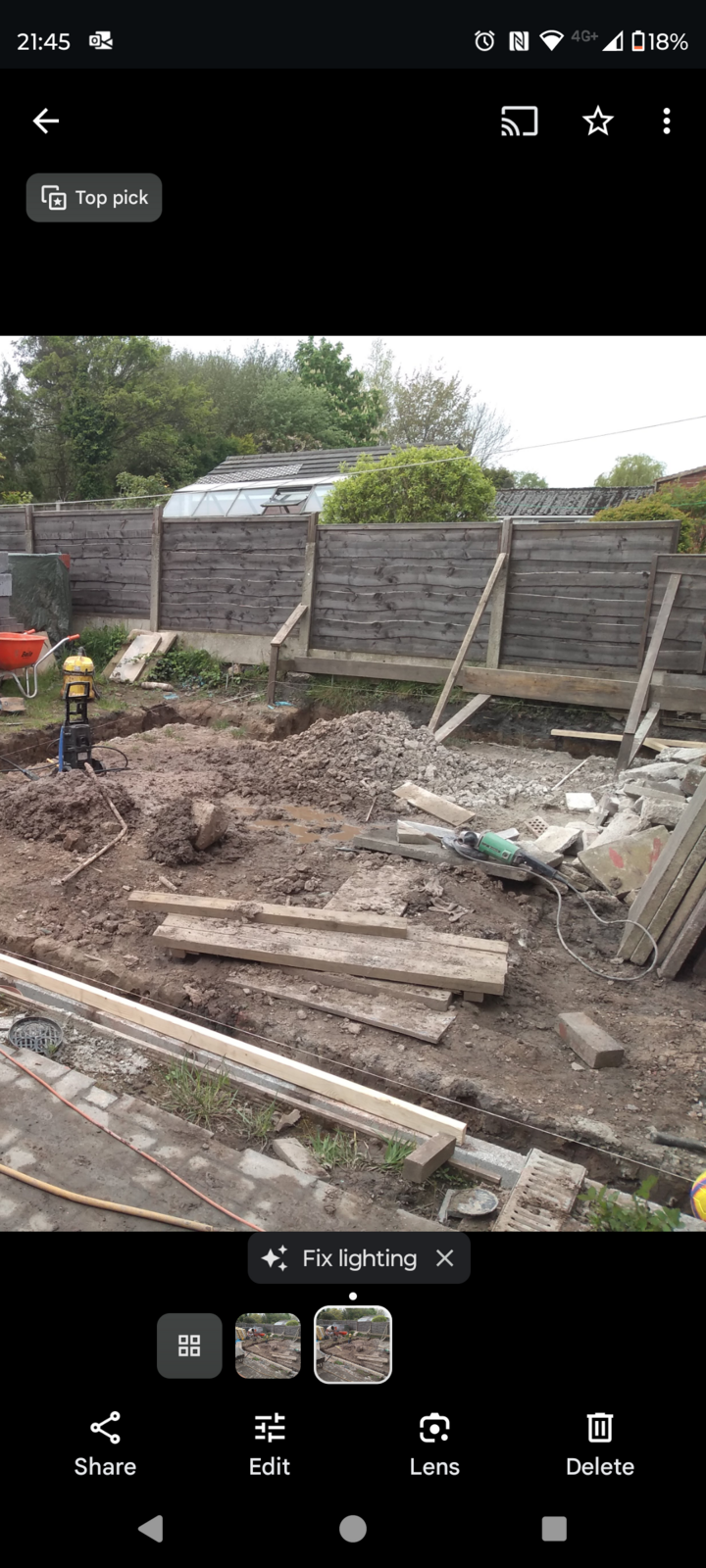

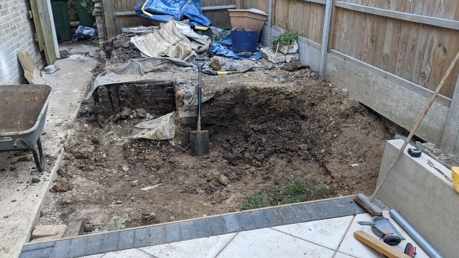

I've been digging the site out for about 5 years now, unsure what exactly to do with it and at the moment it's looking like this:
Measures about 6x2.8m. This is now ~600mm below original grade and is dense clay.

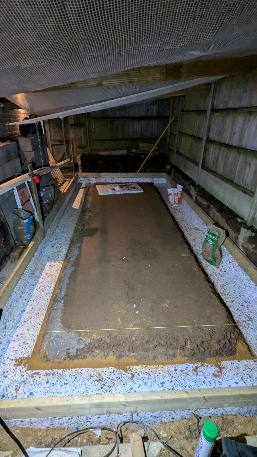

I want to maximise space, so I'm going single skin and due to a roadway beyond the fence, can't do strip foundations or double skin without bringing the wall further into the garden or eating into internal space. I am literally trying to shave off cm to get this to fit to a full block. And while I'm not planning to heat this at all, I would like to insulate my foundations so the temperature swings aren't as bad.
My current cross sectional plan is:
I appreciate this isn't a typical build as it's not a typical site.
The stainless flashing will be custom made to ensure the DPM is protected from termination down to below grade.
My only worry at this point is whether the slab will be strong enough (100mm thick with mesh in centre, 300x350 edge thickening) when situated over the EPS and with the dense block walls around the perimeter. I've found a lot of example foundations that either only have stud walls, or have many more reinforcing bars.

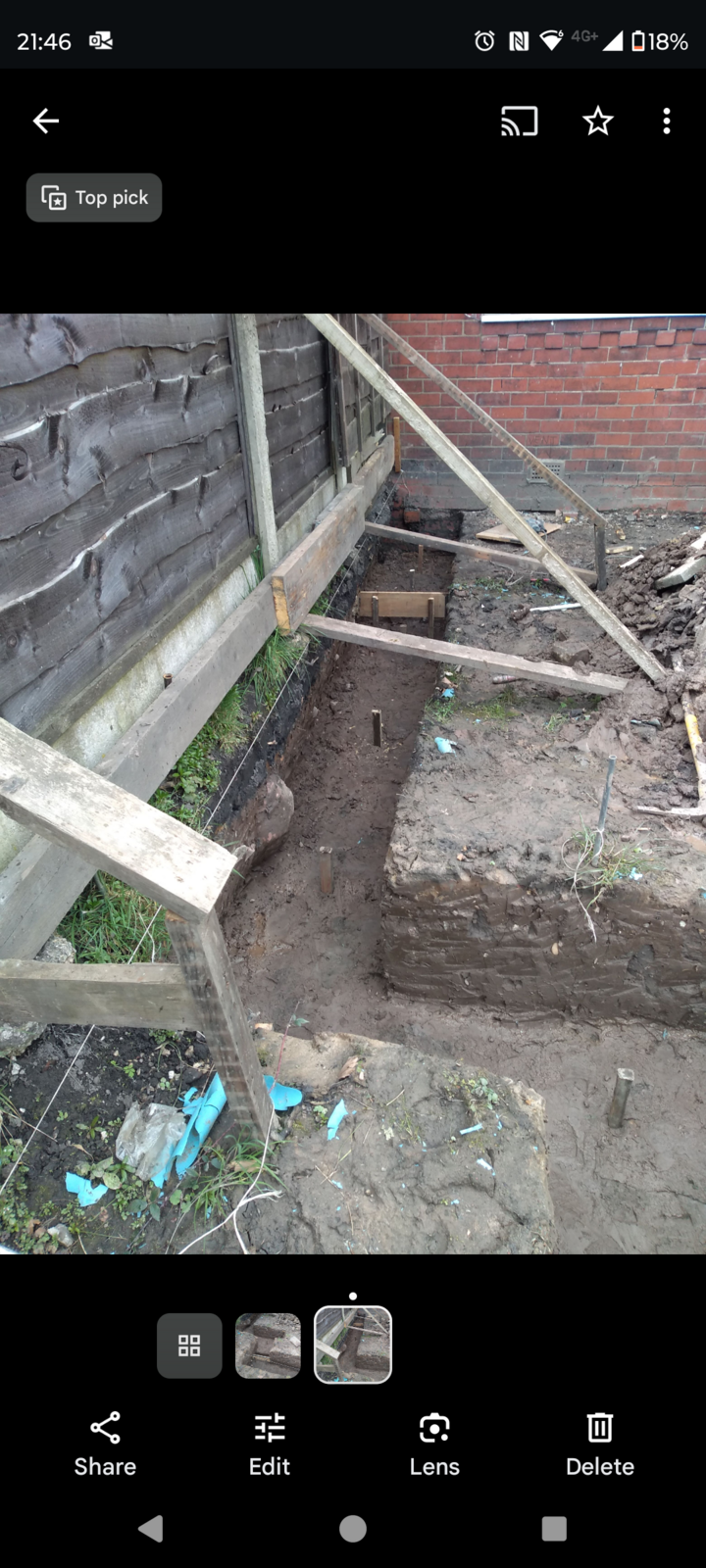

Also, there is an old foundation from an demolished extension that sits 350mm below the top of my formwork in one corner, however the top of the formwork is 100mm above grade on one side, so I'm only 250mm below grade on the lower side (Should say I am WELL below any organic layer and into healthy subgrade all around.
Critique of plans welcome as I've yet to install anything but the formwork frame.

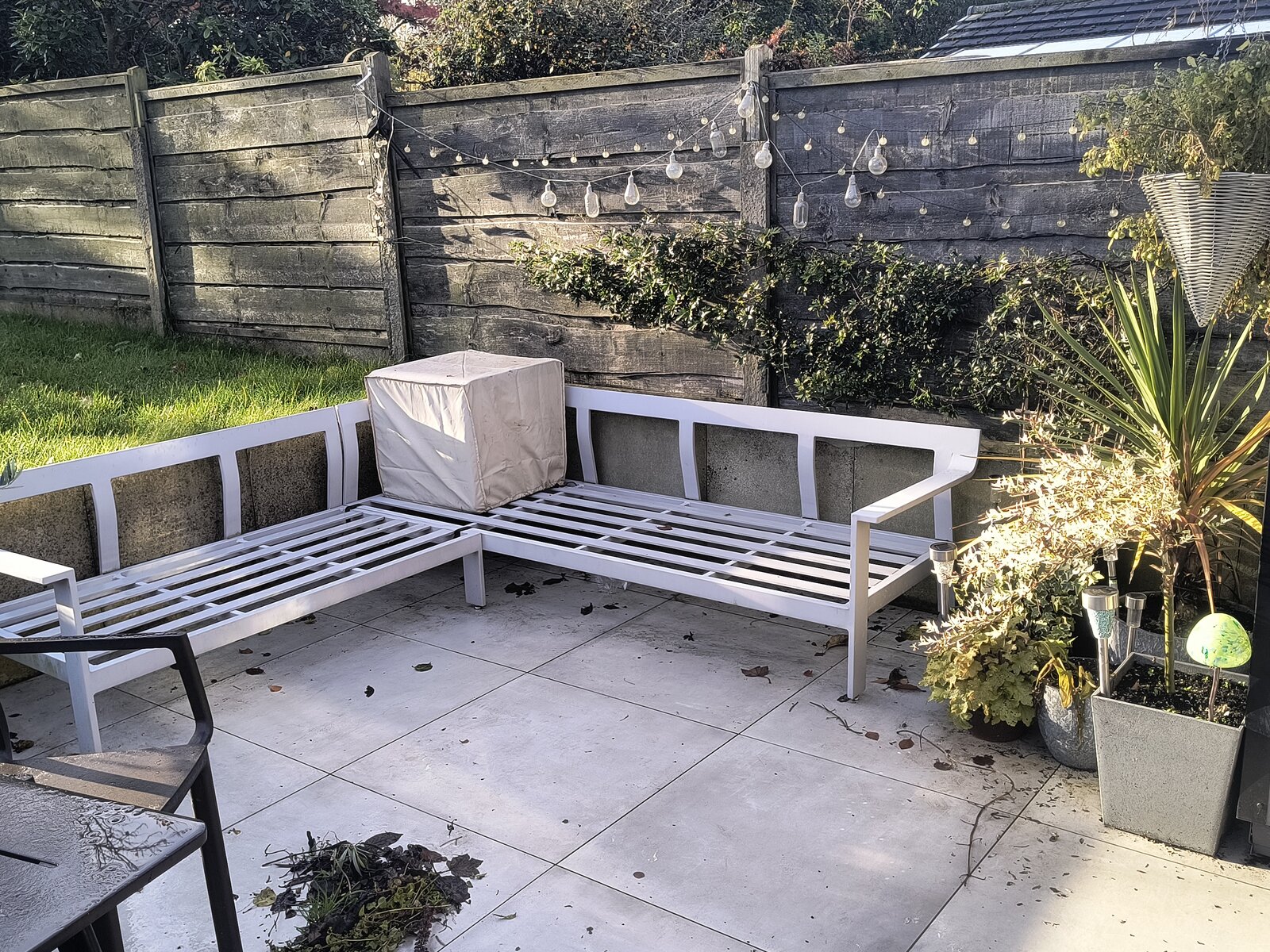

It looks fairly similar to my extension, I have dense clay (I think it's boulder clay given that it has boulders in it!) and had to build a bit below ground.
Just a bog standard strip foundation and slab, built slightly off centre of the slab to get as close to the boundary as possible. I have a cavity wall so was able to bring the dpm up inside the cavity.
If you look where the wheelbarrow is in the first picture, that's now the patio - 600mm of ground behind is happily retaining by vertical paving slabs set in concrete.

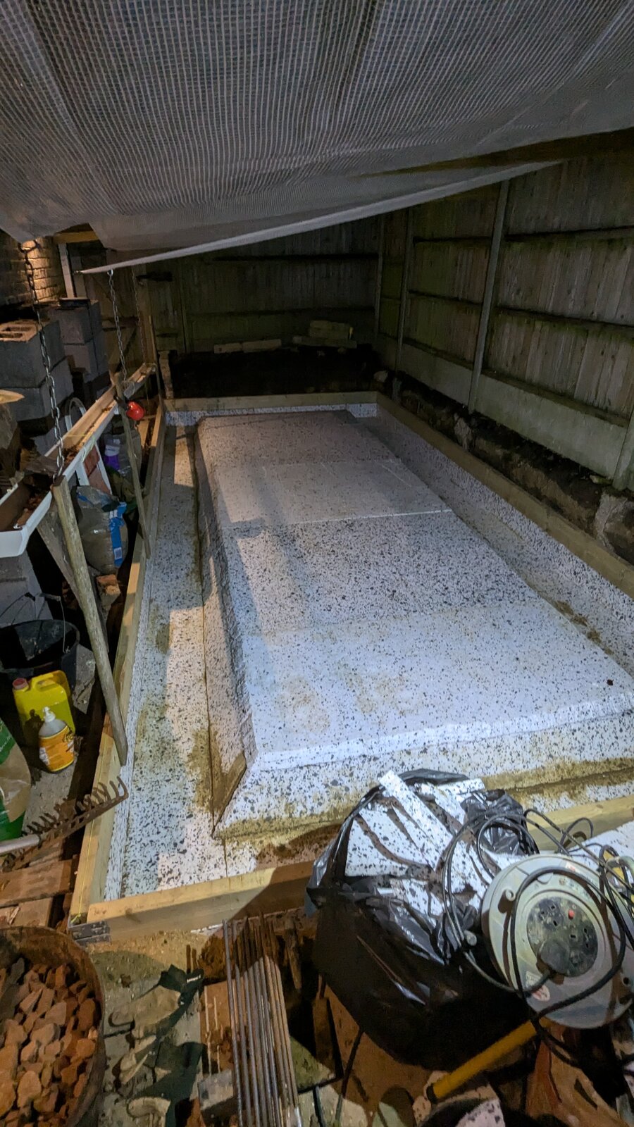

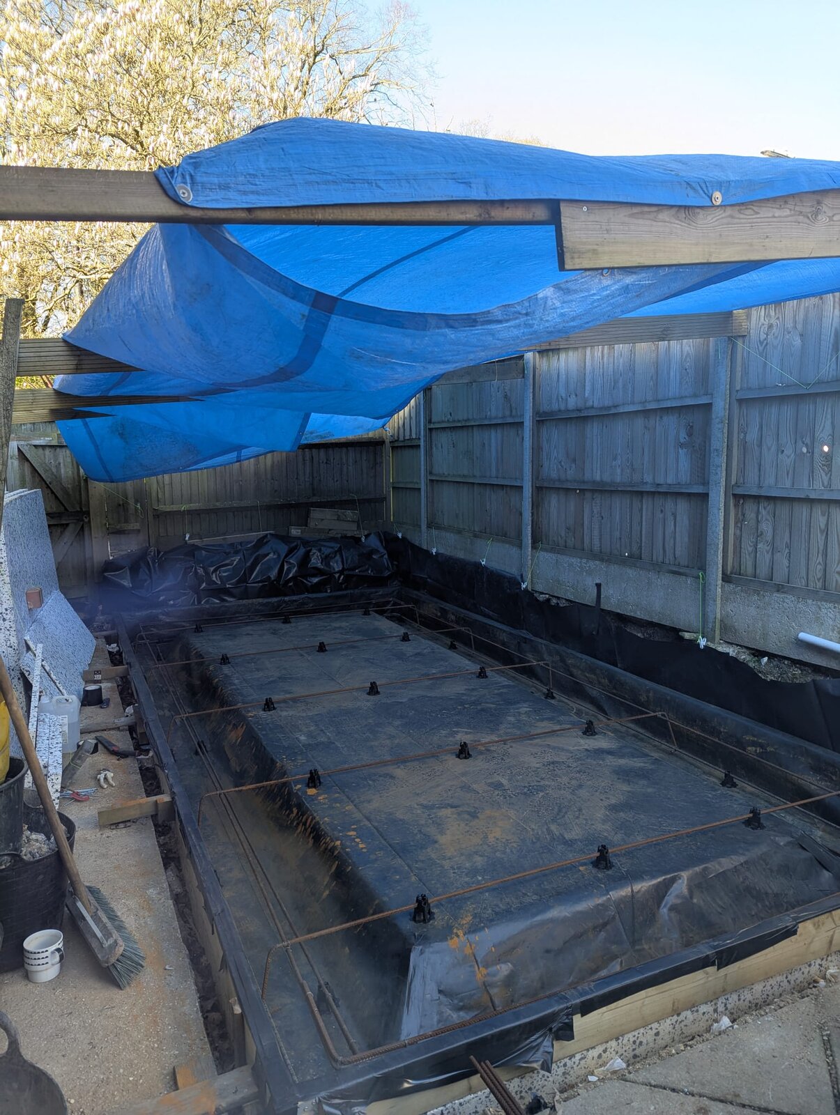

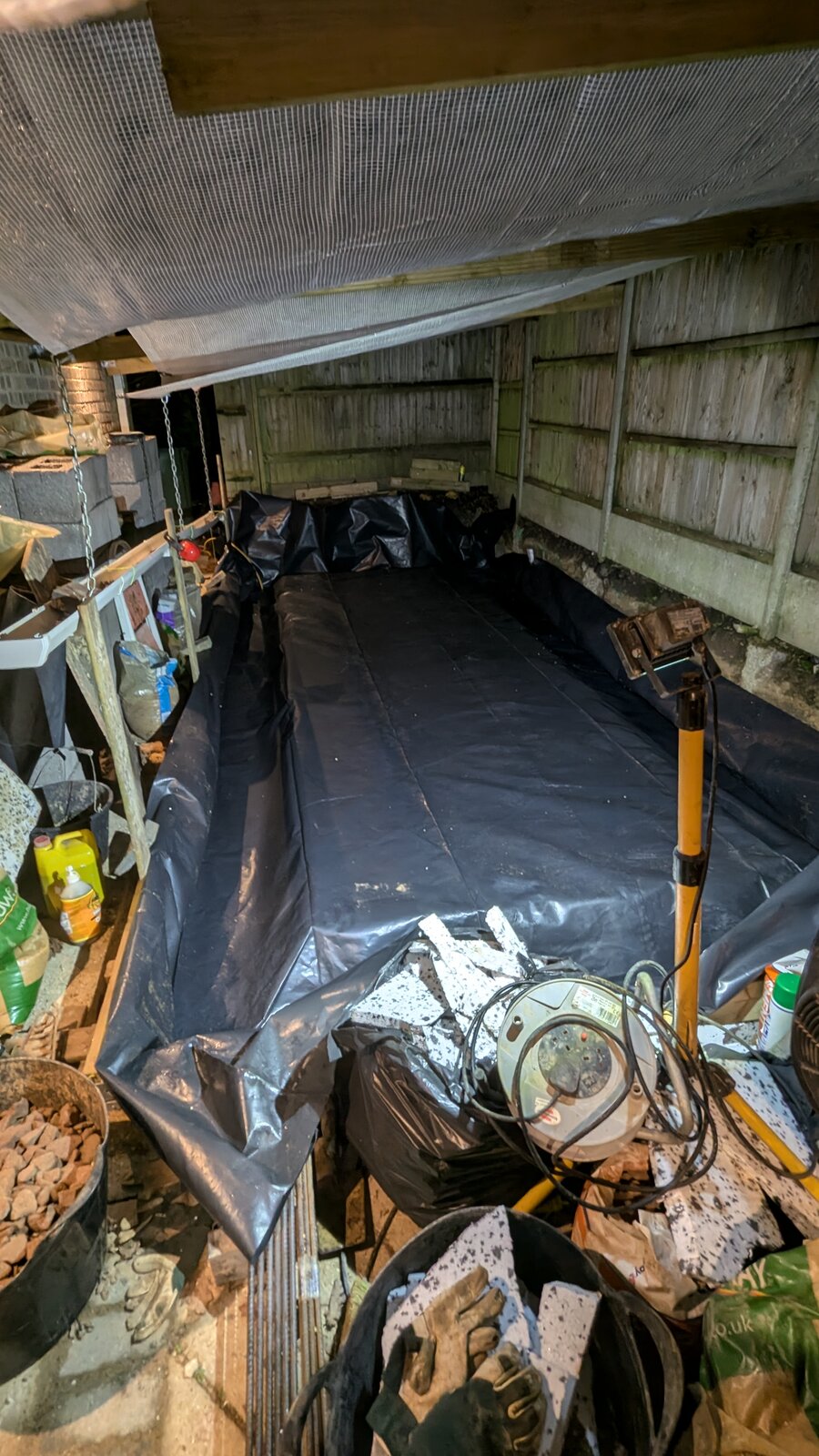

Insulation finished
first DPM going in
Stepping away from the project for a couple of weeks, so have filled the DPM with water to weigh down EPS and support the sides.
Need to do a tidy when back. I am so glad the digging is over. It's easily been 5 years on and off
Come a looong way from where it was...

Cover up the soil banks, tape the membrain and basically back to where I was end of last year.

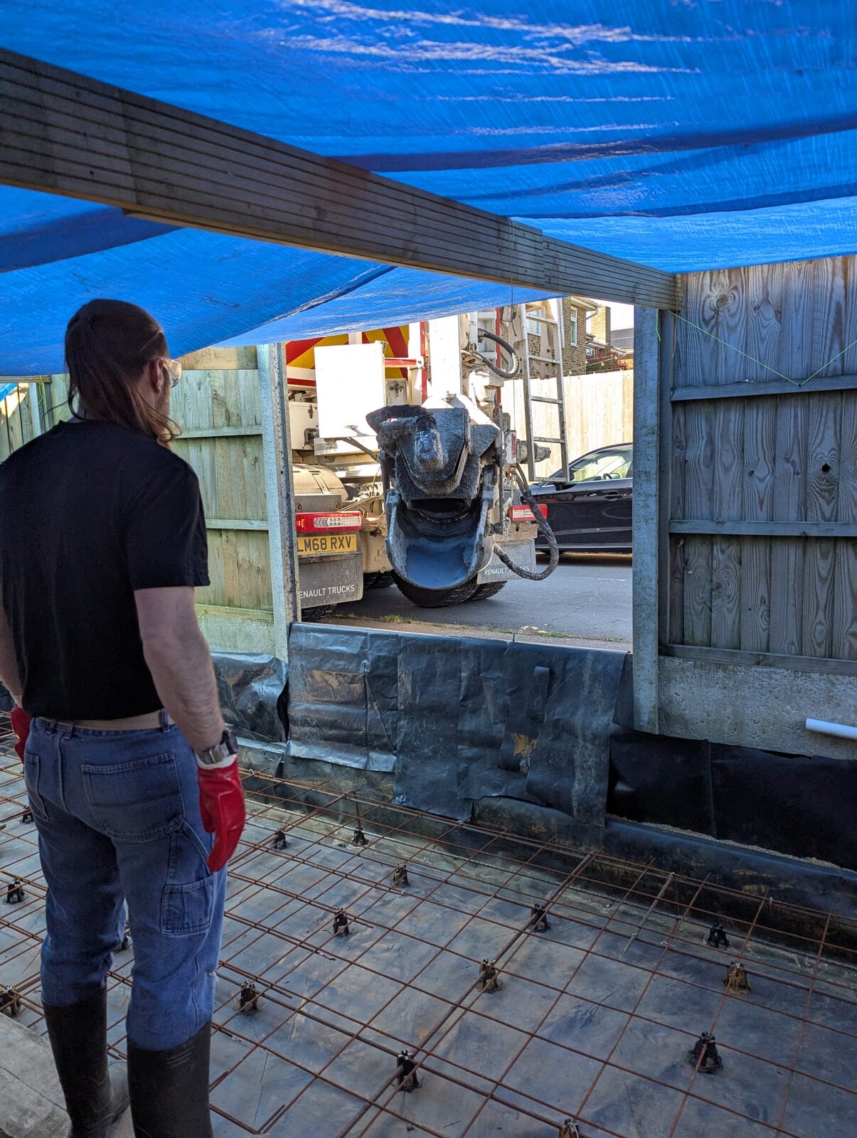

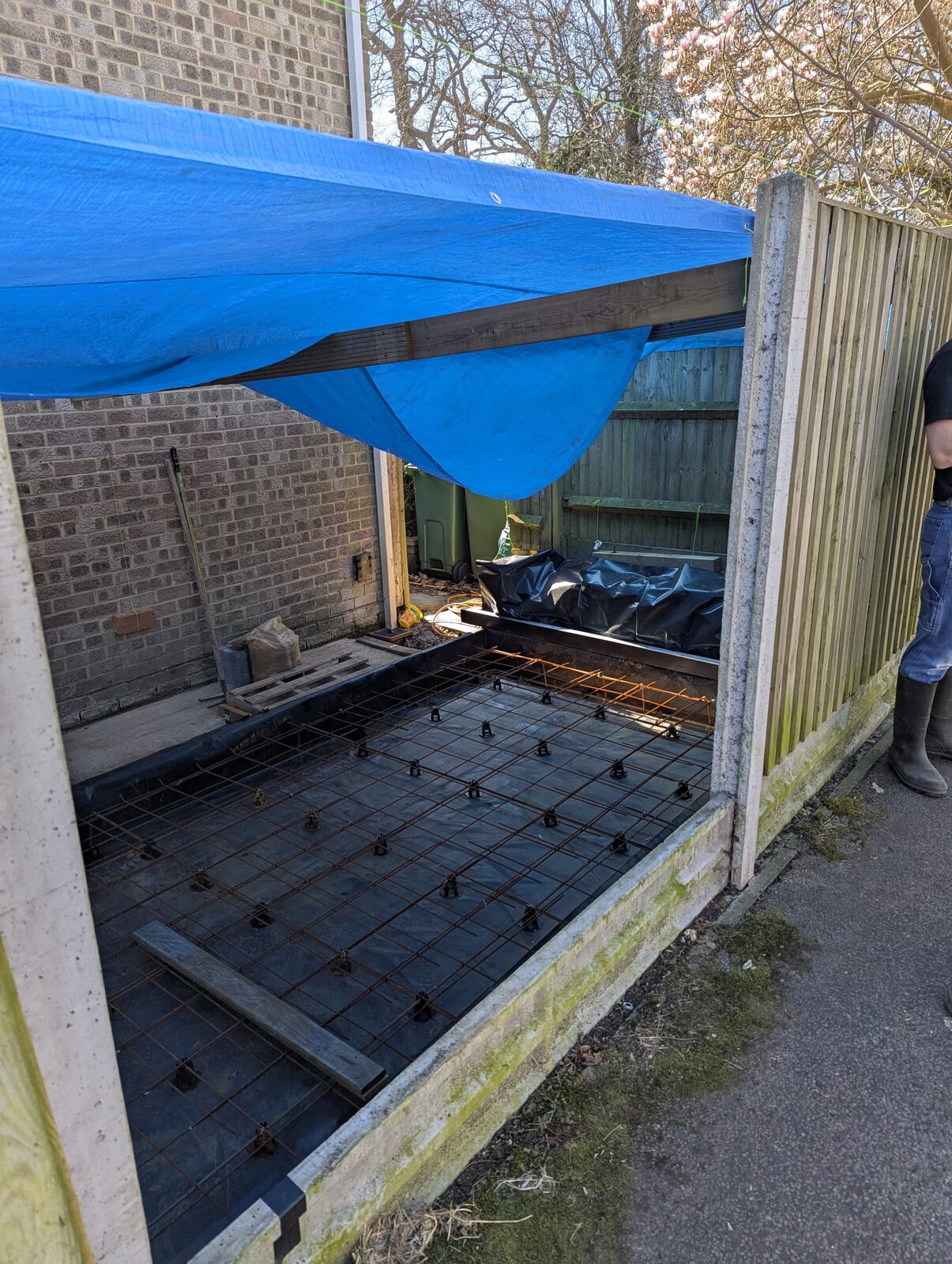

Then it's time for some HEAVY METAL!!!!

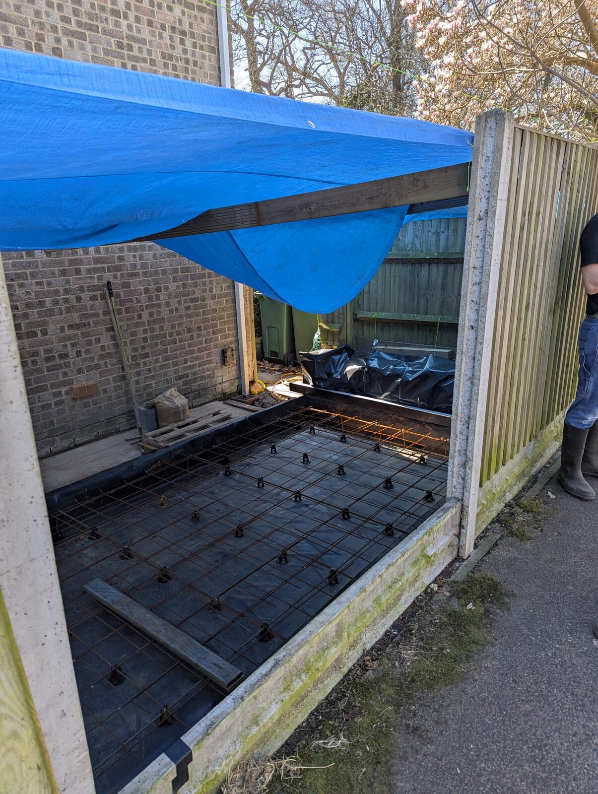

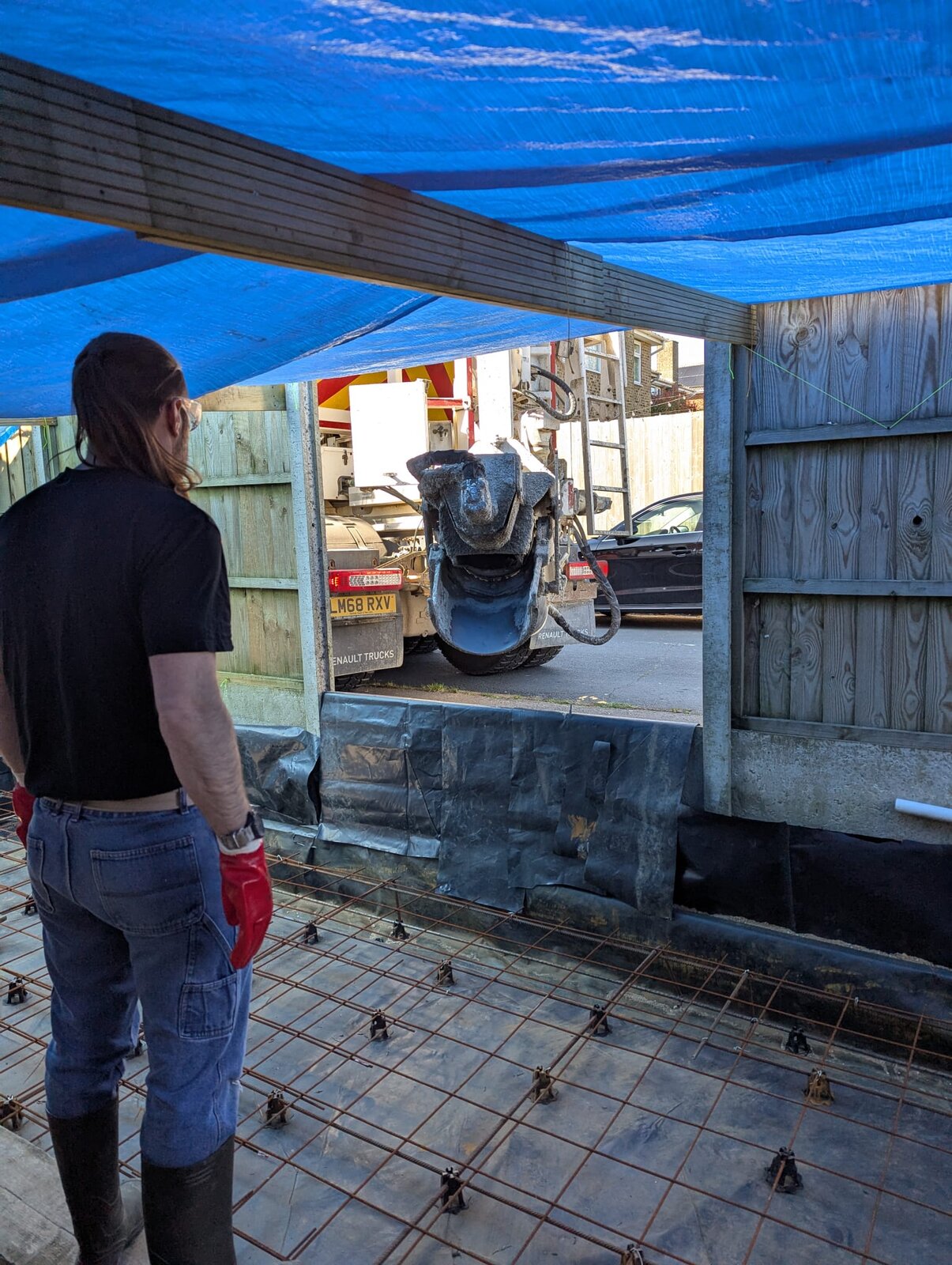

Going to finish up rebar tomorrow, few more 10mm bars along the length and mesh.
Got the vibrator (hehe) on order and the float to hire

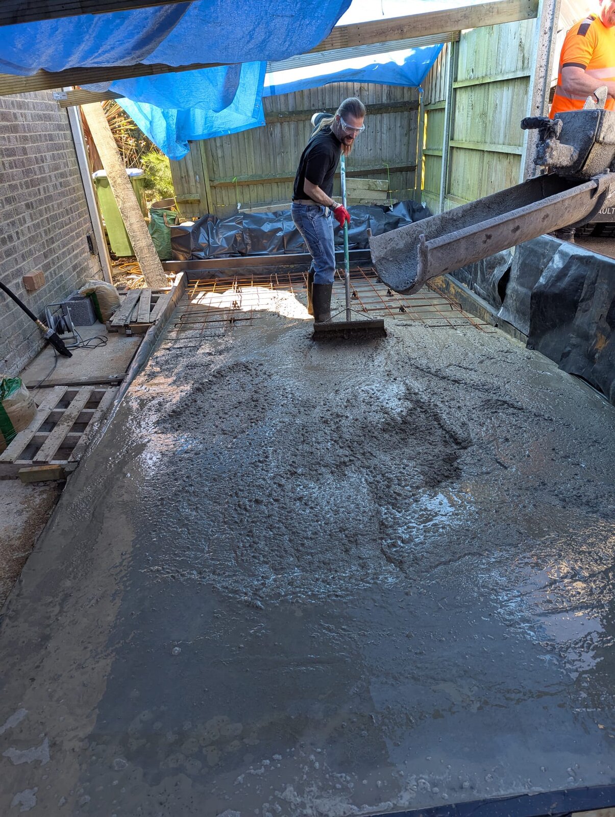

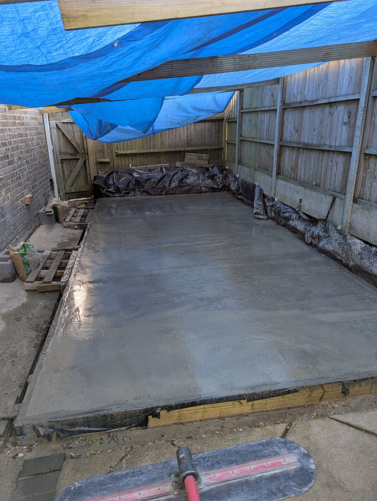

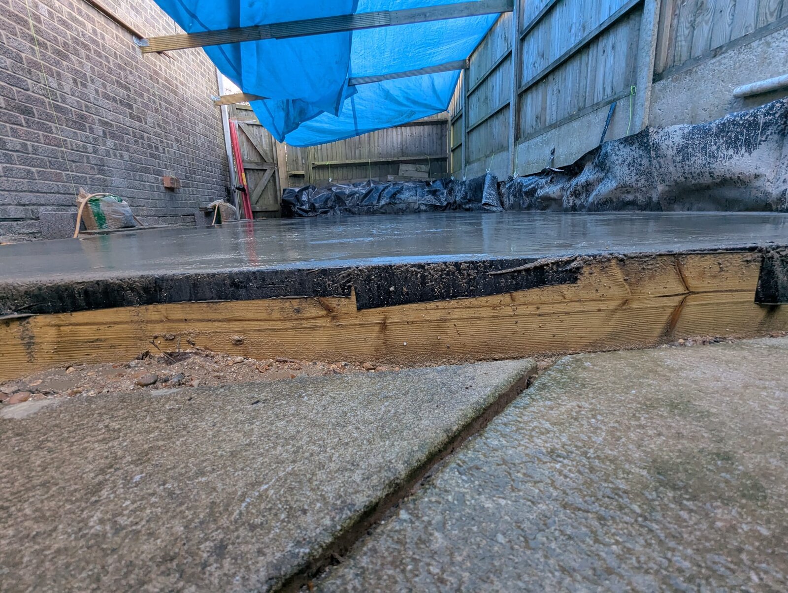

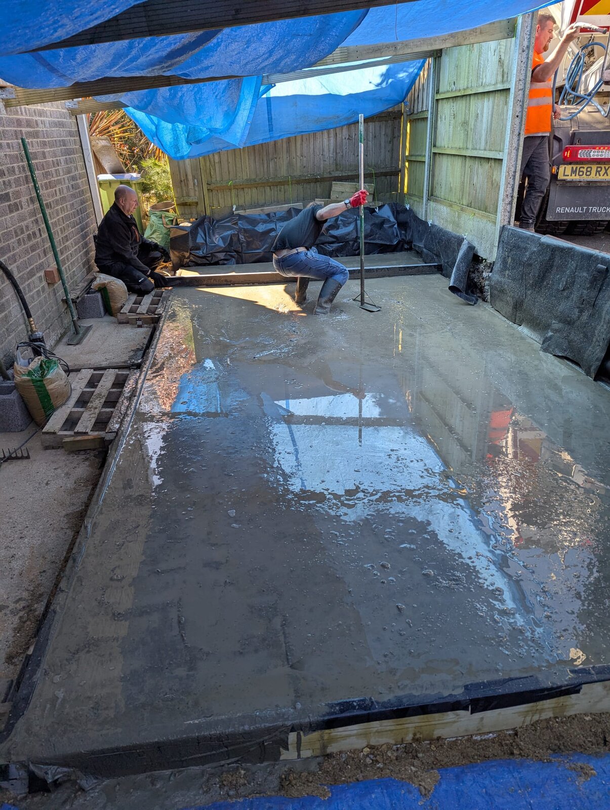

Thursday going for the pour. Wish me luck.

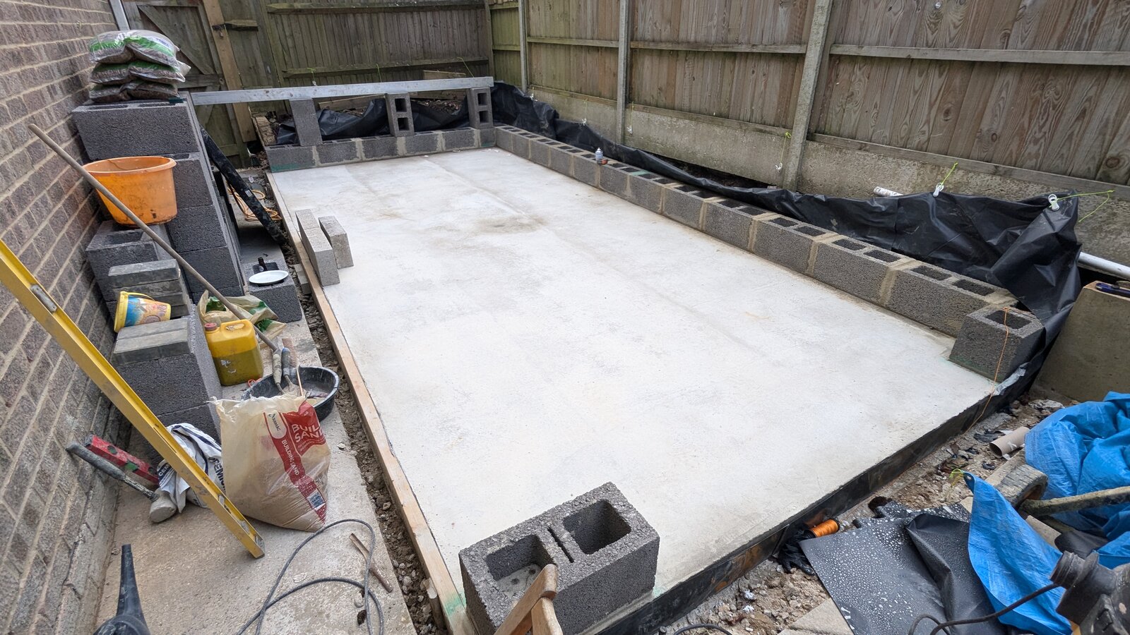

Looks good. Very similar to how I built mine. I didn't bother with fancy bent corners in the rebar, I just overlapped the ends to form a cross, but it's been fine for over 10 years now.
My pour did not go that well. It took two trucks and there was a long delay between them on a very hot day. Just about got the second pour in time. The surface had a few ripples in it. I'm sure a professional would've done a lot better but I'm happy with it.

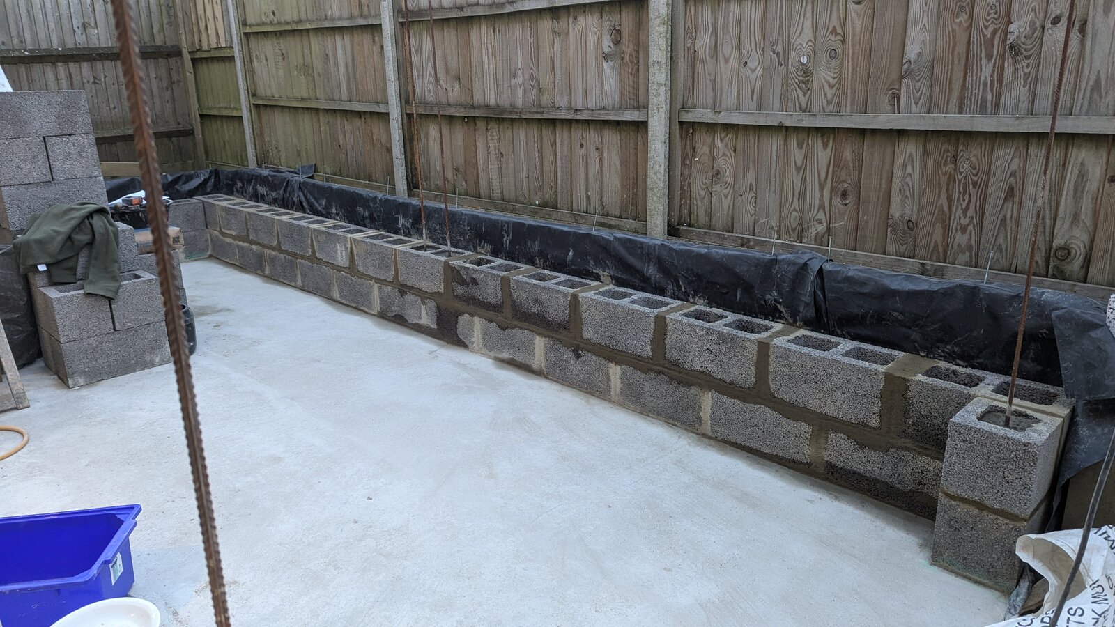

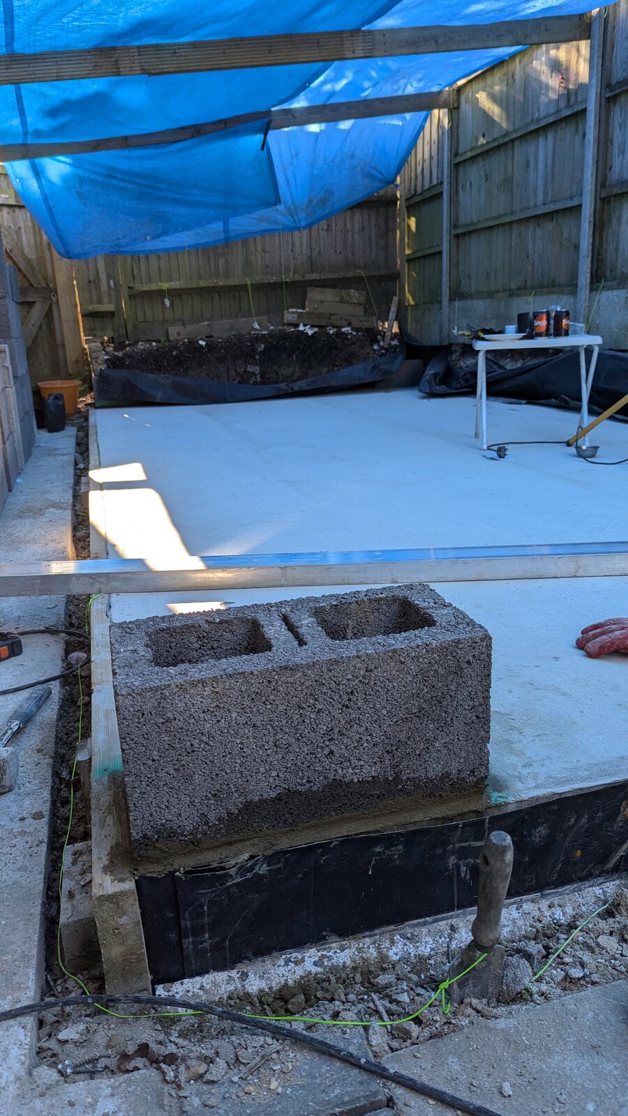

Block by block. Brick by brick... up we go.
That's the hardest ones done now.

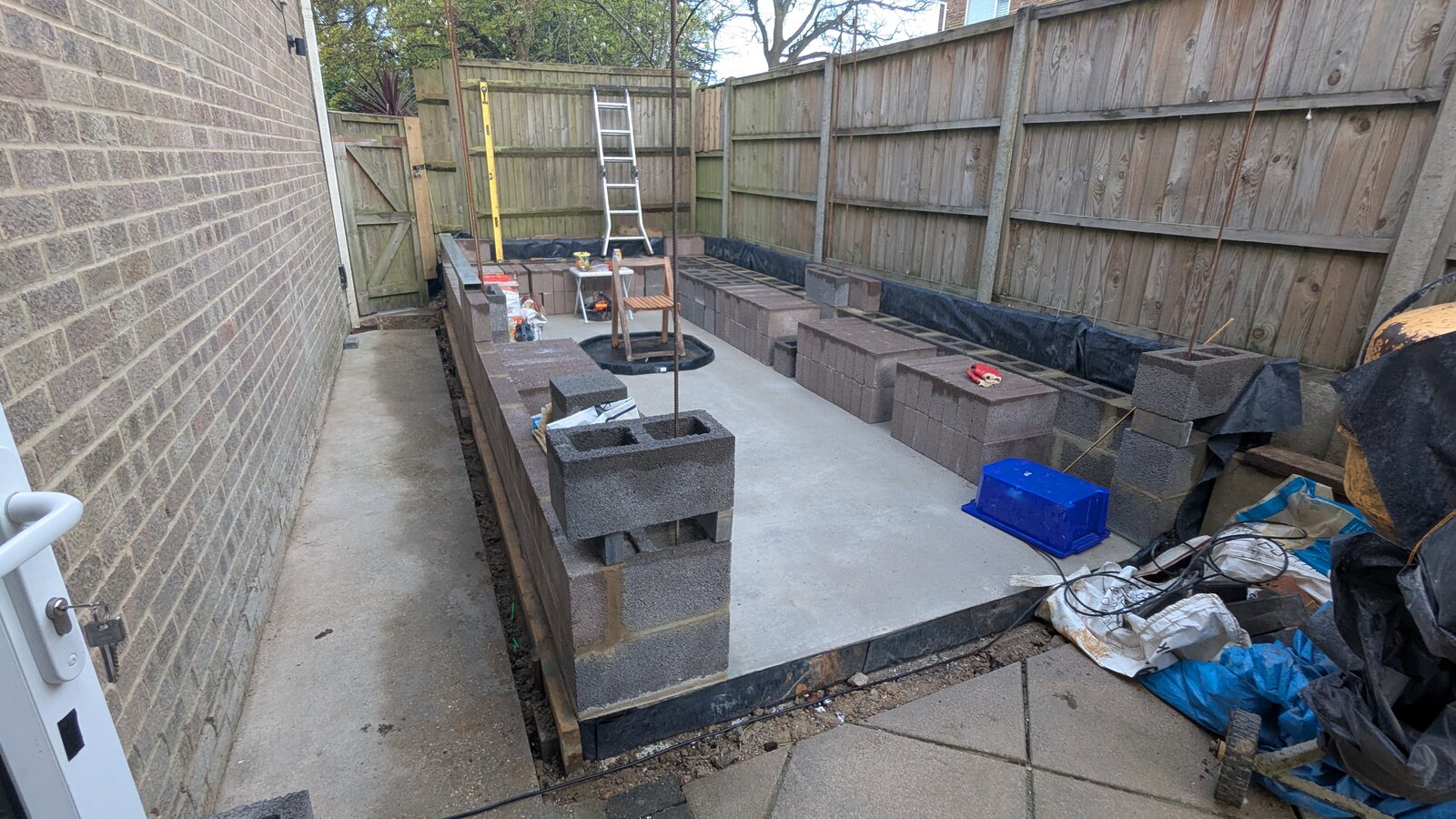

Bit annoyed, there was a bit of grit on a block so I'm almost 3mm out of level over 6m
I'm toying with the idea of looping pipes through the dense concrete blocks prior to filling them so I can use it as a solar heat battery (pipes to solar on the roof). But seems far too much effort.
What I will do is add holes to my mid-wall pillars so I don't have to take services around them, taking up precious space.
It's slow going. I can manage about 4-6 blocks of an evening, though it's speeding up as technique improves.

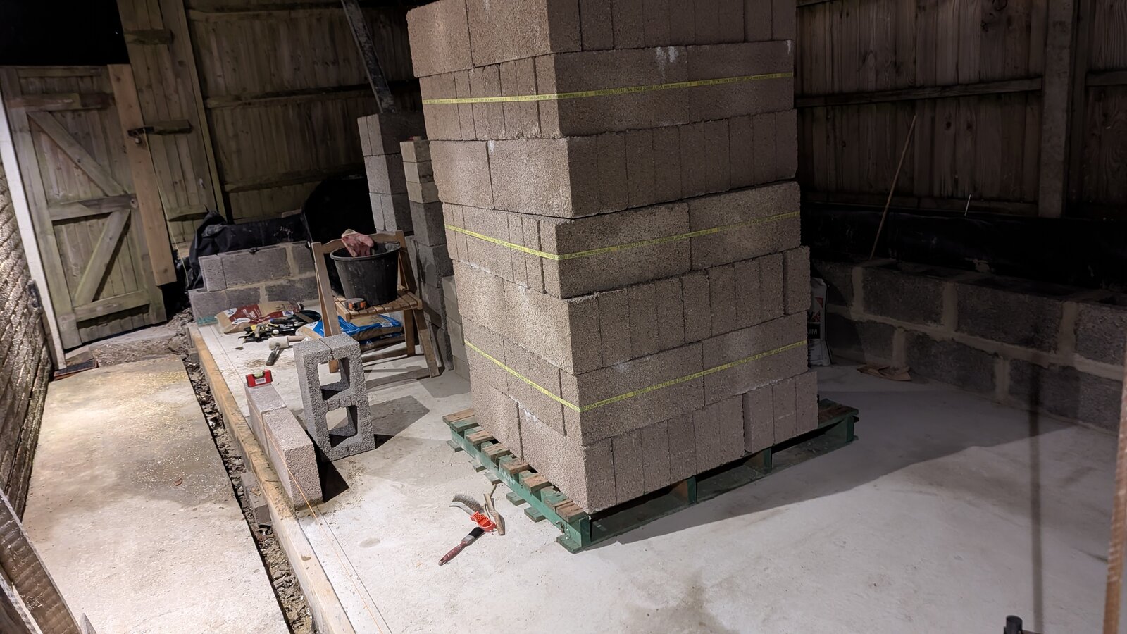

Got blocks. Will lay.
I'll admit, I ran the quantities on how many I need and was not expecting over 5 pallets worth. Genuinely didn't realise how many bricks/blocks are needed to build a building. This is the first of 3 loads.
Have the first two down on the lefthand wall. Want to have the walls started all the way around before the rain hits.
