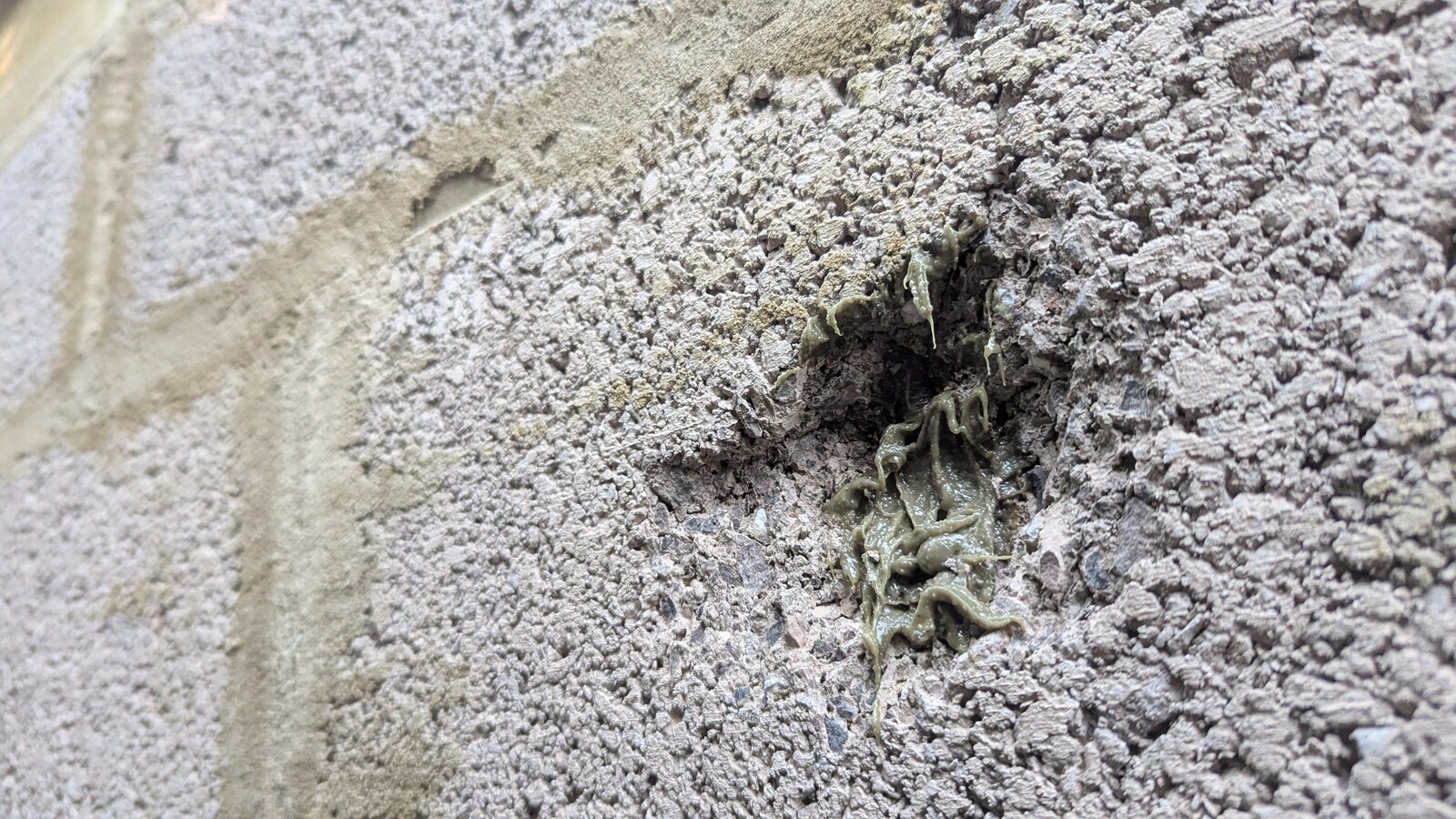

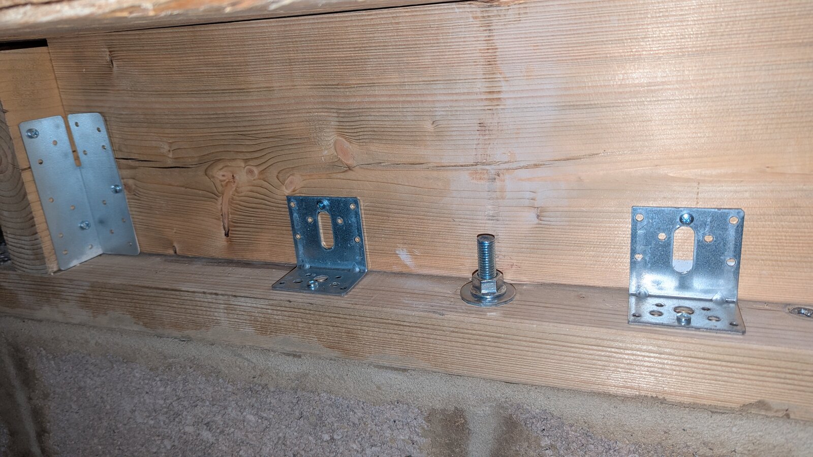

I don't want wall straps coming down inside this, so am opting for long ass M12 studs down through a couple of course.
Tried using the capsule first, big mistake going against manufactures product suite (don't do 500mm long studs). Ended up injecting general building resin into the holes after a good clean out (giggedy?).
(Yes I know it's in the mortar bed, but not in the block below it which is where it matters)
Errrrrrr. Edit. I did the other 9 and.... Turns out hydraulic action applies to resin as well :(
Learning curve
1) 12mm stud doesn't need 12mm holes, needs 14-15.
2) resin fun. Hehe.

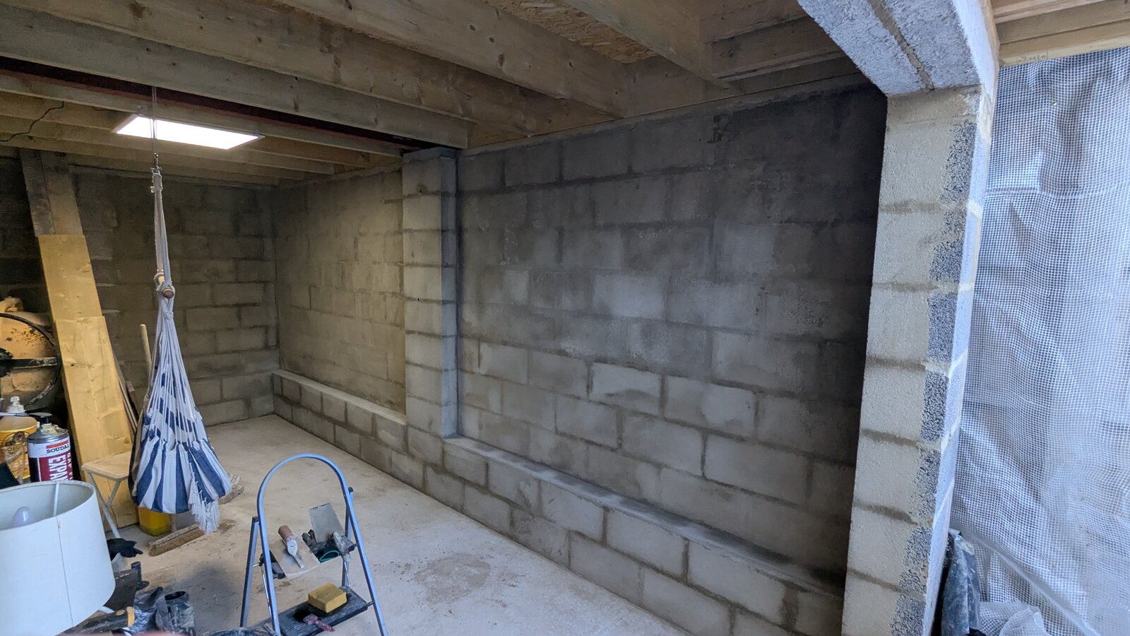

Well, it's been a while, but I've got it waterproof, albeit only with the roofs VCL and tarps.

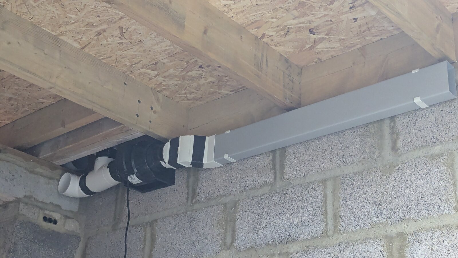

In preparation for being able to keep it from going musty in the wet weather, I have started on the ventilation.

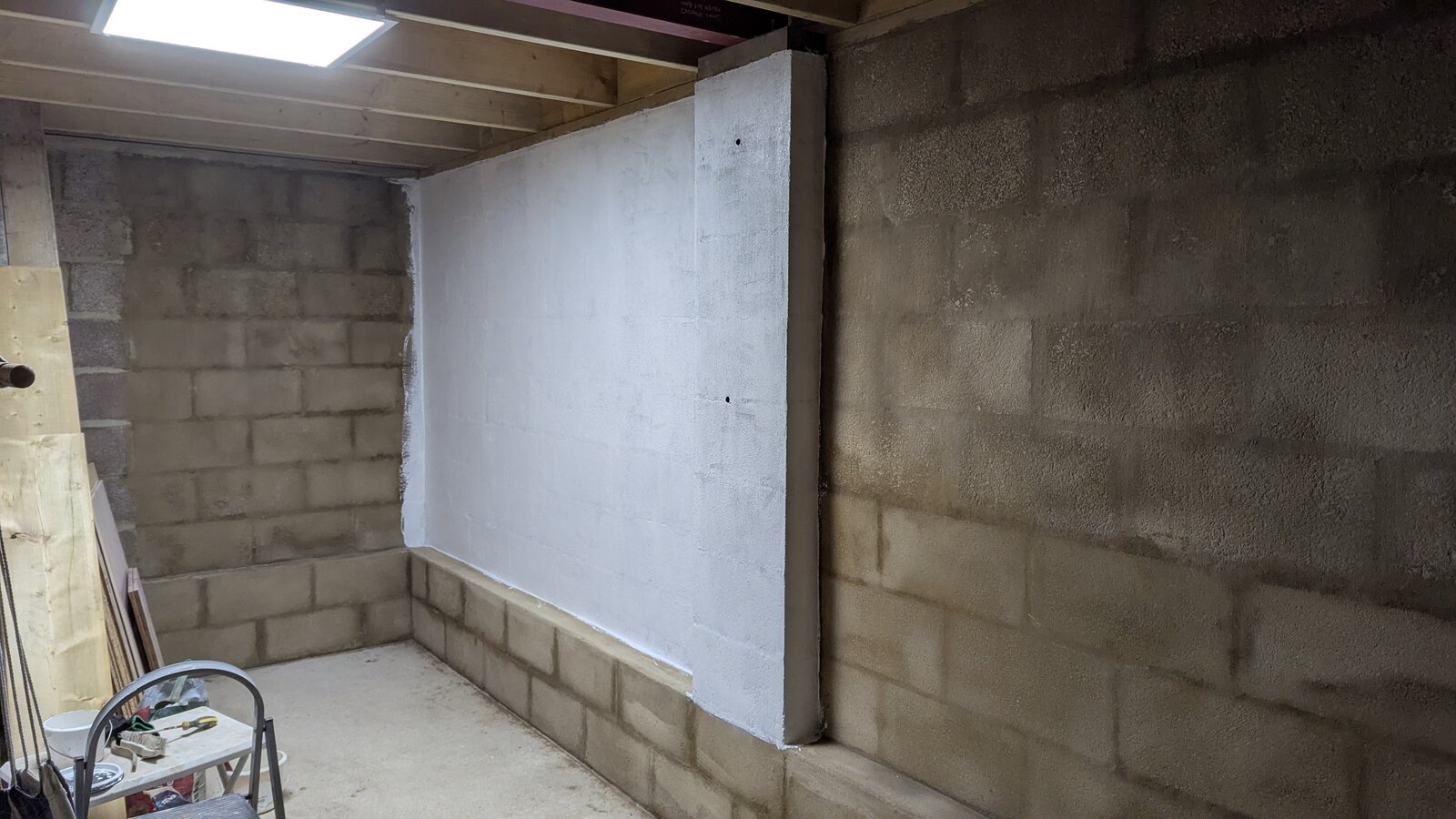

Going to template out where I want it all to run, then slurry and paint the walls before final install.

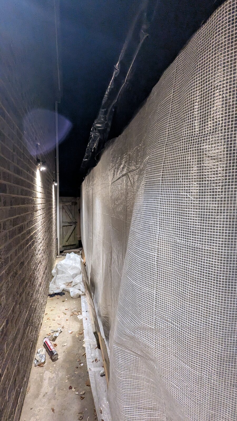

Thank Andy... But the outside is still a long way off. I've got to survive the winter with tarps and DPM sheets while I do the inside and get power. Then come spring, EWI, render and roof.
But! It is getting there

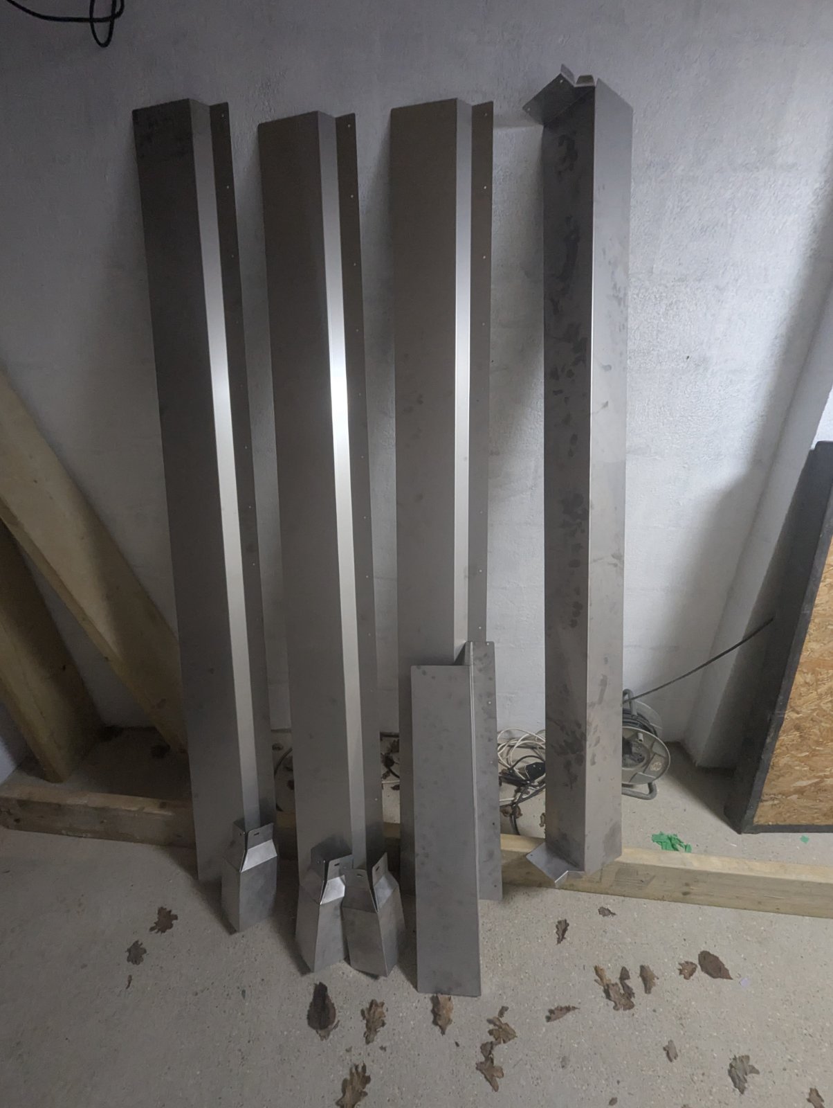

Hibernation complete, it's still dry, still there and I now have the first order of custom metal skirt in.
£190. Time to enjoy the sunny British weather and get it fitted and hope it works.

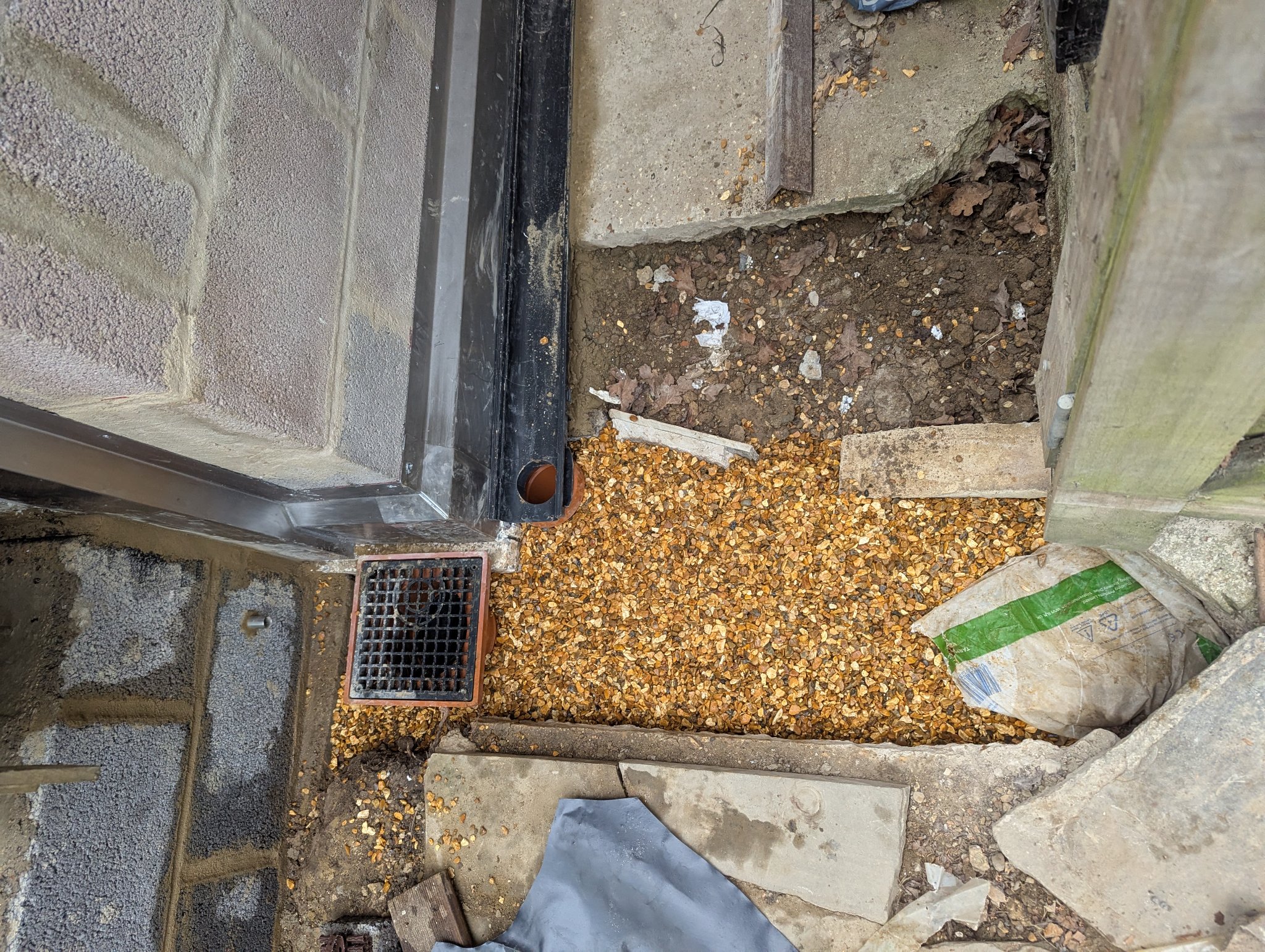

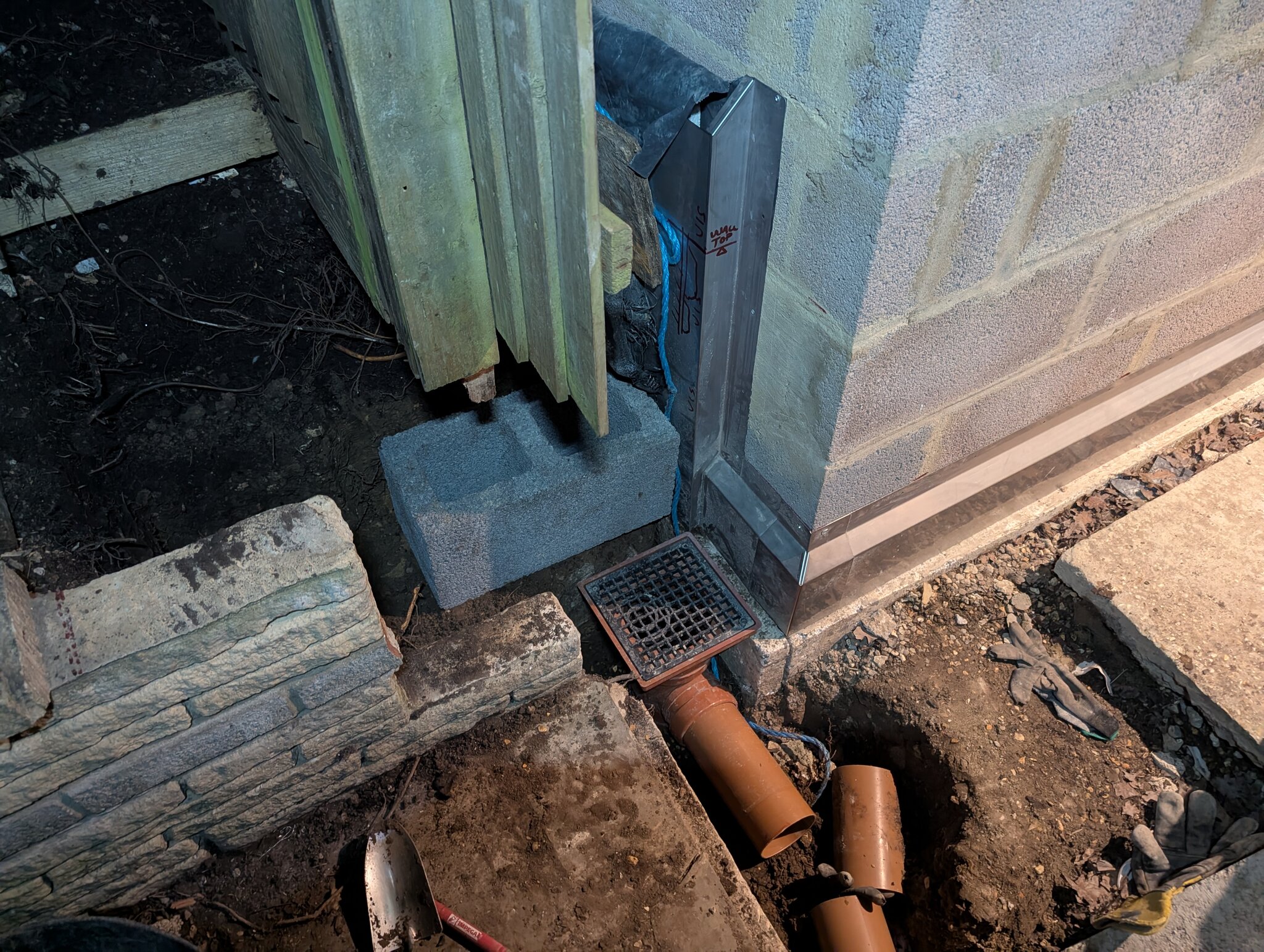

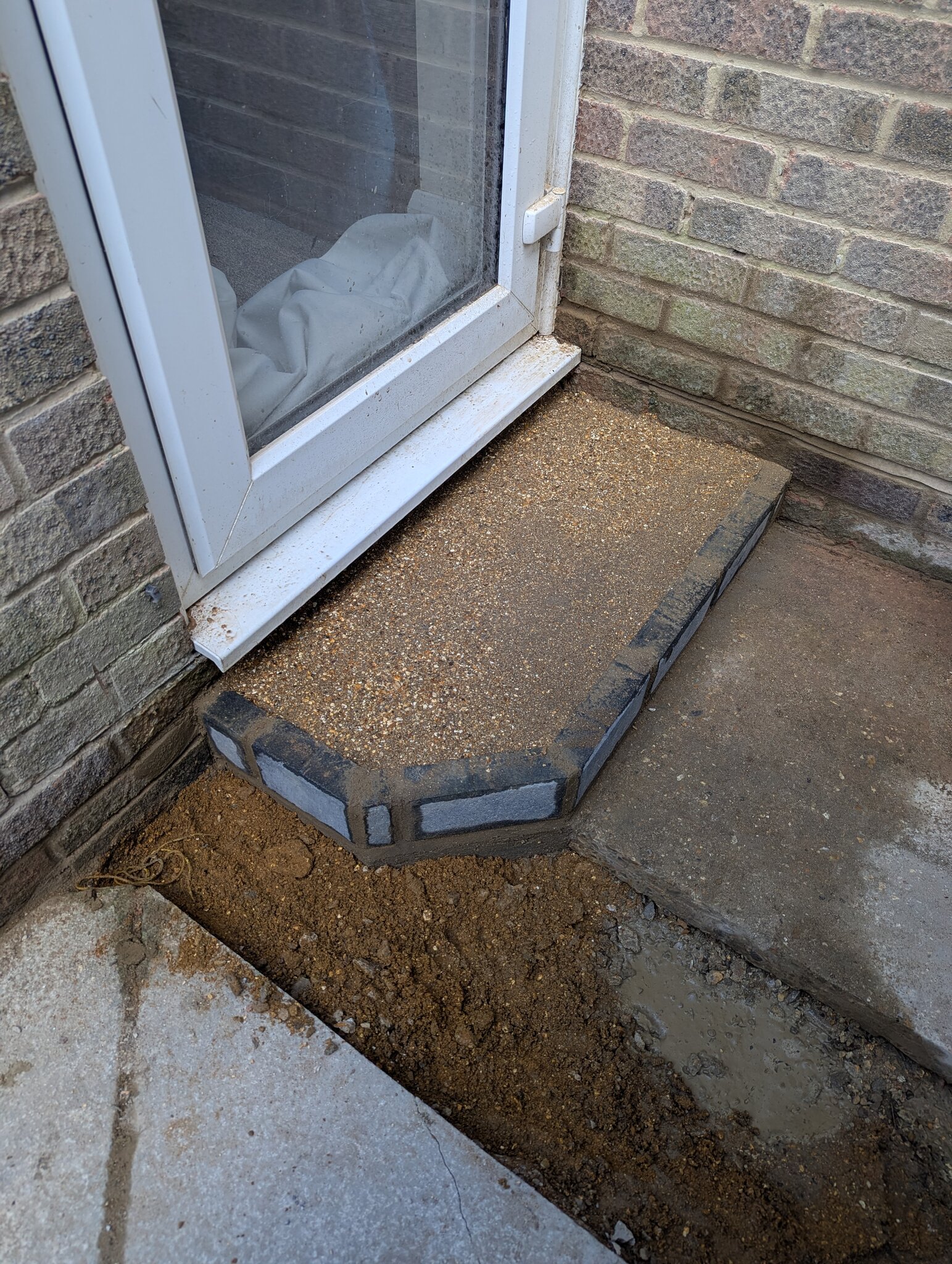

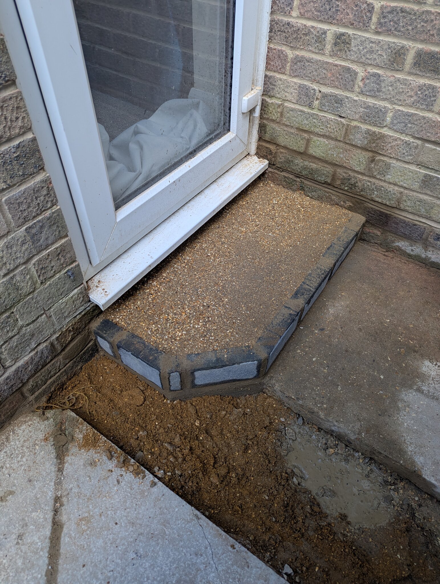

I have a whole path again (and a new, suitable retaining wall)

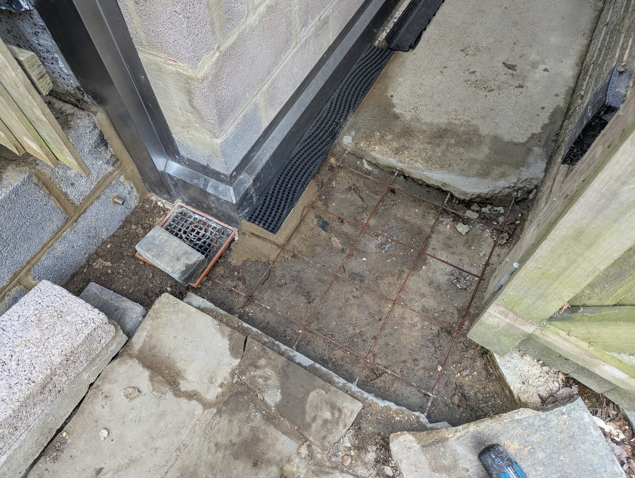

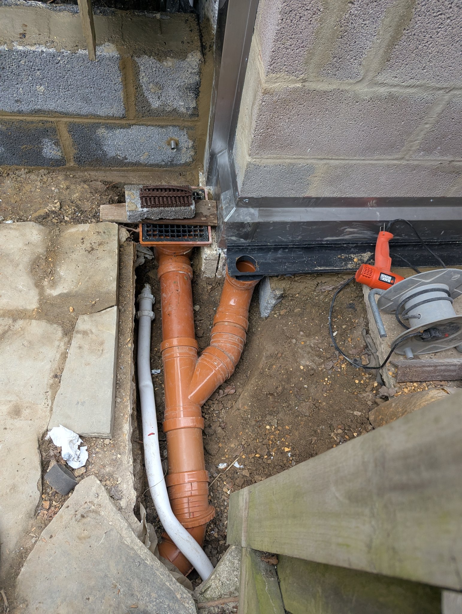

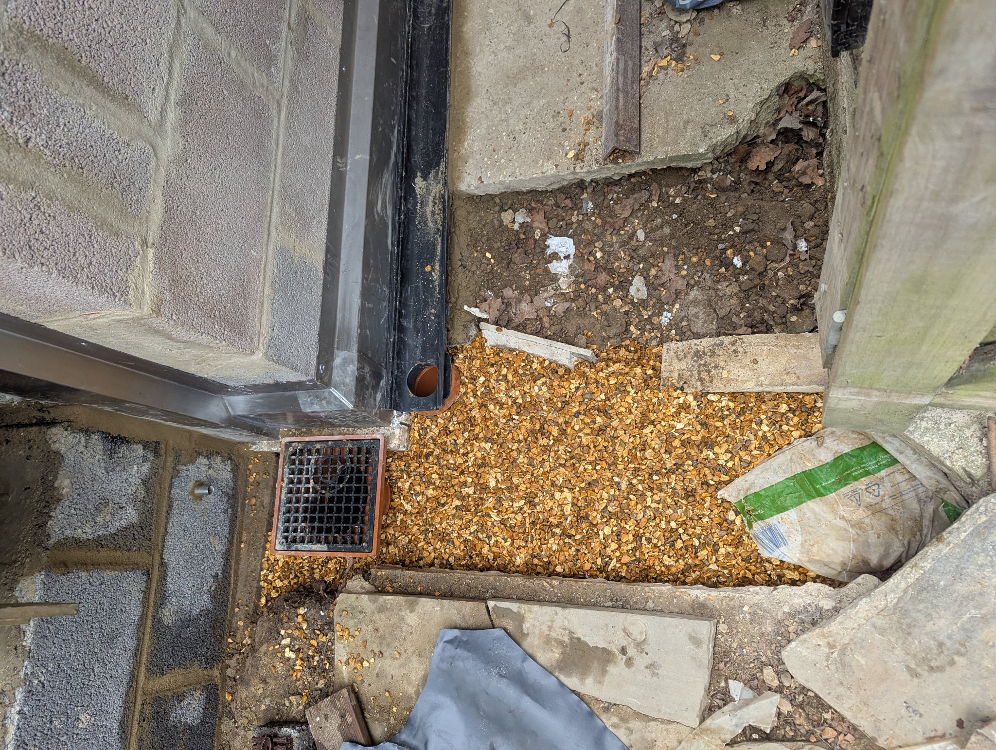

It started with the first bit of channel and gully for the gutter. Also, long heat formed pipe to thread SWA through.
Then gravel
I then added a layer of DPM and soil on top to aid in removal when I eventually get around to the front garden in full

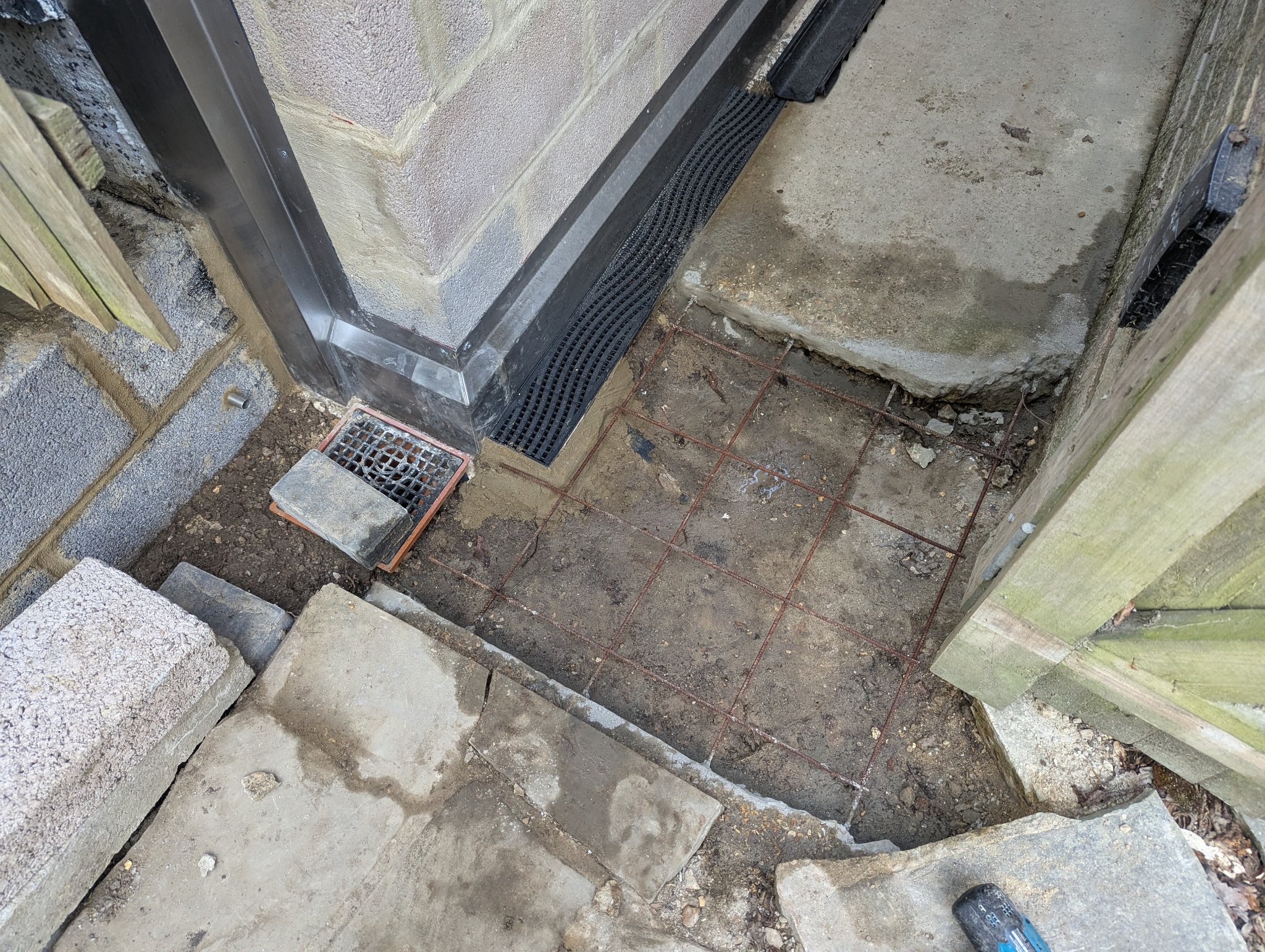

But that said, I didn't want the replacement patio to move... Also happened to have some spare rebar mesh.

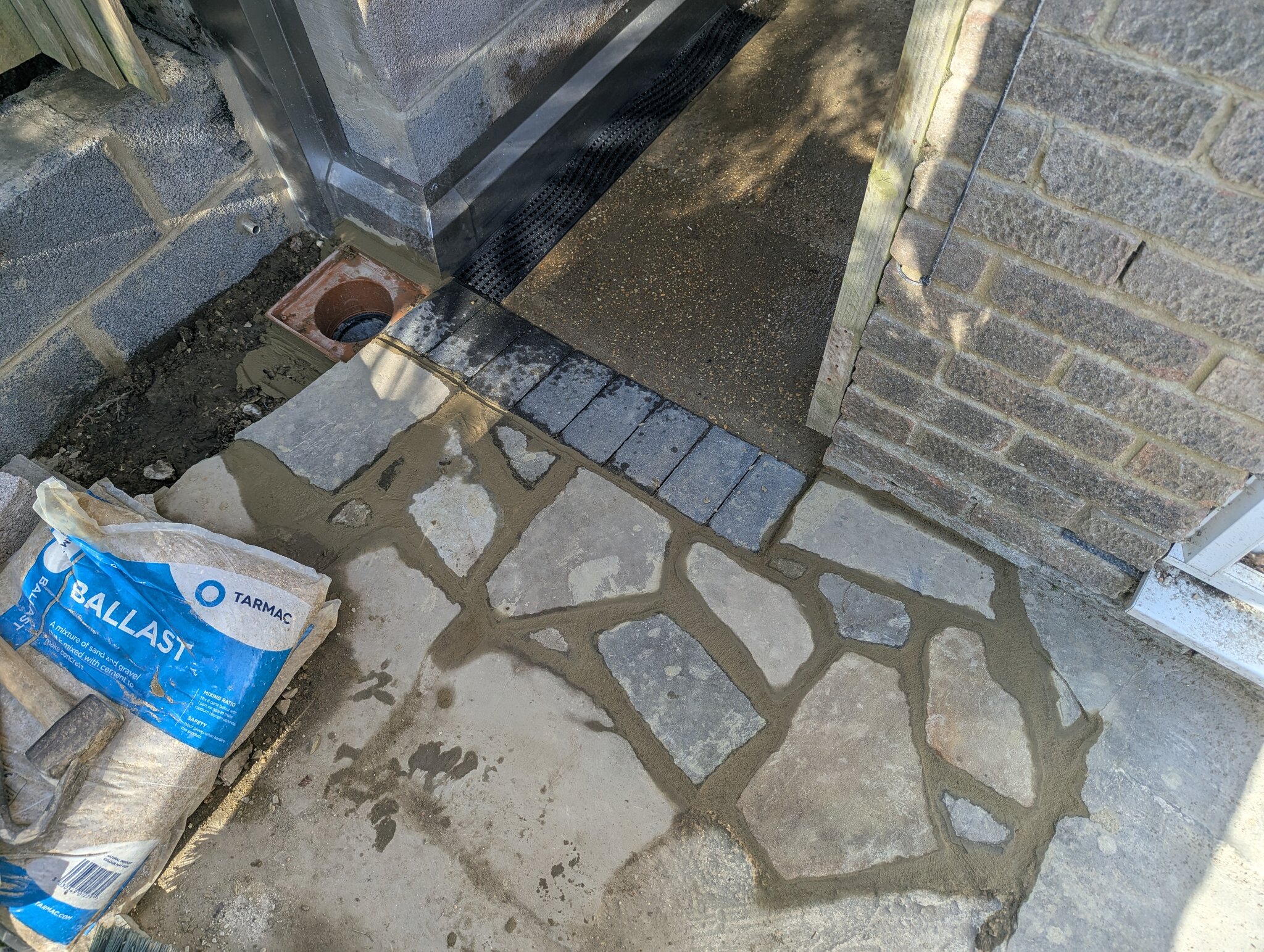

The. Divide off the end of the alley and patch in:
Then some bricks and a re-lay of some crazy paving and we're done (minus just Infront of the retaining wall. Will probably go gravel for now

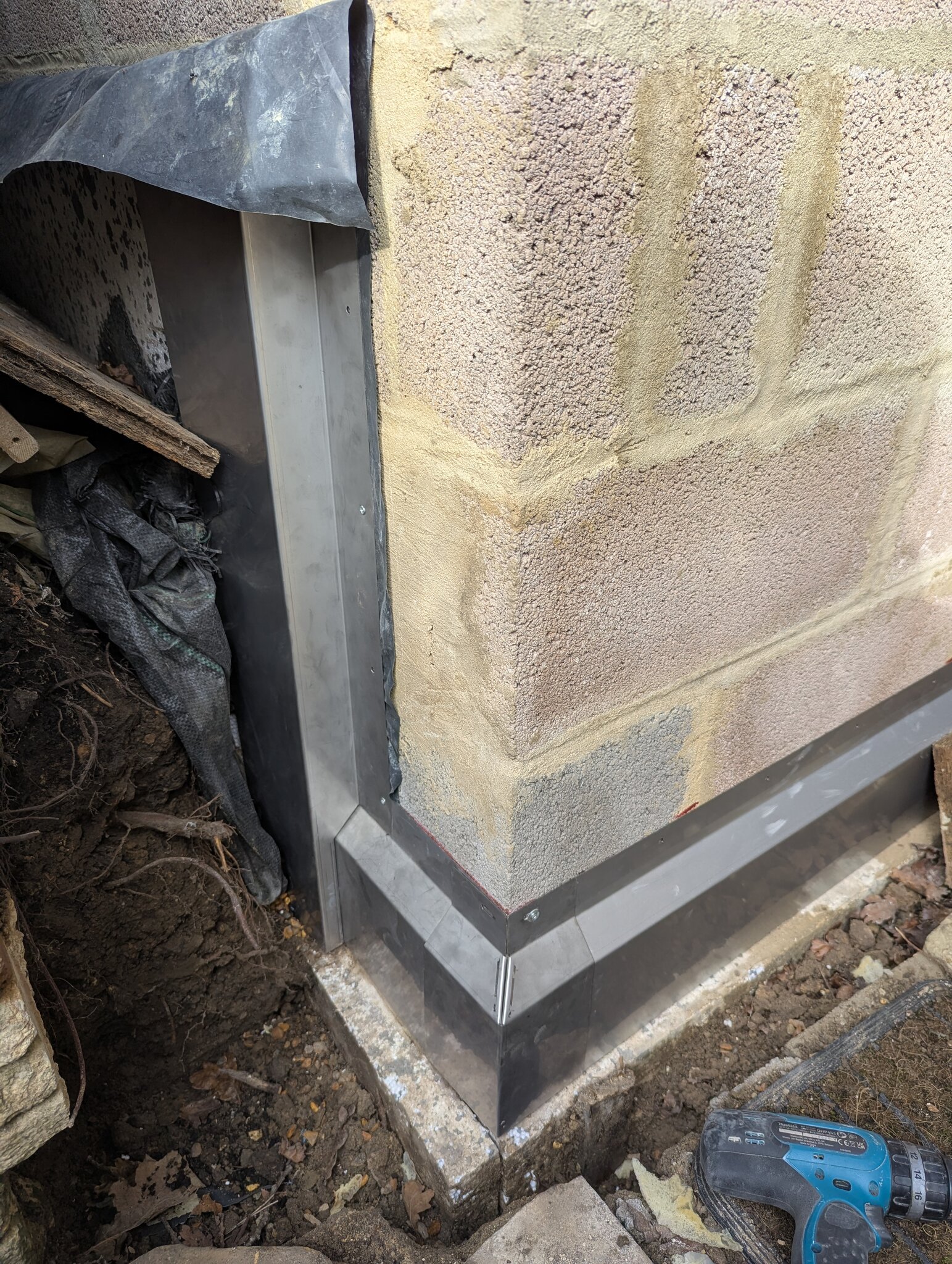

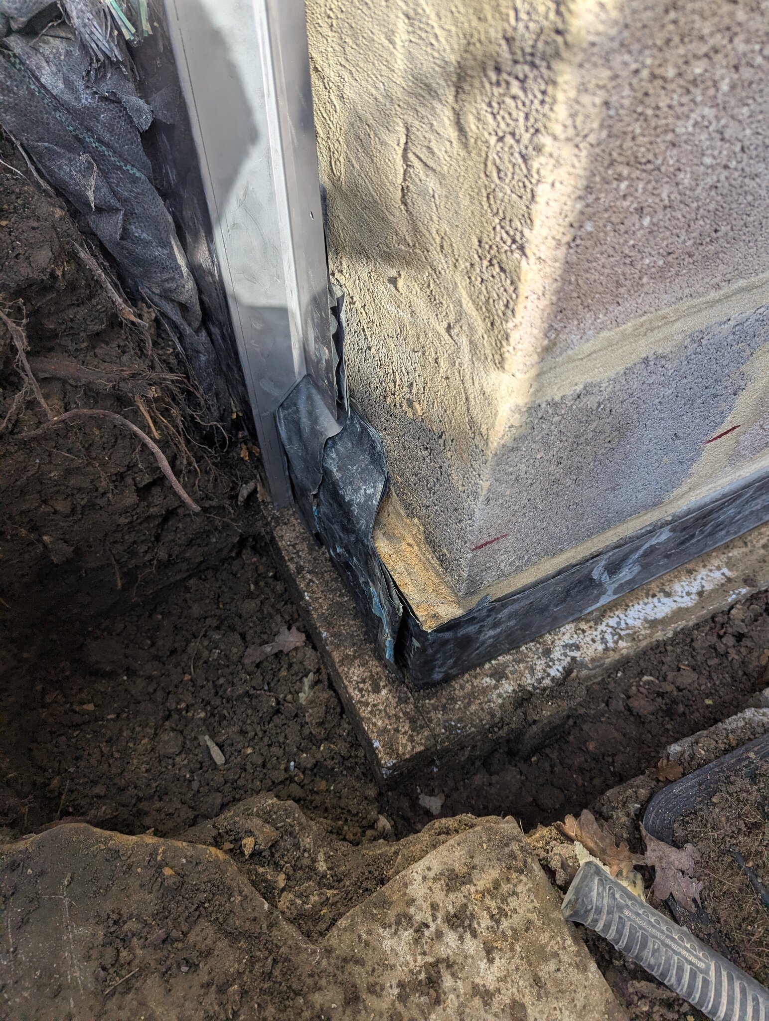

Also, all the stainless is properly mounted - am happy with how that's turning out and the edge for the render looks like it's going to work
Progress!

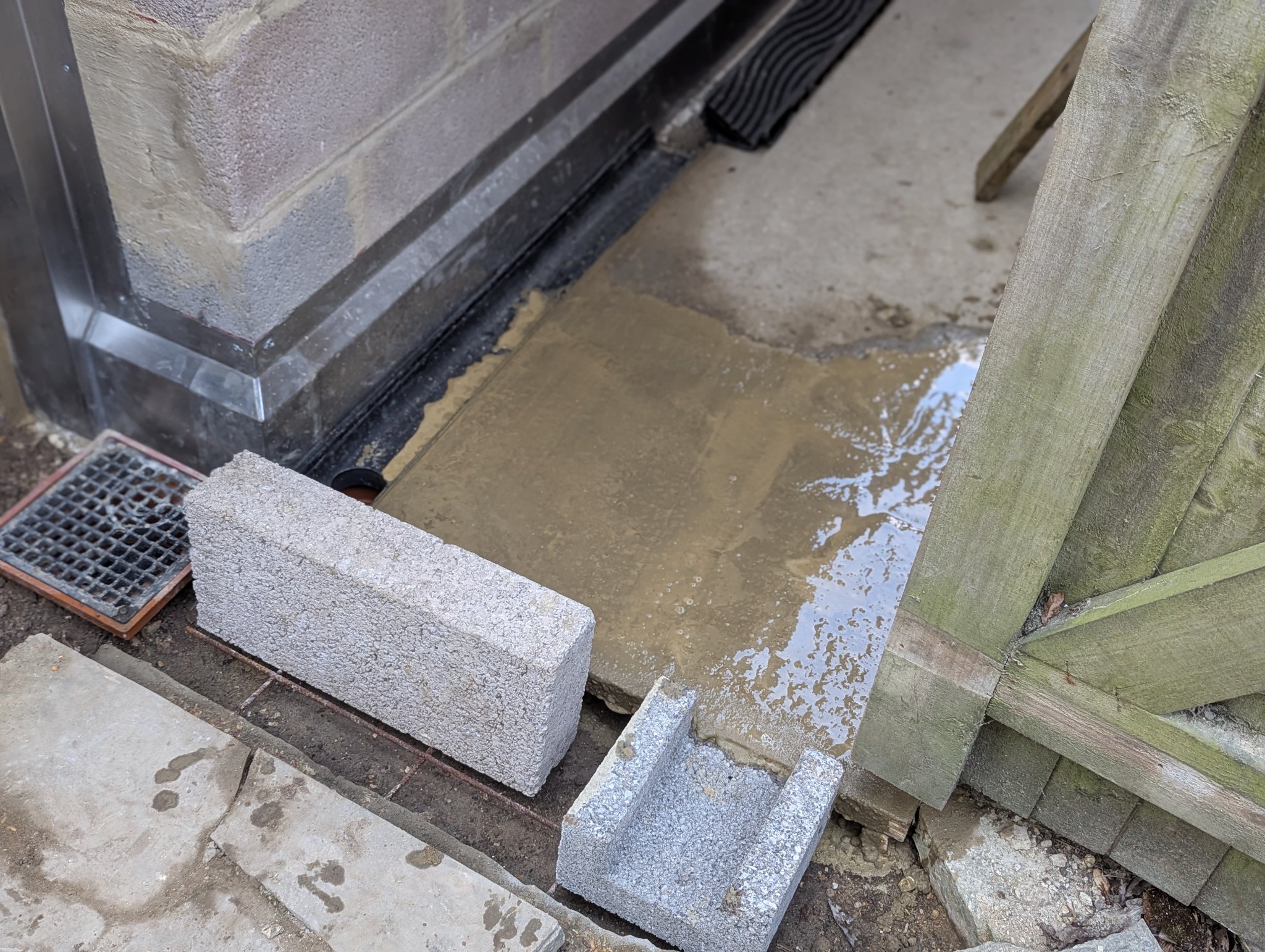

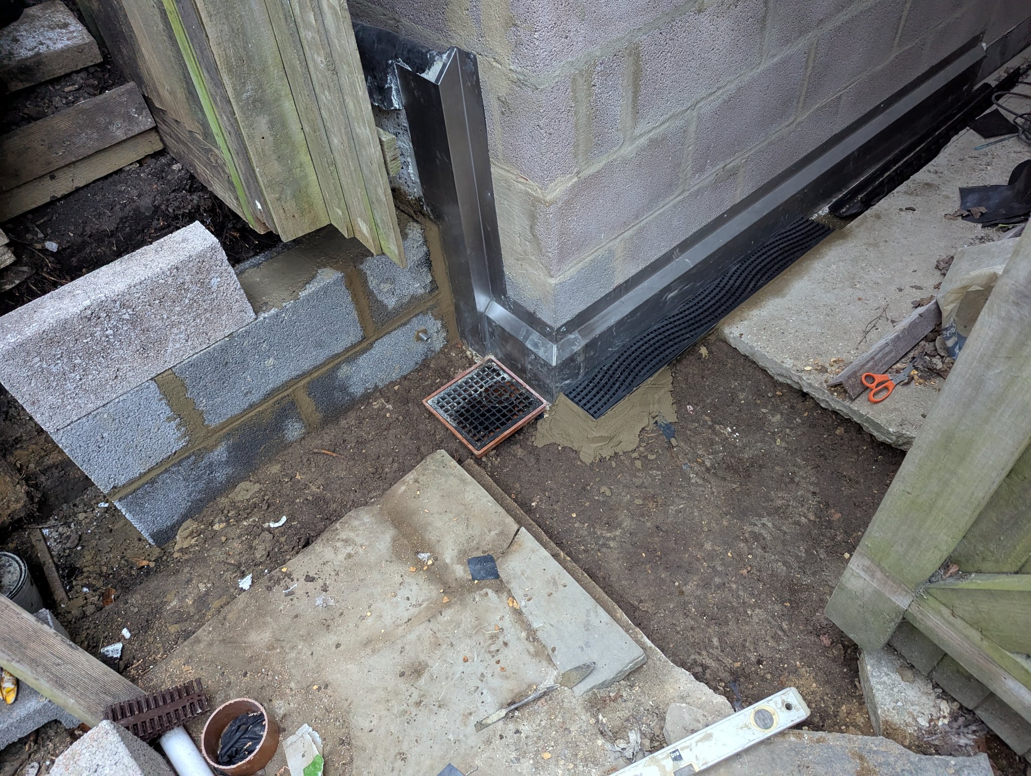

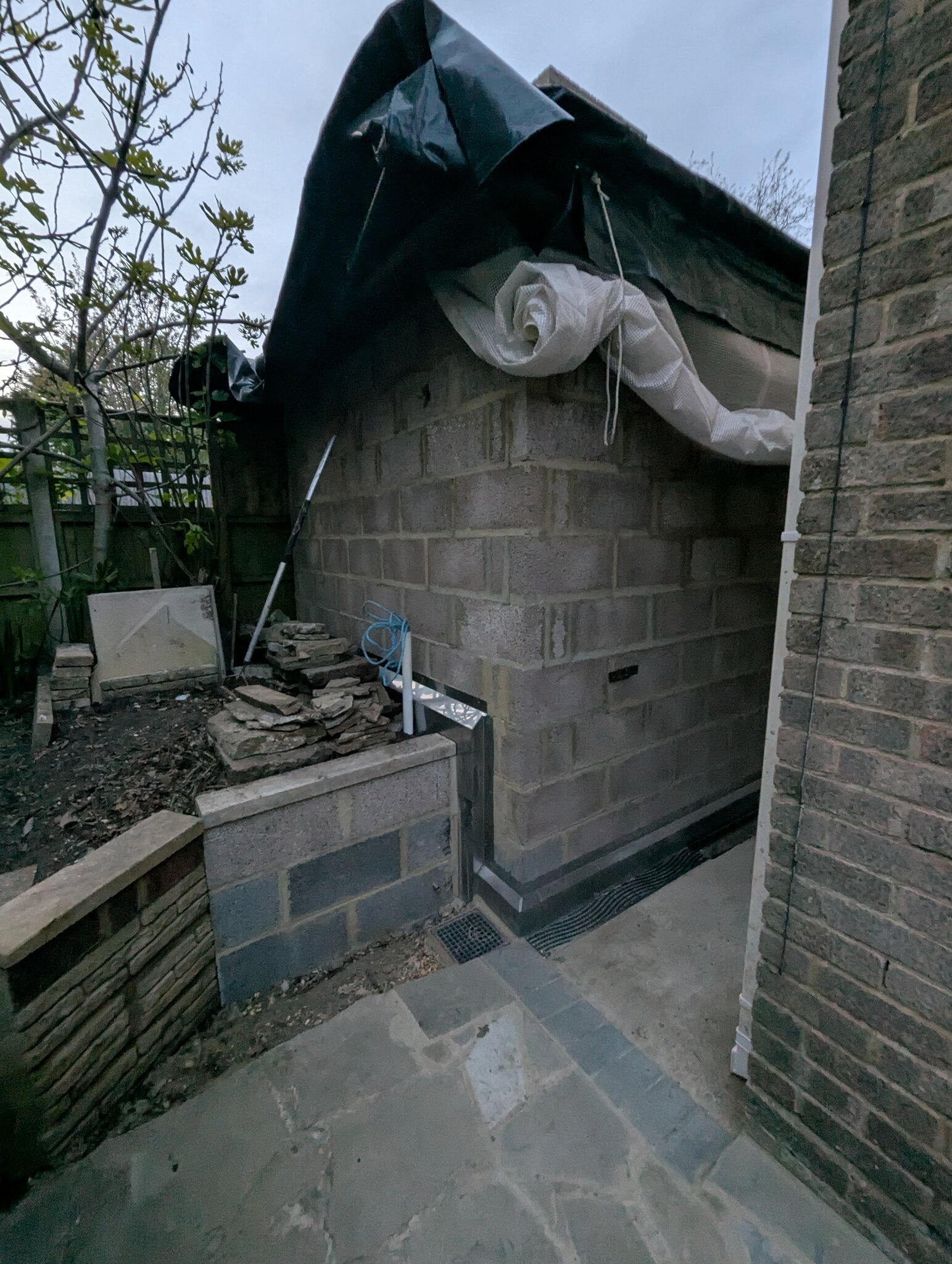

Retaining wall is complete at the front and the front garden is thus reinstated (much to the appreciation of the family)

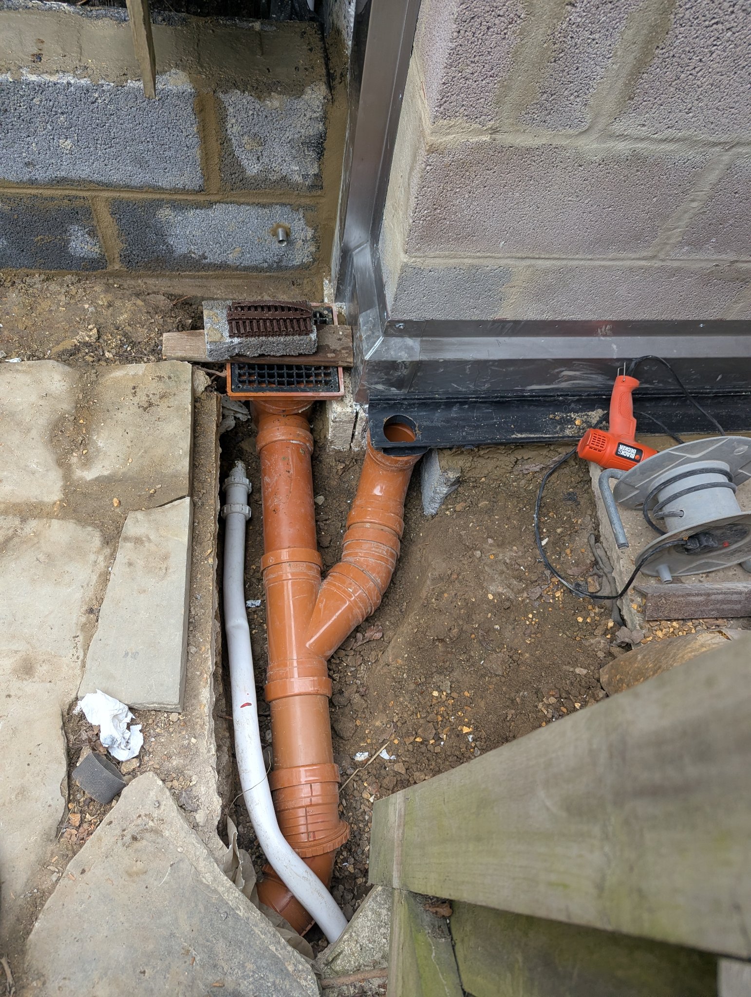

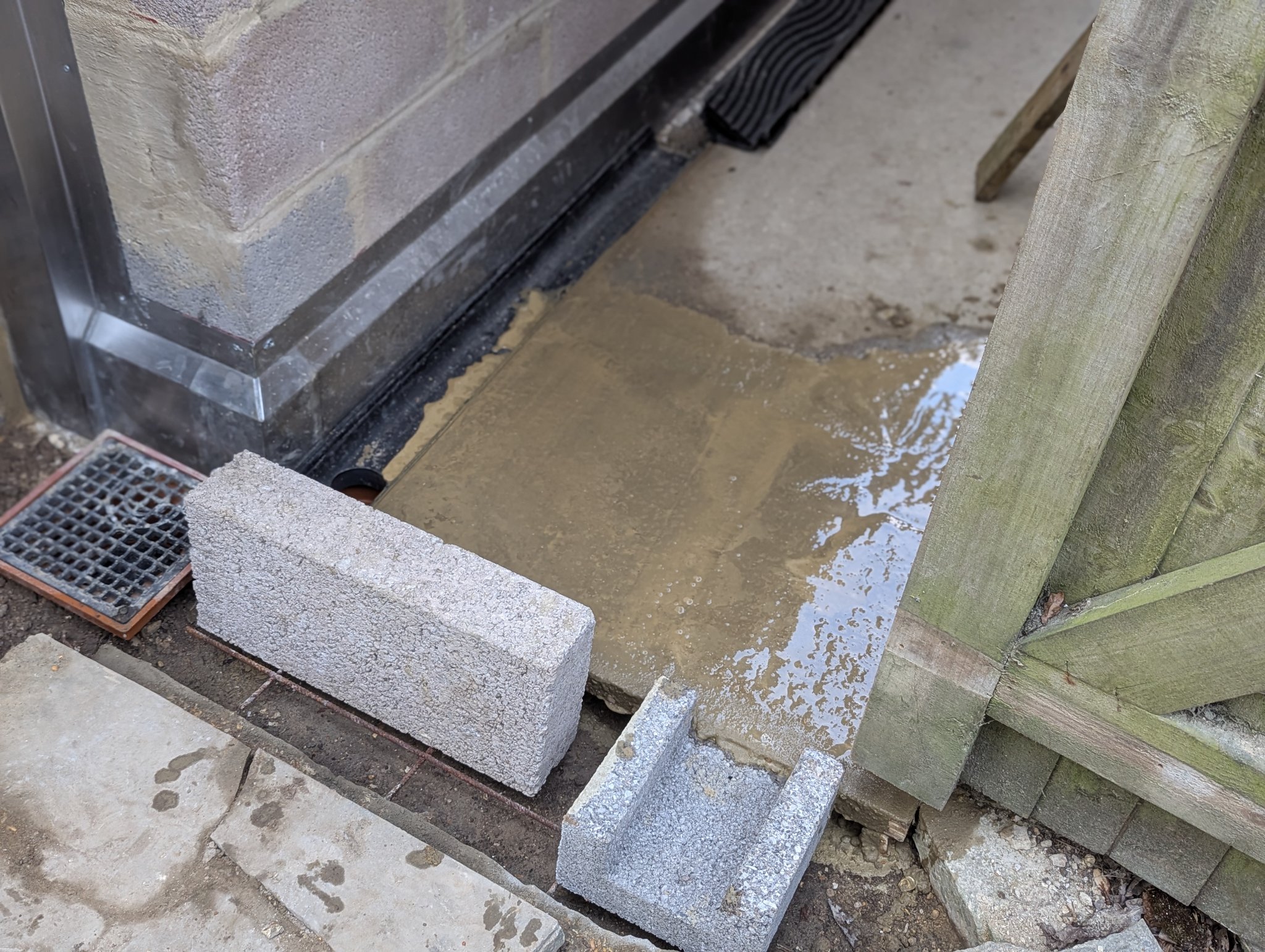

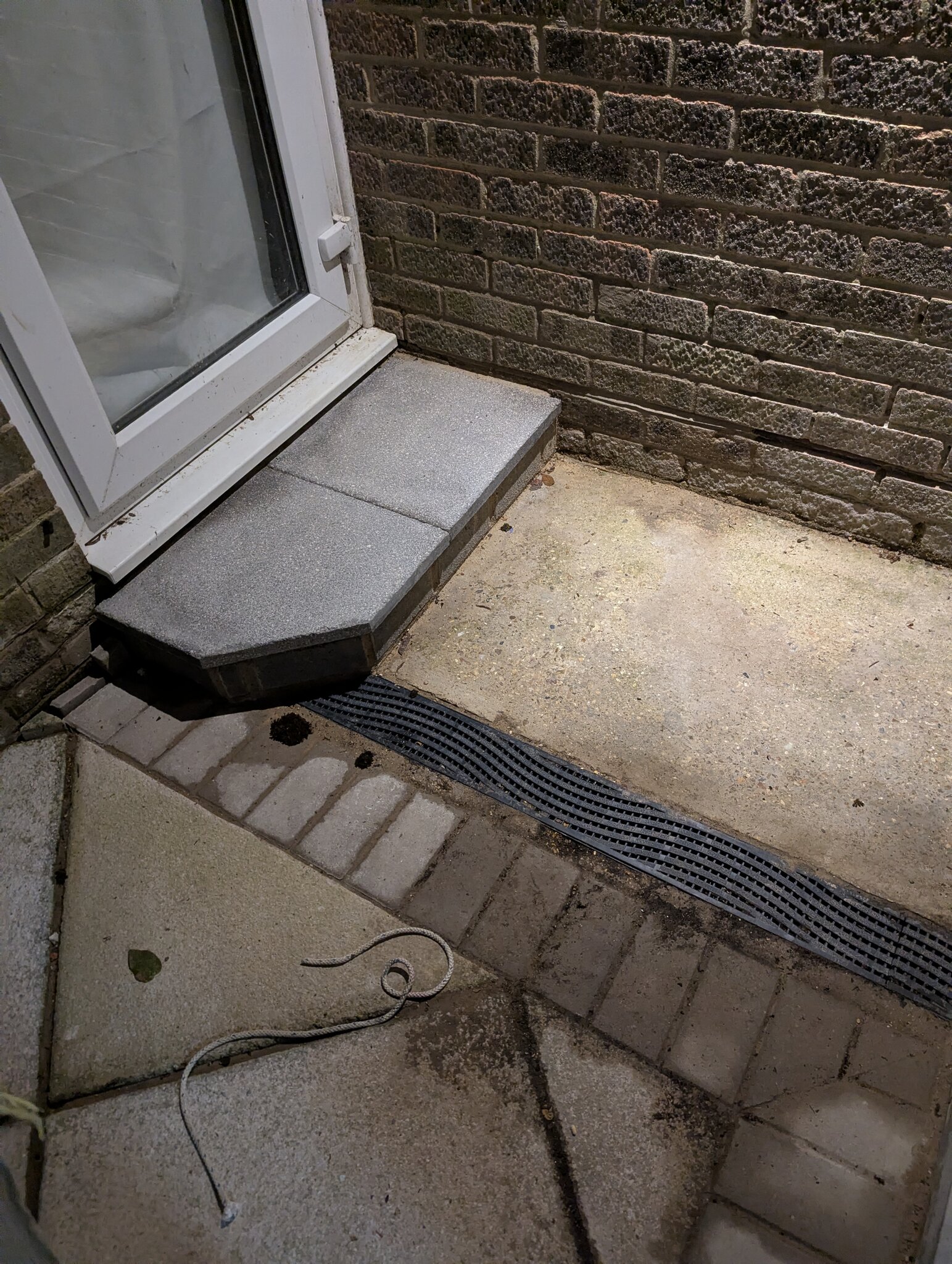

Step into back of the house and all the channel drain in (don't ask how well it drains :( )

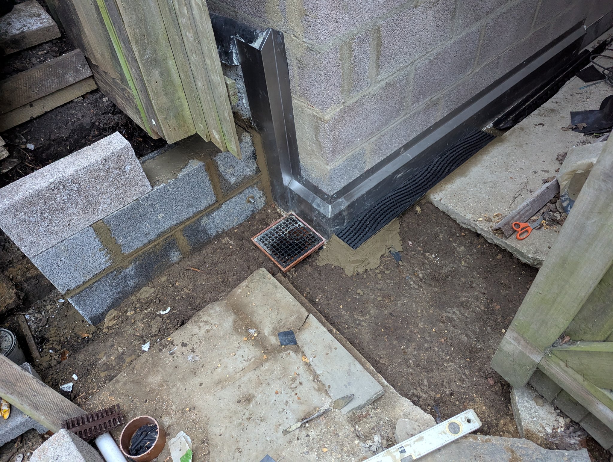

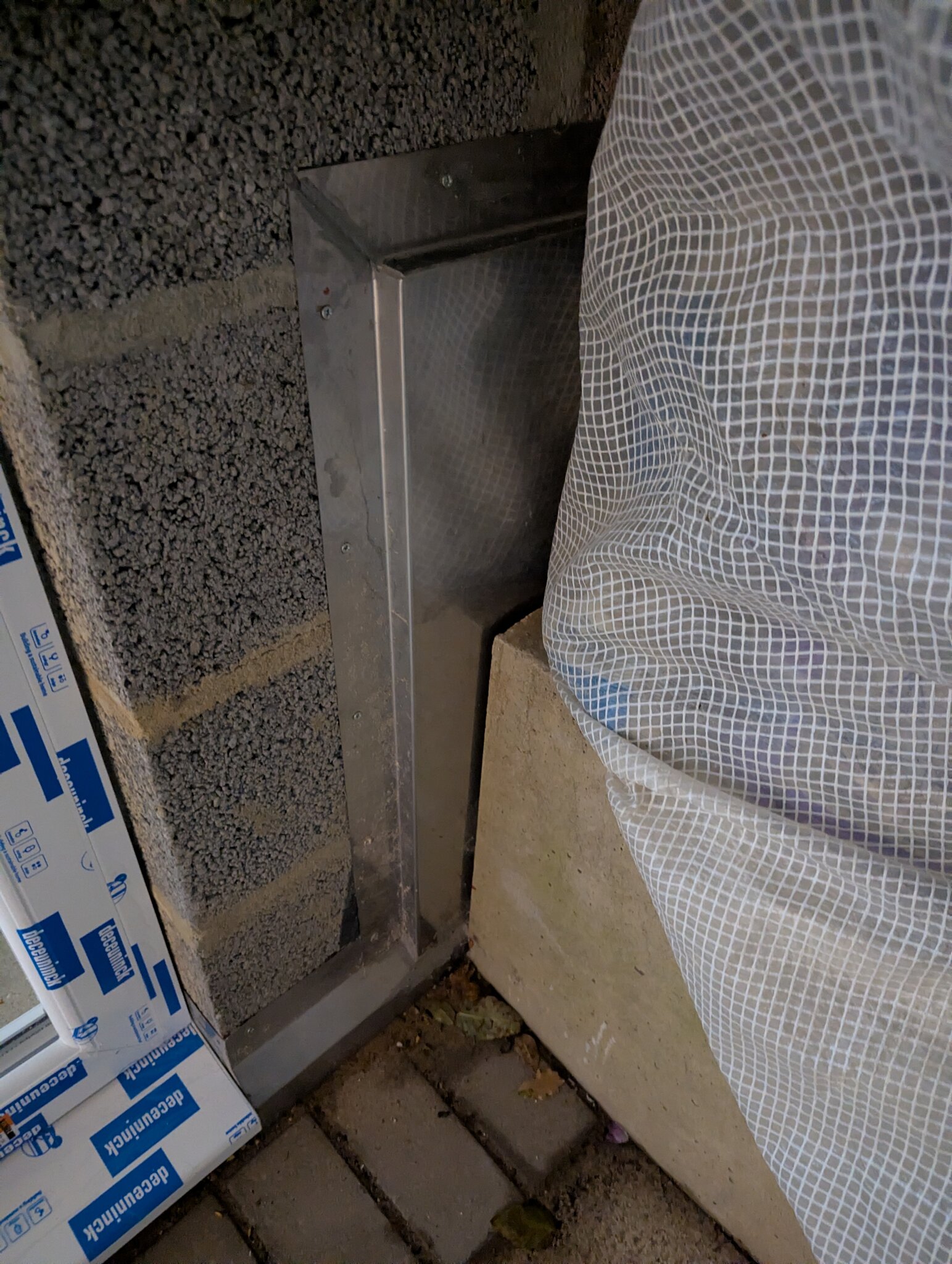

All the tricky bits of stainless flashing is installed with only the wall next to the fence to go

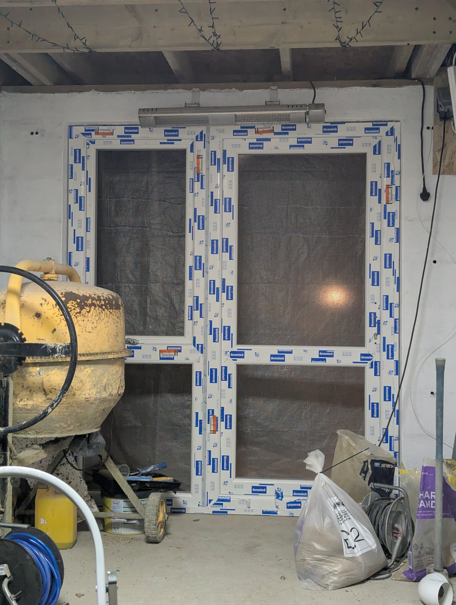

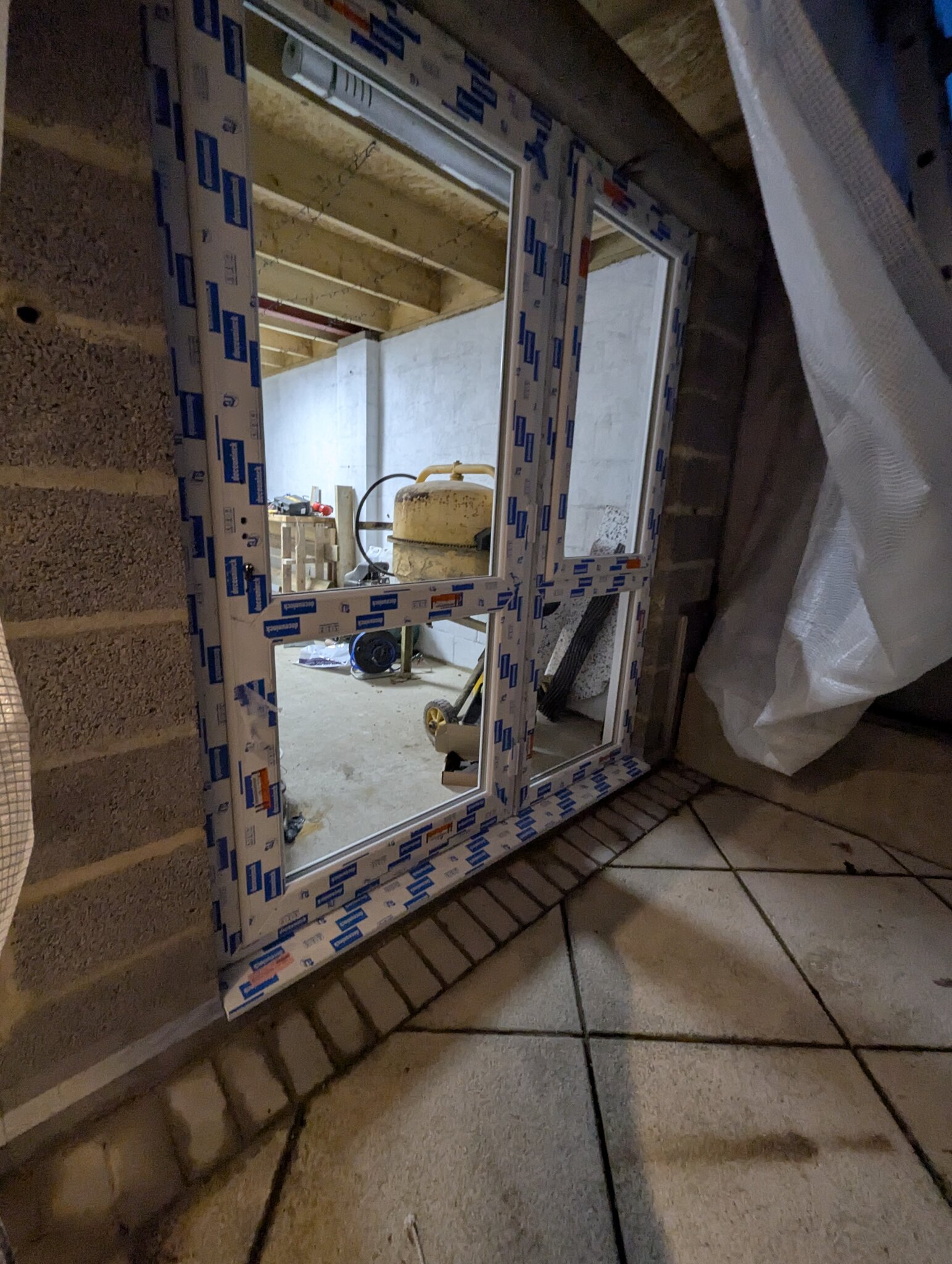

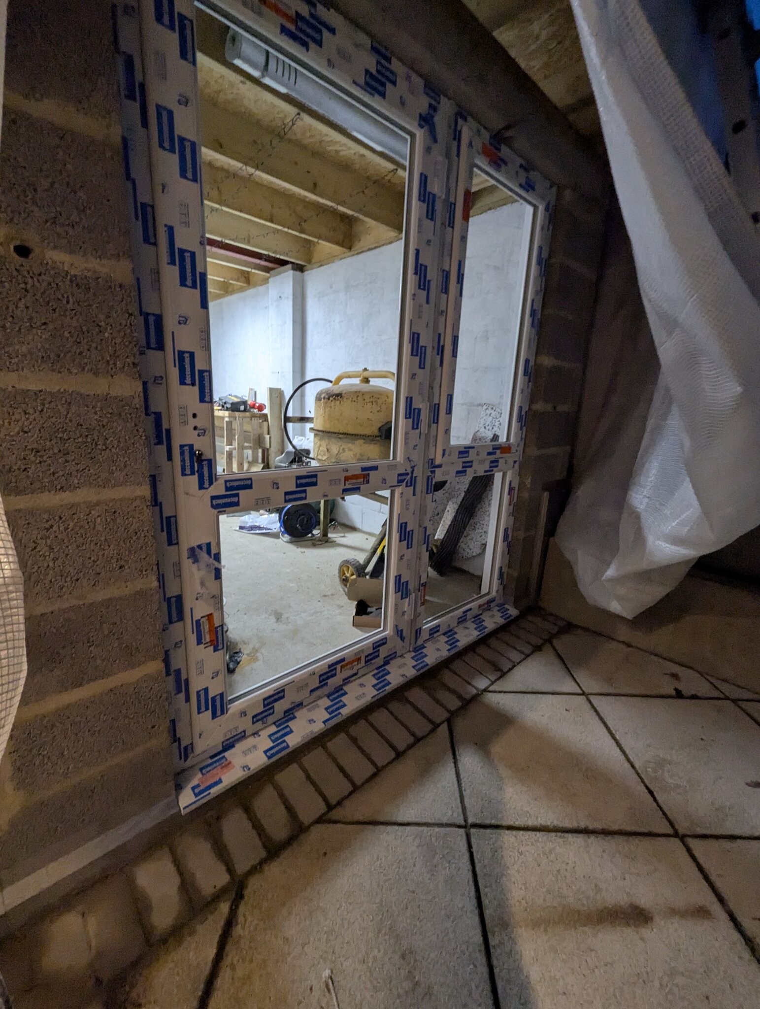

AND I've had door arrive!
Roll on weekend to get them fitted.

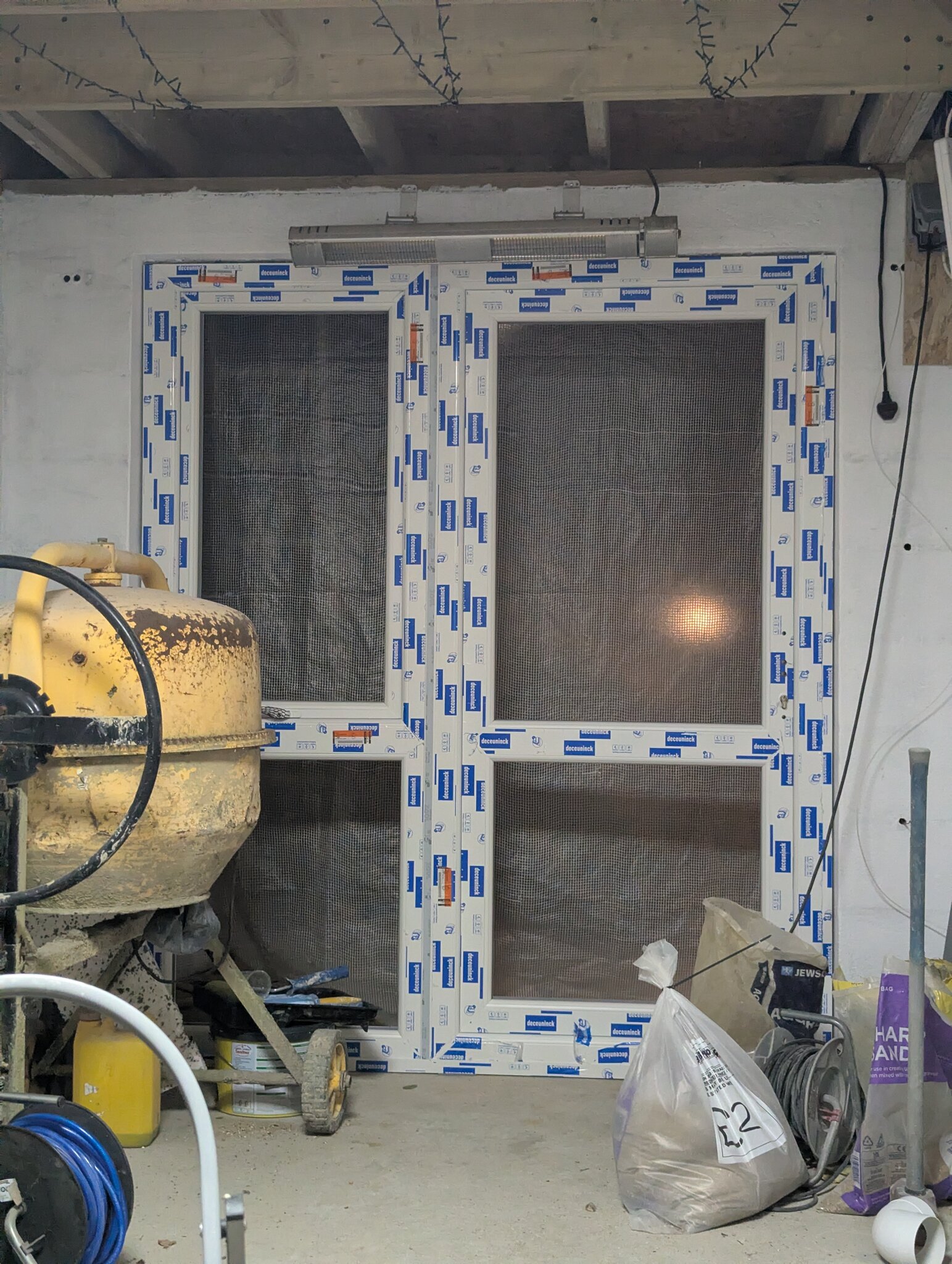

View attachment 415792View attachment 415793
