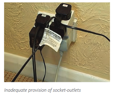

well true but I suppose inconvenience could turn into a safety issue if someone does something inadvisable.
e.g. Now we don't use rewirable fuses in domestic because of misuse (bit of earth cable in the carrier), also need for lots of multi way adaptors is an inconvenience, but it would still be flagged on an EICR.
I think the boundary is blurred intentionally, so that people have at least some sockets available so they don't go doing anything to get the faulty ones back on.
I think that may be stretching things a bit. Someone 'doing something inadvisable' could well be a safety issue if there was nothing 'inconvenient' going on - and there's a limit to how far we can (and, some would say, should) try to protect people from their own stupidity.
e.g. Now we don't use rewirable fuses in domestic because of misuse (bit of earth cable in the carrier)....
... that sounds like a reasonable suggestion, but I don't know whether it is really the reason 'why' we don't use re-wireable fuses in domestic installations. I would have guessed it was more a matter of 'convenience' and, probably more to the point, "because we have new-fangled gizmos which can be used instead of any type of fuses"!
... also need for lots of multi way adaptors is an inconvenience, but it would still be flagged on an EICR.
It might be mentioned by an inspector, but since it's really beyond the scope of BS7671, I'm not sure that it could actually be 'reported' ('or coded') as part of an EICR.
I believe reg 133.3 says that electrical equipment must be suitable for its location. So you could say one socket per room isn't suitable for a domestic house nowadays. As evidenced by the need for ad hoc extension leads. However you could only code it if it gives rise to a danger.
See what you mean about the rewireable fuses though. It's more of a marketing thing (have some flashy trip switches) rather than a regs thing.
I agree.
I think I misunderstood what you were suggesting. I thought you were talking about the use of "lots of multi way adaptors" - which, as I said, I think that, per se, would be beyond the scope of BS7671, and hence of an EICR. However, have re-read your post, I think you were probably talking about the need (or potential need) for "lots of multi way adaptors" that might result from an inadequate number of sockets - and, as you say, such an inadequacy could legitimately be 'flagged' in an EICR (regardless of the presence/absence {or even actual 'need for} of adaptors).

I was rather surprised at the electrical safety council as to what should be included in an EICR, as stated I would consider anything plugged in was beyond my remit. But they show an over loaded weight wise socket as reason for failure.
I do consider any device plugged into a socket not to BS1363 should be removed, as to if it should then fail as possibly strained not so sure? But if I find a blank in a scoket not marked BS1363 then it is removed.

I was rather surprised at the electrical safety council as to what should be included in an EICR, as stated I would consider anything plugged in was beyond my remit. But they show an over loaded weight wise socket as reason for failure. I do consider any device plugged into a socket not to BS1363 should be removed, as to if it should then fail as possibly strained not so sure? But if I find a blank in a scoket not marked BS1363 then it is removed.
The ESC is/was a rather odd organisation, which said some rather odd things (and I'm not sure still exists). However, what you talk of is perhaps a grey area, since if things are plugged into a BS1363 socket which 'threaten to damage' the socket mechanically, then that could be regarded as within the scope of BS7671, hence EICRs.
Kind Regards, John
This is the picture and link to me nothing to do with an EICR as it may be temp, and 5 minutes latter removed.
