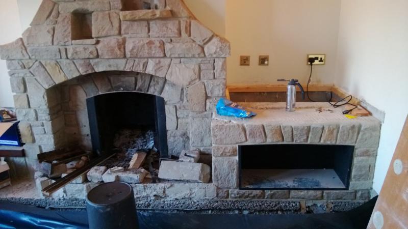

Ive attached a floor plan to show where the fireplace is with the tank going in the utility room.
. We are still only at subfloor level, want to get plumbing 100% before putting the insulation/UFH and screed in.
Unfortunately moving the back boiler isnt an option. The fireplace was one of the selling features for the other half so dont want to risk damage to it by trying to remove the fire/boiler.

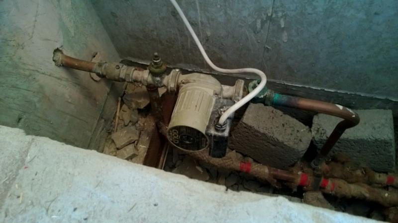

I removed a panel of the fire place yesterday and discovered something interesting at the back boiler...Its already pumped and the pipe work is not what i was expecting.

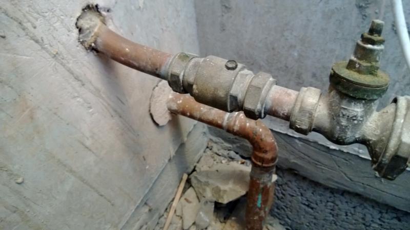

Ill get a photo later today but from what i remember top pipe exits chimney breast at a high level in 22mm and runs to the pump, exits the pump in 22mm and bends to the floor.
Bottom pipe exits in 28mm with a 28mm tee'd off going toward old tank location and a 22mm going along with the top 22mm out through a wall where it was connected to the radiator loop.
Here is a few shots of the current back boiler setup.
From what i can see, the back boiler was connected to the radiator circuit, no valves etc apart from what you can see here.
It was on an open vented system, the bottom pipe in the picture is 28mm from the wall and this turns via a Tee and exited the front of the fireplace below floor level and ran towards the old tank location. The other side of the Tee was 22mm connected to the radiator circuit.
Does any of this look like it ever had a gravity circuit in operation???

I'm no expert, but that doesn't look remotely like it has anything to do with a gravity circuit (the pump is a bit of a give-away!)
Presumably there are some pipes running into the loft from the fire back boiler? - Vent & heat dump? If there is an existing fire back boiler, there should be some way for it to dump heat in the event of a power cut. And vent on a day-to-day basis.
Looking at your floor plan, and re-reading your posts.... on a practical level, how were you planning to get the pipes from fire back to thermal store? And for that matter the rest of the pipework that is not UFH (What I mean is where do you plan to run them?) Assume for a moment that you can employ a pumped ciruit for this purpose, so you can ignore trying to have a gravity circuit in operation. It worries me slightly that you plan to bury the whole lot in concrete...
Again, I'm no expert, but I suspect it will be impossible to set up a working gravity circuit to get the fire-back water from (a) to (b).

The pump and the way the pipe work runs would say its never been gravity. There is/was a vent in 28mm that runs off the bottom pipe towards the old tank location. As for heat dump it was plumbed directly into the radiator flow/return from the boiler but i dont think it would have dumped any heat unless the pump was going!
Im thinking for ease of plumbing and future safety the back boiler is not going to be feasible.
They used to plumb solid fuel back boilers to the DHW cylinder, with a pipestat fitted to start the circulating pump when the primaries into the cylinder became hot. The primaries would be teed to the CH circuit with standard F and E pipework connected. The circulator then dumps the heat around the radiators too, with everything warming up together. There would usually be an override switch to start the circulator from cold. No zone valves, very simple controls. Went to look at one which needs the back boiler replacing yesterday (a small leak after 30 years use), the old boy gave me a tour of his system, including all the different coals and biofuels he had - he was proud of it. :mrgreen:
His HW cylinder was at the same level as his back boiler. The convection in the back boiler and cylinder must be enough to generate some flow. I didn't see it working though, but he'd used it for the past 30 winters.
I think that is our system you have just described :D.
There is a pipe stat hanging in proximity of the old cylinder lol. The pump also appears to have an over ride, the swtich above it looks to be connected to it.
