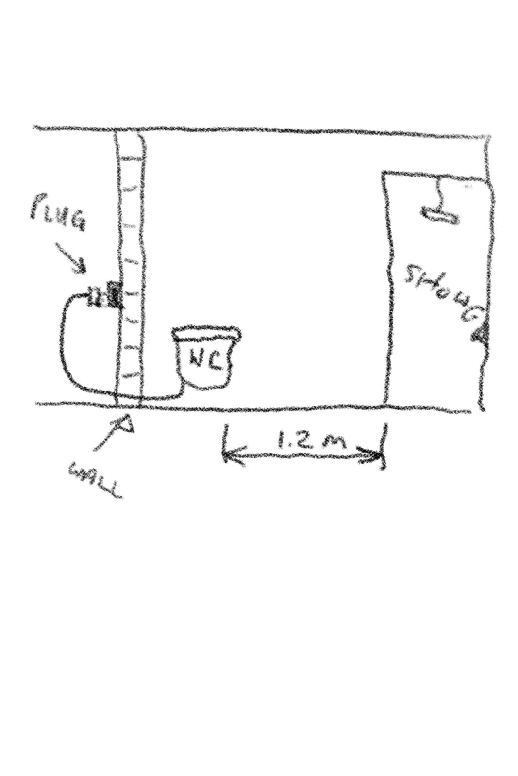

I'm installing an electric bidet / toilet otherwise known as a washlet, washloo or Japanese toilet. It will be installed in a shower room outside of zone 2. The unit is supplied pre wired to a waterproof 3 pin plug. The socket side is then connected to a standard 3 pin mains plug. The Intention is to feed the cable through a wall to another room to plug into a wall socket.
I would describe this as a fixed bathroom appliance powered from an external source.
Simple question. Would this be regarded as notifiable work which need to be certified?
I should add that the appliance itself meets all UK electrical regs.

Just been in touch with local authority building control who have advised me that this work would not be notifiable.
Just wondering though if it would be worth having a sparky test the installation, but apart from opening the plug and checking the connection, what exactly would he test? Would he pat test the appliance?

See original post. The socket is located in adjacent room.
The entire house is fed by a new up to date consumer unit. All circuits are rcd protected.
There is an option to wire the bidet back to the consumer unit, but then of course it would be a new circuit and thus notifiable.
Perhaps a drawing will make it clearer?
2018-12-10  14:53:33.jpg
Ok. In that case you don't need to do much.
It's a bit naff though.
You could have an FCU wired properly next to the WC (assuming the socket is not a spur).
It looks naff on the sketch but all the wiring is concealed as it's a concealed cistern behind a tiled wall.
