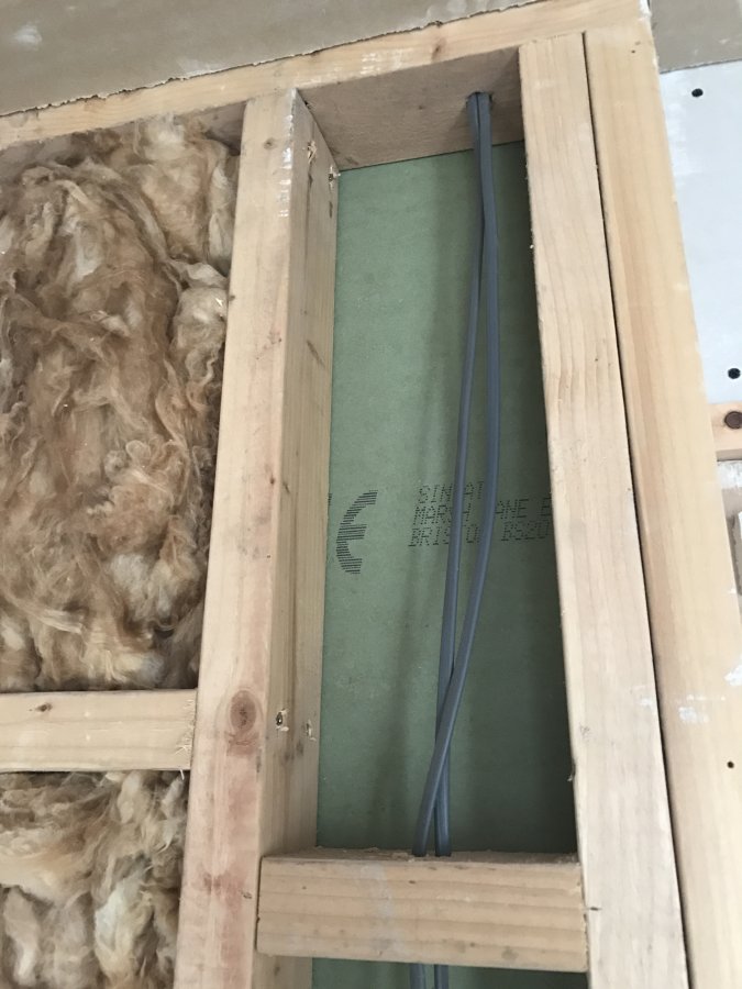

Would you insulate near a wire?

Here:
The wires are for the light switch and the wall is between the bathroom and hall. Insulation is just for sound.
Thanks.
I would
Your rockwool looks like thermal insulation though
I have built recording studios and the acoustic wool is much denser
You need to apply factors to the cable rating depending how much is buried insulation. Over 500mm usual means uping the cable to the next size up. Most people don't seem to bother though including electricians.
Presuming that is just the switch wires for 2 rooms the current is not going to be enough to get the wire warm so just fill it with insulation.
If it's 1mm cable then you'll be limited to a mere two of the large outdoor halogen floodlight in your Hall rather than four of them.
Lighting circuits are always massively over specced due to very little load.
Push them up against the plasterboard, that will allow the heat to escape via the board.
For sound insulation that does look a bit 'sad' - I just used some Rockwool one and it's very dense, stands up in the cavity on its own.

It will be fine, I am assuming it's not a recording studio. Waste of time spending loads of money on acoustic insulation in a stud wall unless you are going to the efforts of creating proper separation. Most of the sound transference will be through the studs.
