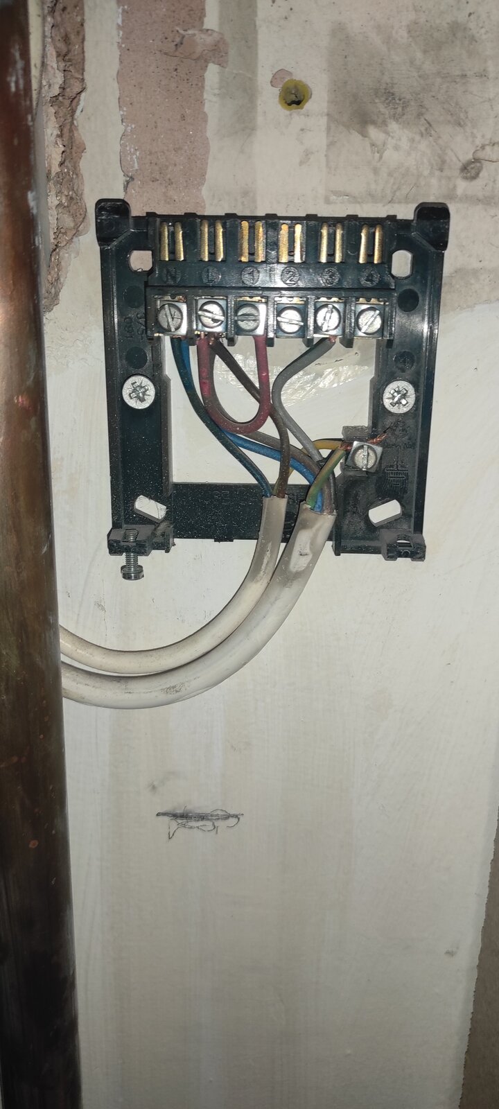

Hi I attached aphoto of my wr1....The bolier doesn't fire up...I have like a bridge conecting L terminal and number 1 position....Then where should be a black wire going to 1 terminal is nothing...missing just the red live bridge wire...How to fire the boiler up?..I should connect 1 and 3 but ....?Thx ...waiting for a response...is 2 degrees outside already :((((

There is nothing weird about the wiring you have.
From your other posts, it seems as if your WR1 has failed.
To bridge the connection, move the end of the red wire in terminal 1, to join with the grey wire in terminal 3, with the power safely isolated.
Put the WR1 back on the backplate to protect the live connections.
You can then control the heating via the controls on the boiler.
You will not have thermostatic control.
thx a lot for answering so quick ...So should I move the red wire end from position 1 to position 3 or should I connect 1 and 3 with another wire?And thanx again
Many thx Randomgrinch...I have followed your instructions and boiler is working..what should I do now? Replace the wr1 or replace capacitor only?
