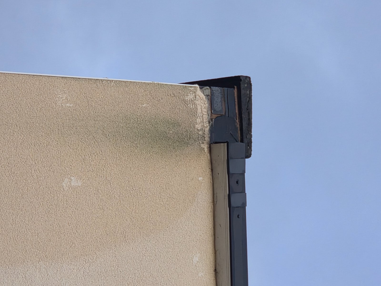

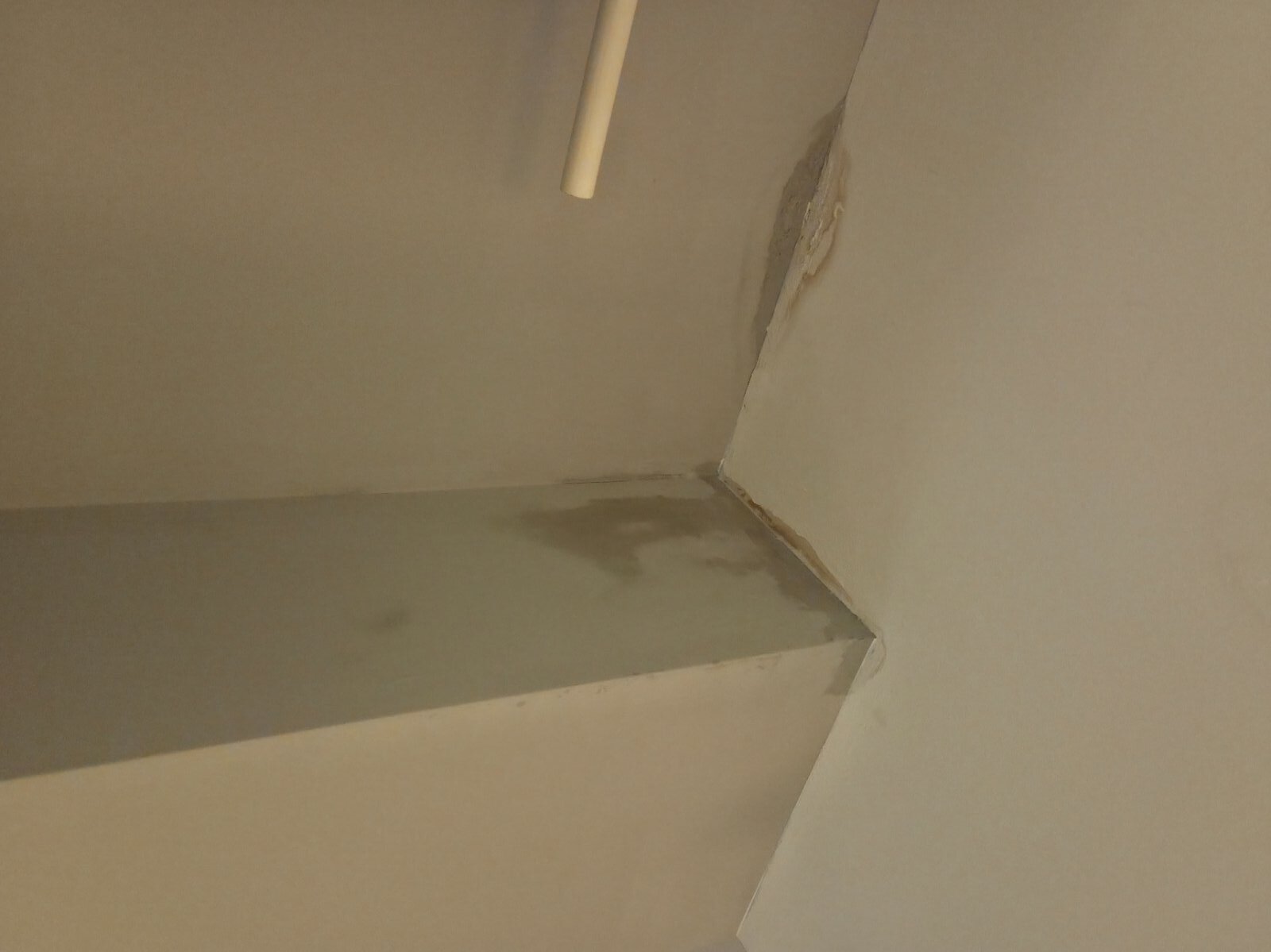

I'm not convinced the tiling is the problem, the internal picture of the damp around the skylight, is that the rear of the skylight, near the main house where it has been knocked through?
Yes and the wall you see at the back is the patio doors. It only leaks in heavy rain, even then a had a few heavy showers without anything.

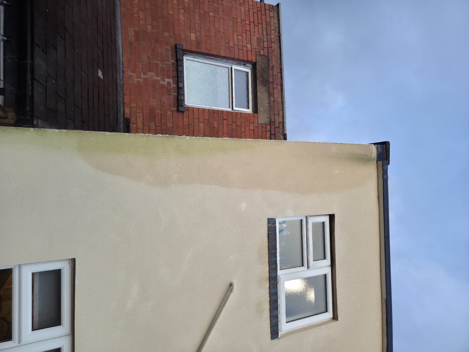

Looks like you need the top abutment opened up to check the flashing, and abutment detail.
You should also have the wall above and frame sealant checked to ensure that nothing is getting behind the render.

As a bit of an update, I've noticed this in the bedroom directly above the RSJ, which csnt be a coincidence.
Also looks damp on the left but nothing internal, is this because of the blown render do you think? Leak is appearing on the left hand side of the pitched roof and now directly above it in the room above.
Flat roof was checked briefly by 1 of the roofers who said it looked "spot on". Flat roof is only 4 years old and under warranty.

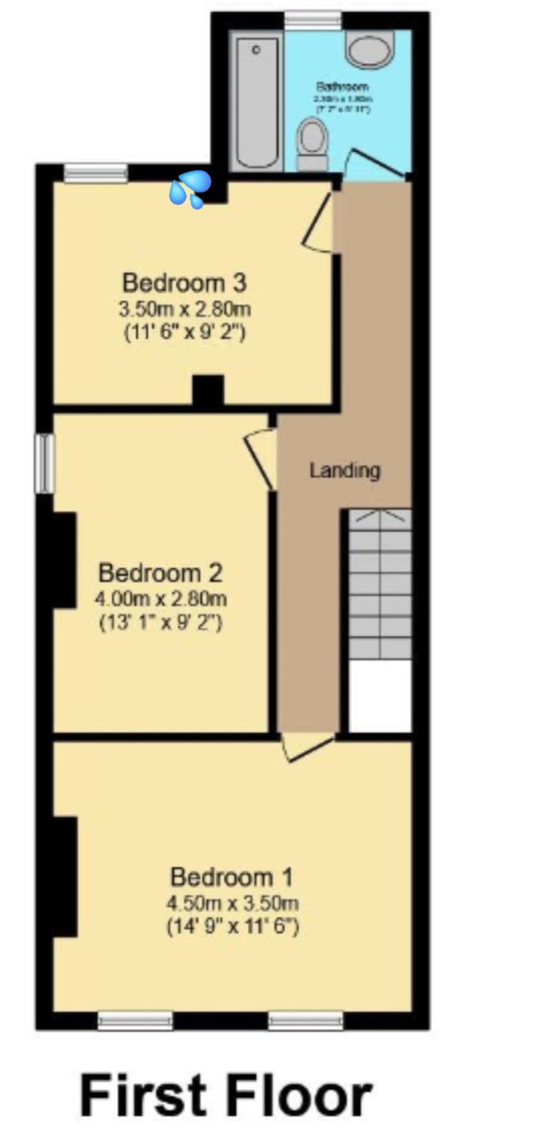

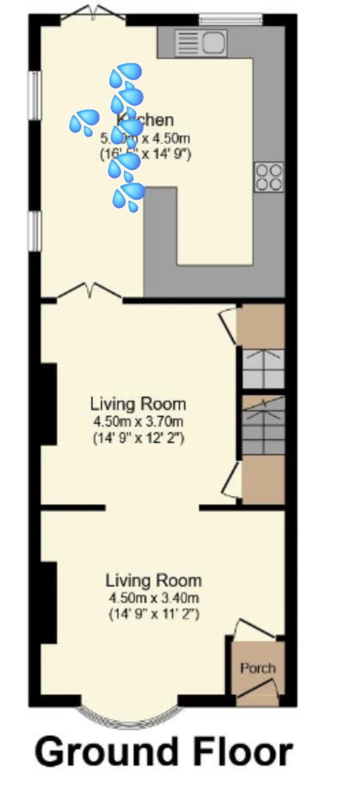

Floorplan, blue water shows where the leak has presented, starting to think this is a flat roof issue.
