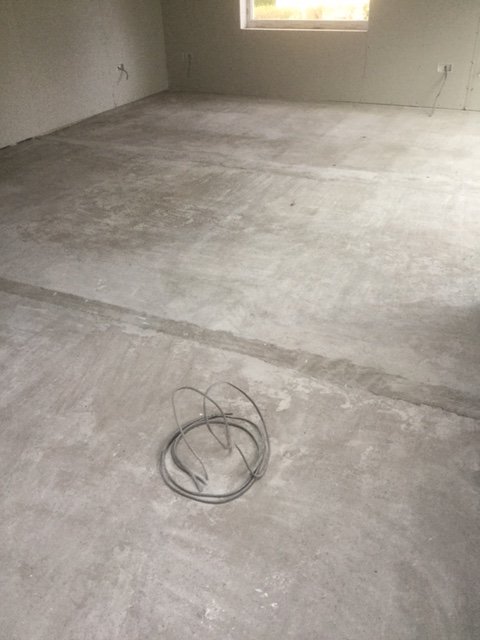

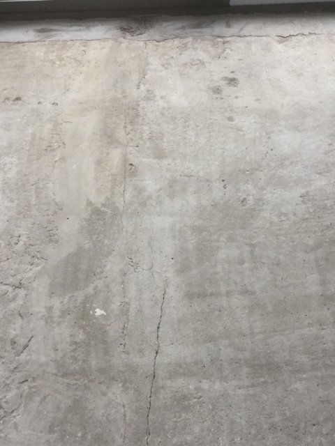

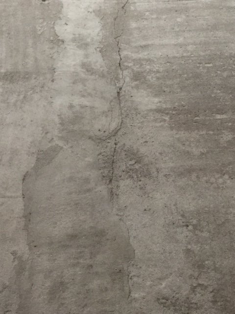

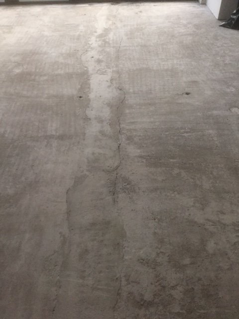

Hi, I have a new extension built, made wind and water tight end of November. The Plumbers installed pipes on the insulation using plastic 'egg box forms to hold the pipes. 100mm screed was laid on top and I was told it would be 4-5 weeks before the heating could be turned on, which meant the 30th December earliest. Well the plumber returned last week and connected up the 2 port manifold to my combi boiler flushed and filled the system and leaving said just leave it running, most of my rads are fitted with thermo valves! Well I lasted until 2.00AM before having to get up and switch off... far too hot even for Scotland! The following morning my builder said the plumber had phoned him the previous eveing to say he had left the flow valves and mixing valves on maximum.
My understanding is WUFH should be run up in stages gradually, well my floor is now showing cracks, my builder just says he'll get the brickie back to fill the cracks. Are these cracks something to be worried about? I intend tiling the floor will the possible movement of teh floor be an issue. The crack goes the full distance form wall to bifold doors!
I've tried to show in pictures
Many thanks

A lot depends on the type of screed.
Thermal expansion joints?
But yes, as a rule, we always bring the temperature up very slowly; and never straight to maximum. Christ, even with wooden floors mine maxes our at 45 depending on the weather.
Would a decoupling membrane be any use on the floor Dan?
Almost definitely. But only if the screed is stable.

Hi thanks for replies.
Newboy, the channels are where wooden screed boards were removed, he back filled them, his screed tool was only 3m wide!
Dan, I should add there are no controls ie. Thermostats, valves wired up thats down to someone else. when I came downstairs at 2.00 the flippin floor was hot! the condensation in the roof light has now dispersed
DP I used a CSM 90 mat in the US it was mandatory in the apartments for noise control and crack prevention seemed secondary..however I am having doubts over this floor, not too happy!!

Probably no serious damage has been done. That cracking looks pretty minor to me so you may be lucky.

There is only the one crack, and it's where the second floor screed was poured, so that and the minor back filling over the screed board filling that have lifted seems to be the only real issues,
but I've the architect coming out tomorrow so its now in his hands
