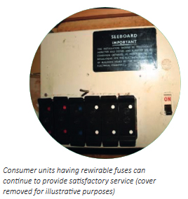

There is some debate on how important these devices are, and the electrical safety council in their best practice guide show fuse-box-1.jpg with the comment they can still provide satisfactory service.
Never the less you need to consider if it needs changing.

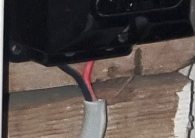

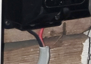

Also this
is not permitted, and if done where it is clear it is non compliant the question is where else has it been done.

There is some debate on how important these devices are, and the electrical safety council in their best practice guide show View attachment 252809 with the comment they can still provide satisfactory service.

However unlikely you can by a replacement mirror which does not require RCD protection.
Also this View attachment 252812 is not permitted, and if done where it is clear it is non compliant the question is where else has it been done.
