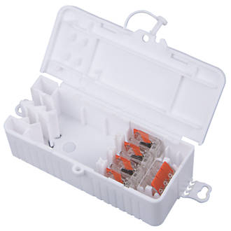

Hi all, I'm extending a lighting circuit to include a new set of downlights and wanted to check if this qualifies as a maintenance free junction box?
https://www.screwfix.com/p/debox-ju...7cCJWOlOpNCRYg-lY8QaAiobEALw_wcB&gclsrc=aw.ds
According to https://electrical.theiet.org/media...tions-and-maintenance-free-junction-boxes.pdf the requirement is ".Equipment complying with BS 5733 for maintenance-free accessory and marked with the symbol (MF) and installed in accordance"* with the manufacturer’s instructions.
Screwfix don't say what the manufacturers part number is in their product description, but in the Q&A section someone claiming to be from Hylec says it is a Debox SL2.
While I can find various claims of "Maintenance free" on both Hylec's website and the websites of distributors, none of them are accompanied by a reference to BS5733. As such I don't think they are worth the pixels they are printed on. Hylec's website has a section for downloading instructions but there is no mention of the Debox SL2.

BS5733 isn't about MF items specifically, it contains very little on maintenance free junction boxes.
This is most of it:
The rest just being descriptions of screwless terminals, various definitions of the component parts and how to confirm they comply with those descriptions.
Almost all of the MF element is due to the terminals themselves and various tests done on those terminals with movement, vibration and so on.
The parts which cover cable clamps and other general construction are the same as for everything else made to BS5733.
The MF symbol only appears in BS7671, and not in BS5733.
