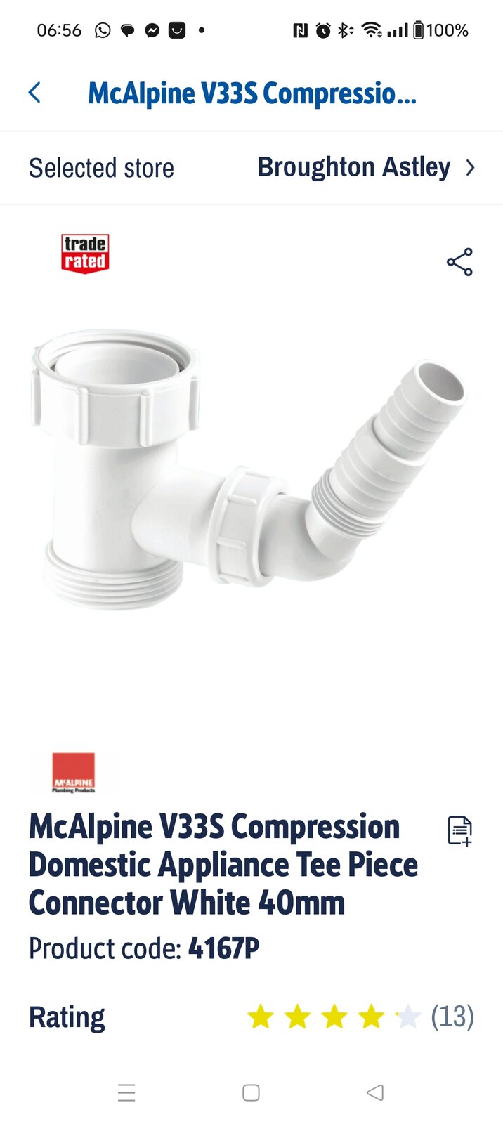

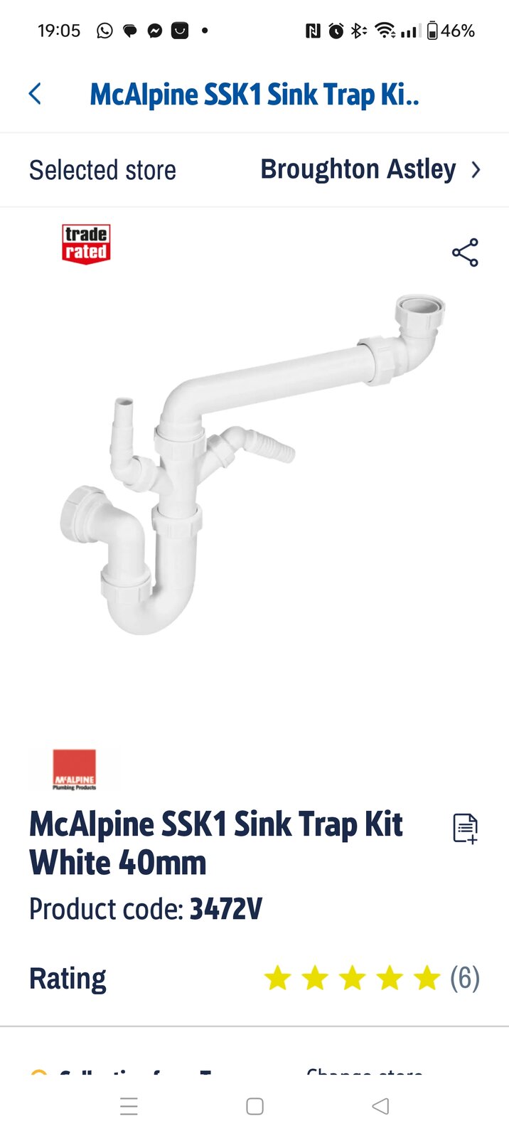

Is something like this ok to connect washer and condensing dryer to the same drain spiget. I was planning to fit a double stand pipe but room behind integrated appliances is proving challenging. Plan B is to run 2 waste pipes to the spigets under the sink. Dishwasher, Washer, dryer in that order
My concern is the washer may pump drain water into the dryer

There's literally no room to squeeze a stand pipe behind the appliances, believe me I've tried. The waste hoses for the dishwasher and washer will fit and reach the sink trap spigets if I run them down the skirting recess behind the machines. The dryer hose is much to short but could tee into the adjacent washer hose. Just a little concerned the washer will back fill the dryer with drain water‍♂️
Syphoning only occurs if the hose route is not correct, connection for all must enter from a higher position than outlet.
Not a good idea to share a drain hose, it is designed to pump one appliance at a time. Could it backflow, probably not but there would always be a risk.

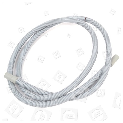

What size of hose is on the drier, usually they're a lot smaller than standard drain hoses. Why not just extend it?
