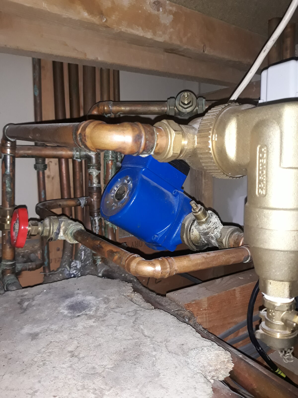

Hi, after much trial and error and have finally managed to balance my heating system( usual story upstairs boiling downstairs Luke warm at best) they all heat up fairly evenly now and all get very hot after turning all their locksheilds a quarter turn. One thing i am curious about is the bypass gate valve, its located between the pump and 3 port valve,I am just wondering if it is safe to turn this off?all my radiators have trvs with the exception of the bathroom,en suite and lounge, i understand the 3 port will always allow a flow whether it be a, b or mid position. The valve is currently open about half way and i am just wondering if i need it? The boiler i have is a Worcester 18ri condensing boiler ( old boiler was an ideal classic) overall the system is 20 years old.

Hi, i understand the bypass has been installed a reason and the plumbers probably knew that the 3 port valve would allow a flow, exactly what this valve is for specifically i do not know for sure but i have a few ideas correct me if im wrong, 1: it was fitted in case all radiators had trvs 3 of mine don't. 2: possibly for balancing purposes, 3: maybe to maintain the return temperature on the boiler (if the boiler return pipe temperature is too low maybe it won't work properly/efficiently?
My understandings may be wrong, what is the worst that can happen if this valve is left closed? The boiler i have is Worcester 18kw ri fitted about 5 years ago the old boiler was an ideal classic, the system has 10 radiator and its a gravity pumped system which is 20 years old nothing on the system has been changed besides the boiler.
To be very clear this is the gate valve i am talking about just after the pump and before the 3 port valve 20210418_214233.jpg

Yes I do know that, but if the room thermostat is calling for heat ( doors and windows open ) and the only radiator that is open is in that room then the radiator ( and bypass valve if fitted ) have to be able to dissipate at least the minimum ( modulated ) output from the boiler to prevent the boiler from cycling.
Of course if boiler's maximum output can be dissipated by that one radiator ( and bypass valve if fitted ) then the boiler will not need to cycle
