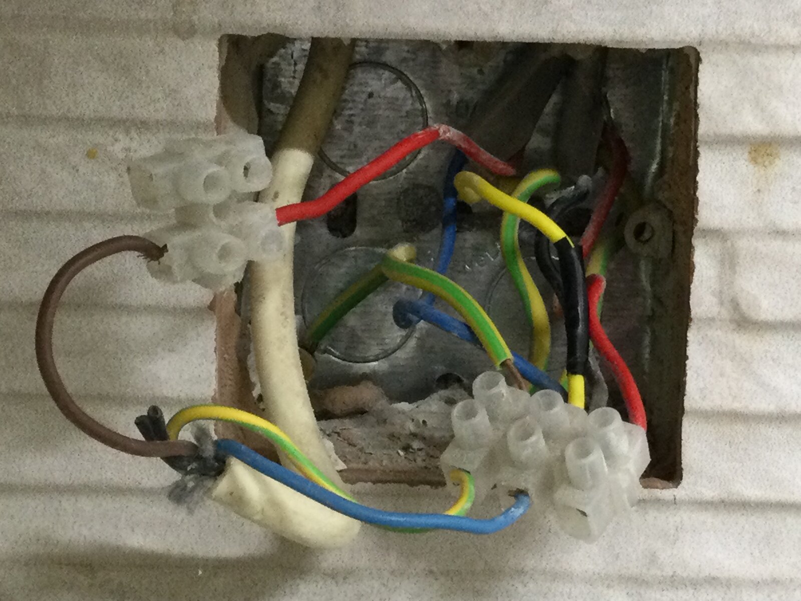

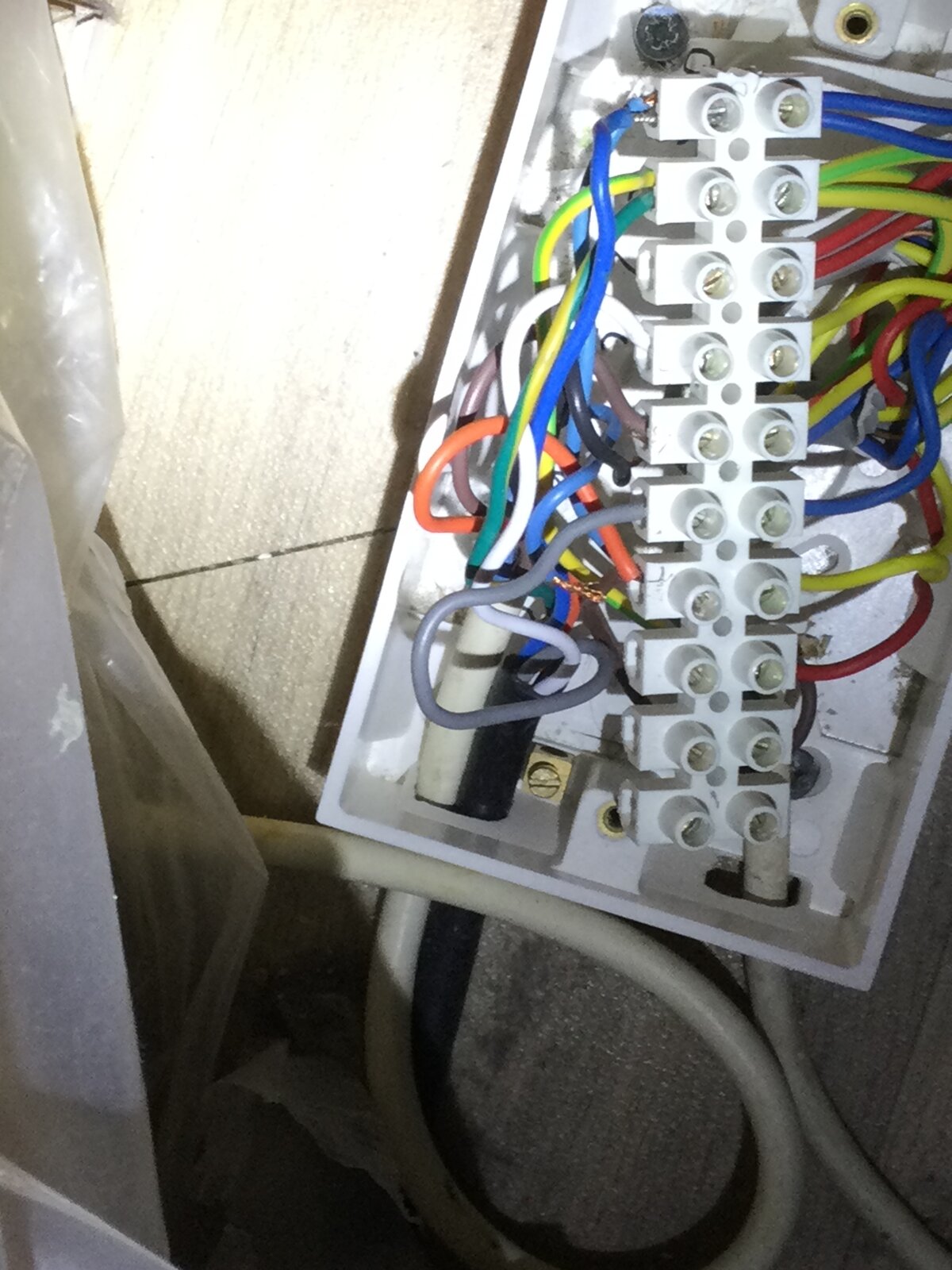

fitting a hive thermostat and all seems to be working so opened the wiring centre to link out the old thermostat and found this
apart from the terminal numbering not matching the faded numbers where should the loose blue wire be connected? It is from the tank stat.
If I can find a diagram I may start from scratch with correctly numbered terminals.
is it a problem if the tank stat earth isn’t connected? It doesn’t appear to be!
Looking again there is a loose black wire as well…… also from the tank stat.
Only one wire was connected to the tank stat (common to T6 not that it means much) no one has touched it since the guy who serviced the boiler changed the three position valve actuator a year or so ago so the wires have bee loose at least that long.
tried common to T6 and the other two to T7 and T8 then vice versa and neither move the valve to heating.
looking at the tank stat case is cracked SoI need to get one.

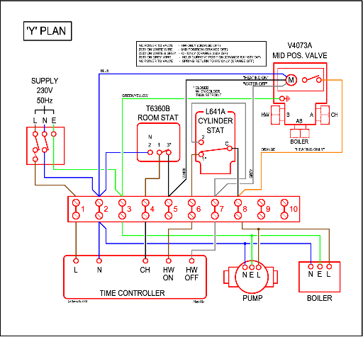

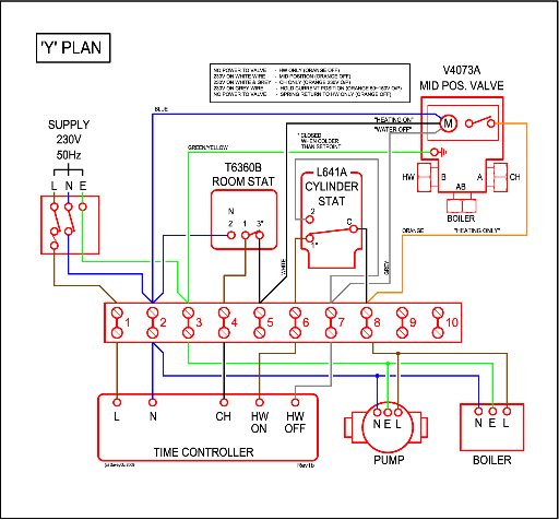

There are plenty of Y plan wiring diagrams on the internet ,and YouTube videos too.
This one may help.

Honeywell have a really good app you can download.
Look for Honeywell home wireing guide all the different plans Y - S - W - C are all there.
It includes a troubleshooting section.
Thanks for the suggestions, I found the diagram in the boiler instructions and followed that, working now but no idea how it worked yesterday.

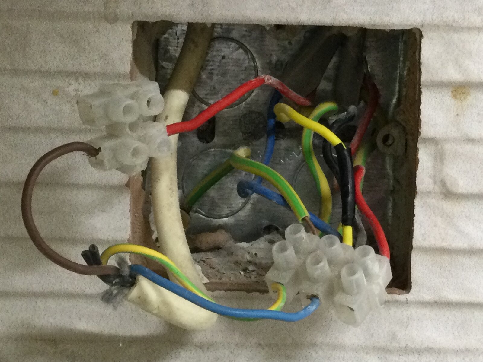

One addition is a neutral wire from the wiring centre down to the boiler . . . I couldn’t see where else the pump/boiler stat would get neutral! Luckily when they installed it they ran a triple and earth from the boiler to the wiring centre. There is no LNE feed from the dp switch, just the switching feeds from the controller, I have a feeling there is an LNE feed to the boiler from somewhere as there are connections near the boiler but no idea where they come from.
