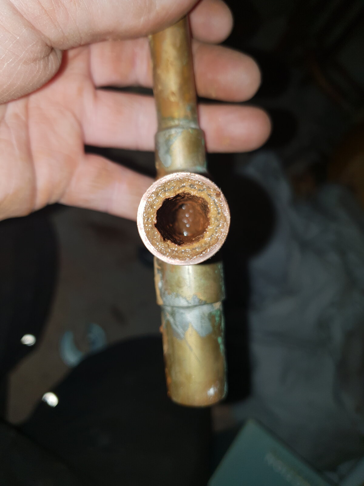

Radiators are totally working fine.. equal heat bloom on the Thermal imaging camera, but it shows the hot water is only getting halfway from the pump.to the cylinder, even when 3W valve is both positions
All 3 Radiators are all hot which proves flow from pump to 3W valve port A to rads and return.
So my initial thoughts are..
blocked 22mm flow pipe from valve port B to cylinder.
Or blocked cylinder.
Or blocked 22mm from cylinder to common return.
Or a combination of all 3!
Wierdly the HW cylinder is piped with flow from boiler at the bottom of the coil and the return at the top of the coil.
System is fitted with magnaclean filter and that has minimal magnatite, system is filled with x100 and has been regularly serviced.

Can you use the manual lever on the valve to put it in mid-position? If the pipe to the cylinder then gets hots it looks like a valve problem.

Shut down system, drained it all down..
Stripped down the 3w from the pump and all seems fine. Sits blocking port A untill I move the lever over then moves to mid position if put into manual. Port B has a visible gap.at all.times..

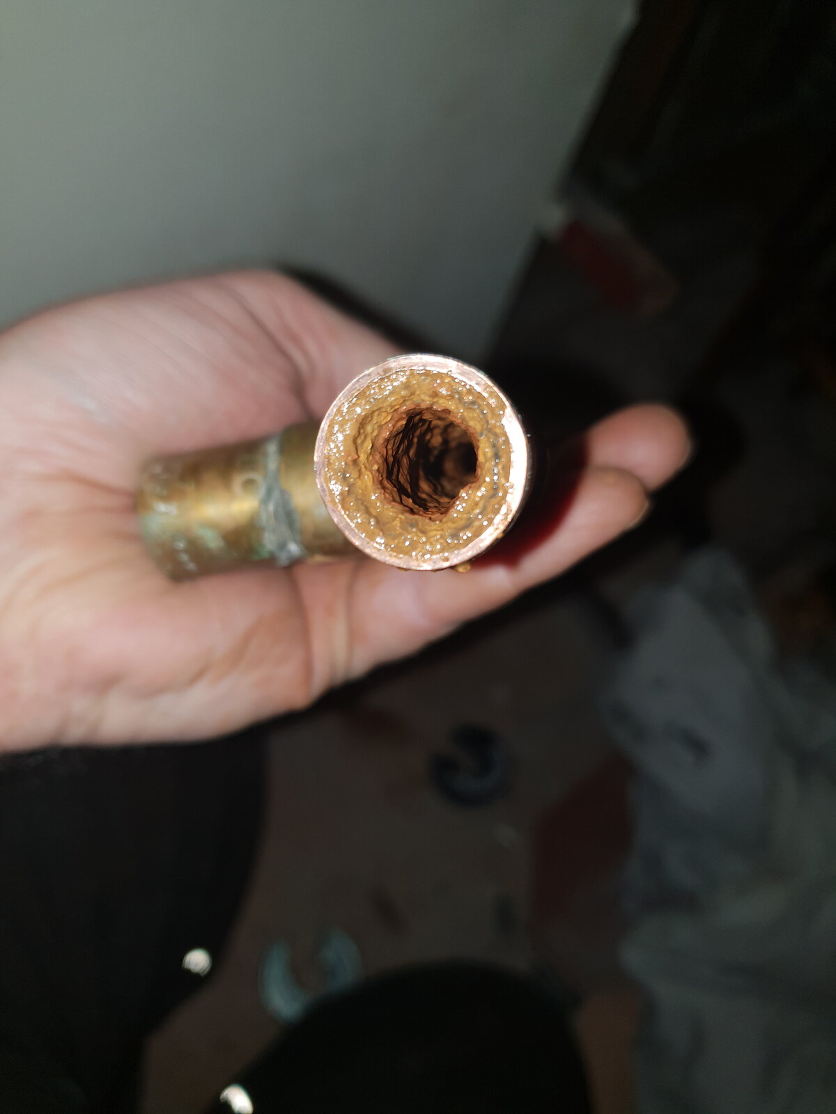

Time to check the port B feed to the cylinder and return.
Here it is... 22mm feed from hot cylinder to the common flow return..
Blocked...
and we found the 46 year old HW cylinder is weeping.

@terryplumb As the rads are working, (inso much that they are getting very hot) the only logical conclusion was the section from the HW cylinder back to the return common. Magnet test indicated a presence of ferrous material in those pipes.
So the cylinder is currently piped with the coil input flow at the bottom and return at the top. Is it worth swapping them to flow at the top and return at the bottom when the HW cylinder is replaced.?
I'm.planning to cut out / replace the affected returns pipework and power flush with x800 the remaining pipes before i put a new HW cylinder anywhere near it
