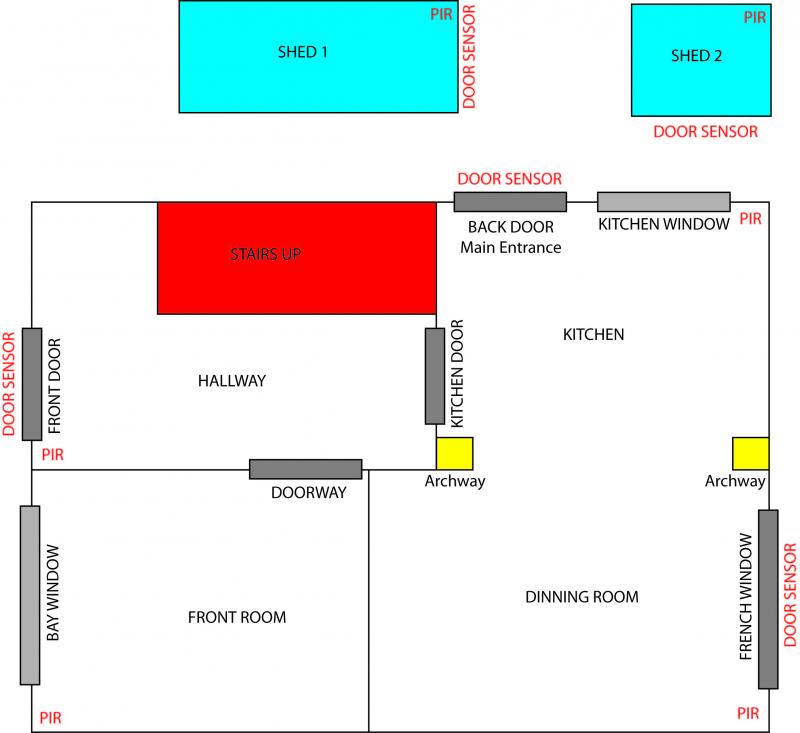

I have added a image of what I suggest anyway for anyone else to comment before I start.
There is already a huge light over the sheds curtsey of the electricity board, we are next to a sub station! It is on all night, every night. So security lights would make any diference.
Anyone who has the time, and could offer advice, many thanks.

Hi Sydney.
Your solution is reasonably ok except you have specified door contacts on your sheds. Sheds can mean anything from wooden larch lap to precast concrete.
even if the doors were secured could access be made through a window. Would a PIR be better. In which case you would need to fill any cracks with expanding foam to prevent birds and large winged insects. You would also need to dust down for spiders.
As for your children coming downstairs. Unfortunately unless you put window contacts on every window then you can't zone the home without creating a security problem.
I personally prefer to set the whole of downstairs active with usually the hall pir as an entry device so that coming downstairs triggers the panels countdown and reminds you to disarm the alarm.

Hi Guys, many thanks for the info:
Yaleguy - the shed are wooden but very robust and the doors are a nice tight fit. From other info received I am going to put just door sensors of these sheds as neither one has any windows. I can always at a later date but PIRS if we see it as a problem.
I will be putting door contacts on all the external doors, but that only leaves one window in the kitchen that can be opened. The bay window has only 2 very small half pane opening windows at the top, so that should be fine.
One major concern is to protect the shed and allow the children to move around the house easily, so I will be putting all these on one zone for night use. The children are step children and only live with us one week on week. I can't see how else I can do it, without limiting their movement.

Put a shock sensor on the windows where the children can walk about. Not ideal but then they can walk about and you have some protectoin as a contact may not trigger if the glass is removed.
You could also use shocks on the sheds too, thus avoiding possible false alarms with pirs.
As for chime, if it is a decent panel ( DIY or not) you can generally have any circuit/device programmed as chime. Can get on your nerves but it is possible.

I missed that question. However although this thread is old here is a tip for all Yale alarm installers.
The way to protect your sheds at night while allowing movement around the house is to designate sensors you wish to be opted out of the setting as Home Arm sensors. When you programme the devices select the 'O' option for Omit. This means when you press the red arm button ALL your sensors will be activated protecting everywhere but if you arm the system using the ORANGE button instead all the sensors you designated with the 'O' parameter will not be active and therefore will not set off the alarm.
This means you can easliy still have the shed protected AND move around the home with perimiter protection afforded by the windo and door contacts but movement possible because you have selected internal pirs as 'Omit' devices. You can be more specific and only omit upstairs pirs in a typical install allowing movement upstairs ie the bathroom and bedroom at night while your dowstairs and sheds still remain protected.
