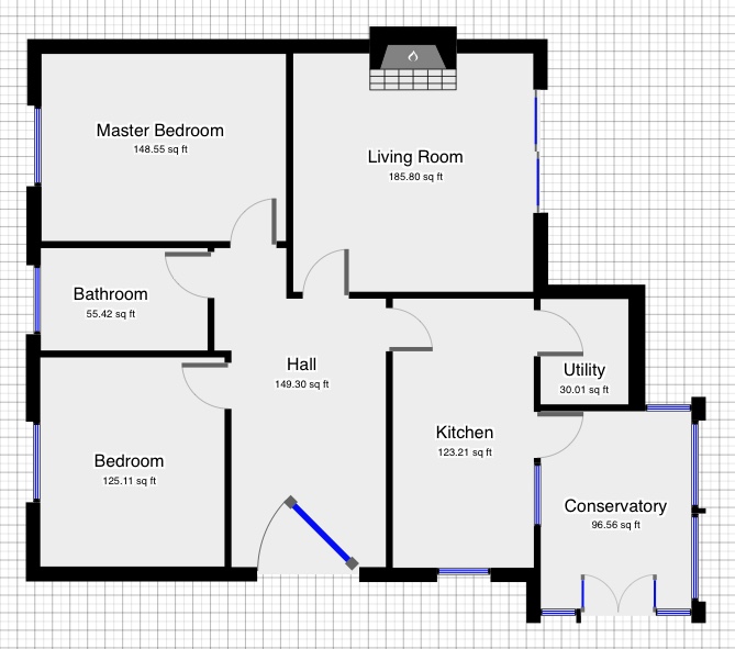

Hi All
I have just purchased a bungalow which doesn't have a alarm. I have purchased a Yale SR-320 Smart Alarm. It comes with 2 PIR and 1 door sensor. I know I need to purchase more door sensors as we have 3 points of entry but would like to know the best place to add the PIR and possibly need to look at purchasing more PIR too.
I would like some help with PIR placement and also any advice on setting up the Yale Smart System.
I have added a plan of the property to help.
Thanks in advance.

Sorry don’t install Yale,
Inadequate cover for the bungalow to be honest.
Pir placement is don’t face windows if you can especially south facing.
Away from drafts and heat sources
Keep wireless devices away from large metal objects.
As for height etc all should be covered in the manuals
