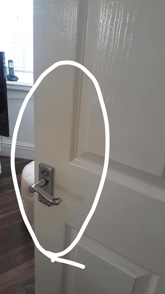

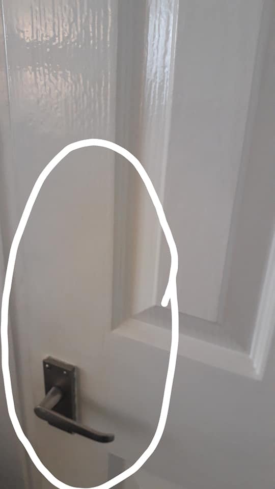

anyone know what causes gloss doors to get yellow patches on, not long been painted either, I noticed it at my parents too on their doors.
johnson's non drip gloss, perhaps it is the cheapest gloss.
Oil based paints will yellow in areas that lack natural sunlight, but the discoloration should be consistent and not patchy.
IMO, non-drip gloss is an abomination. I have never understood how you can expect consistency from a paint you cannot stir. oh, and it ain't non-drip. Apply it too thickly, it will drip.
Are you able to photograph the yellow patches. I appreciate that they might not be obvious if you use a phone's camera.
How big are the patches? If they are dark yellow and about the size of a 50 pence coin, and the doors are timber, they might be bleeding knots
69855909_10220722597797971_2222604039051280384_n.jpg 69240527_10220722597197956_356282079962464256_n.jpgits hard to see on these pic but 2 different doors, I thought if could be off the oil of our hands but its on my mums doors too but futher down... suppose it could be the paint as we have used the same..
Thanks for the photos.
It is definitely not knot related.
I would guess that it is related to the oils on your skin, However, I have never seen that before with oil based paints. That said it has been 30(?) years since I used non-drip gloss,
