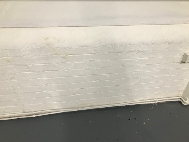

I painted a brick wall white from inside, few days later becoming yellow in patches. It's a solid brick wall no cavity. It's nothing new, same thing happened 20 yeas ago, paint doesn't peel but goes yellow. I checked from outside, bricks are not painted and are sound and dry, no evidence of leaks.
Any sealer I can use to stop the yellowing?
You shouldn't paint solid walls, it traps the moisture in and causes damp. The yellowing is due to the damp in the wall. In olden times, if paint was used on solid walls, chalk whitewash was used on the outside and clay based paint on the inside. Modern paints and peoples obsession to seal walls causes no end of problems.
Houses need to breathe and so do bricks and stone. And never use cement with solid walls, must be lime.

It's a warehouse , it's not too bad and doesn't get much worse. It was painted last time in 1998 and repainted 3 weeks ago, yellow in patches might just leave it , previous tenants didn't make a fuss and hope new ones will not complain.

Paint in 1998 was Wickes white emulsion matt
Paint in March 2022 is Leyland White emulsion contract matt from Selco
As it's 'only' a warehouse, you could apply some white oil-based undercoat to the stains, then emulsion over.
It won't solve the damp problem long term, but it should get rid of the stains for now.
If the stains were there before repainting then they'll always come back through. You need to put some stain block on first or undercoat.
