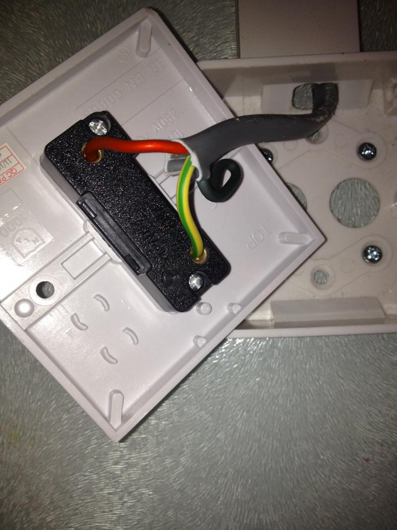

Thought I would share this with you; a friend of mine called me over to his house after he kept getting big and painful electrical shocks of his kitchen sink.
His house is an old house with no RCD's.
It turned out; he had being doing some minor electrical work and his GF had replaced the light switch for him after she asked to help out. It turned out he did not check the switch after she had wired it; and below is what I found.
The switch!
Who on earth would anyone wire the earth wire to L1!
Whats the worst electrical disasters and mistakes have you run into or found?[/b]
I hope you didn't stop investigating there. Unless it's a TT install* then even without a RCD connecting live to earth should blow a fuse or trip a MCB.
* If it IS a TT install then RCD protection needs to be added as a matter of urgency.
Yes it's a TT system with the earth not connected to neutral and no PE wire back to the substation.
Earth (via Earth rod) is also only supplied by a 4mm wire!
Maybe she was trying to tell him something.
But seriously that place needs checking out. That error should have operated the over current device.
As to shocks from the sink. A shock that is severe enough to be painfull requires two points of contact with the body and these must be at different potentials. The sink was one, what was the other ? Maybe the sink was at ground ( earth ) and the other point of contact was live and thus the faulty item.
His house is an electrical nightmare; previous owner had done a lot of electrical work himself.
Earth was likely at a very high impedance and likely thus did not overload the fuse wire in the fuse cartridge. Earth loop impedance varies through out his house.
It is imperative that RCD protection is provided to all circuits ASAP.
a 100mA time delay RCD in the tails should be appropiate, and when other electrical upgrades are done, will discriminate with 30mA rcds fitted downstream (as long as they break the neutral, which a lot of single module RCBOs do not)

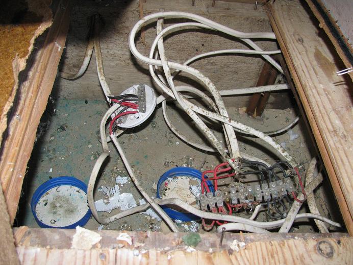

Where to start?
* Found out that the B10 MCB marked "downstairs lights" didn't turn the downstairs lights off. Neither did any of the others. Eventually got them to go out by turning it off in conjunction with the B6 "Extractor fans" MCB. (You can see where this is going...) Removed a blanking plate in the bathroom to reveal a choc block joining the lighting and fan line conductors together...
* B32 > 2.5mm T&E > 13A FCU > underfloor heating
* B32 > 2.5mm T&E > timer > 1mm T&E + 3C&E (wired in parallel) > 13A FCU > immersion heater
* B6 > 4mm T&E > 4x 60W GU10 lamps (Is this what's called a "high power lighting circuit"?)
The real icing on the cake was the upstairs (come downstairs) socket circuit which has a couple of a runs of 2.5mm T&E from a B32 with a few sockets on (one of them with the neutral conductor broken) and also a run of 1mm T&E to a junction box. From that JB came:
- 2.5mm T&E > double socket (there was a d/c flex running behind the plaster and handing out behind a shelf)
- 2.5mm T&E > double socket > single socket > FCU for alarm (why the alarm company connected to this I have no idea)
- 3core flex > 4 way, daisy chained to another 4 way, with a 4 way plugged into that for good measure (located downstairs)
- 2core flex to another room with another 4 way (no CPC)
On a positive note, the JB was "accessible for inspection".
