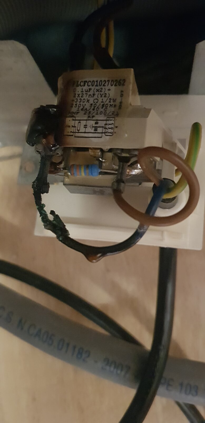

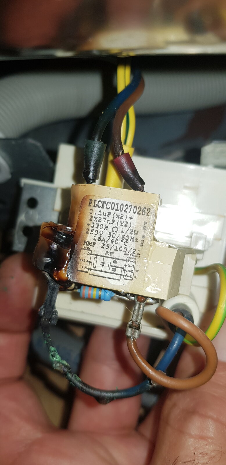

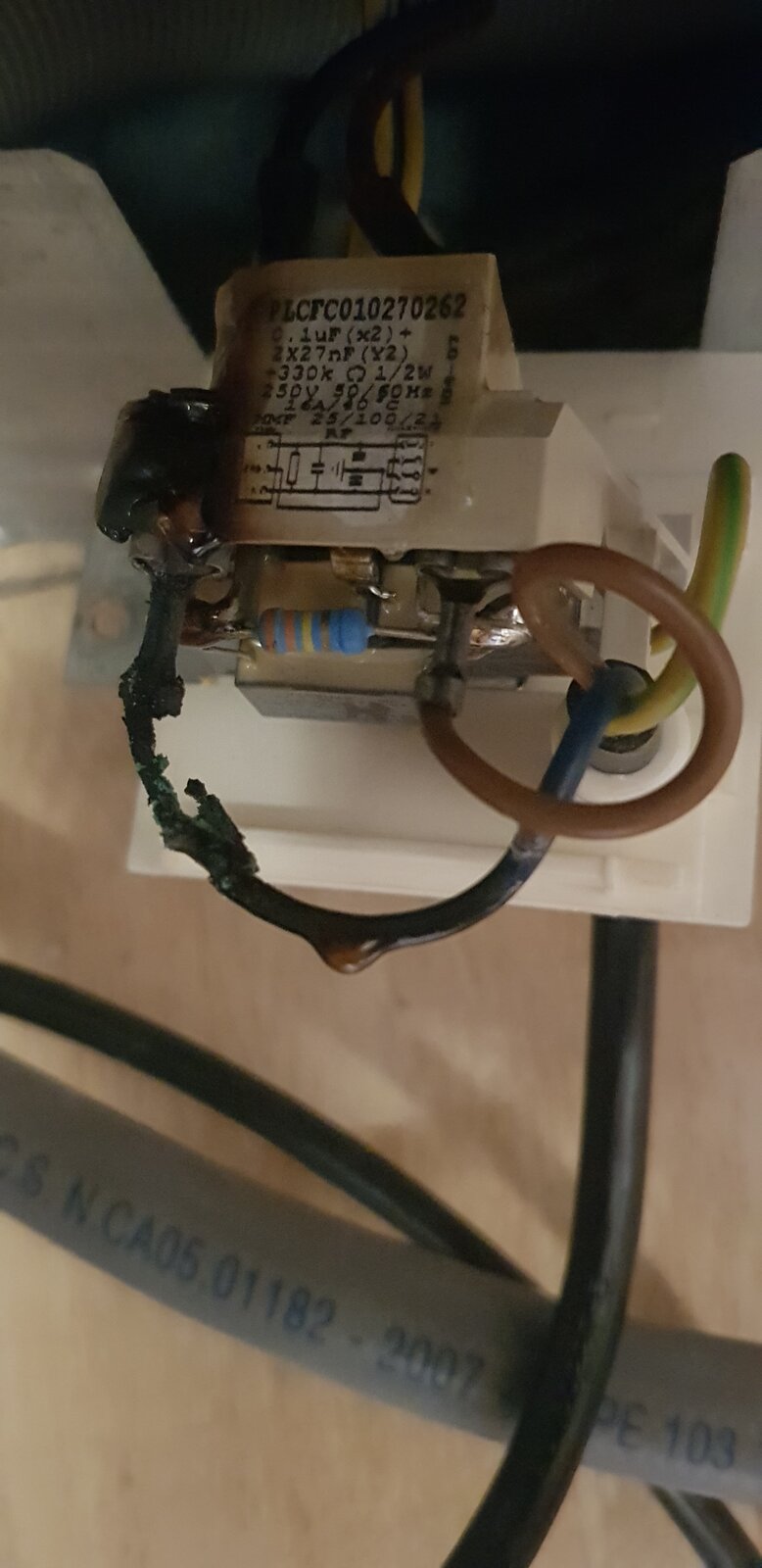

There's a recall on them about the lead cable and internal circuit board attached to it.
Before i knew, i changed it at my son and this is what was there.
Then i found out about the recall: £20 wasted

I removed the panel of the door. I could not see any damage. Would your photos be of a part that would be immediately obvious?
Otherwise where are they located?
Also, how would one respond to the recall?
Yes, once back panel is off, the lead circuit board will be obvious, it's where the lead enters the machine.
Plenti of videos online on how to remove back panel.
